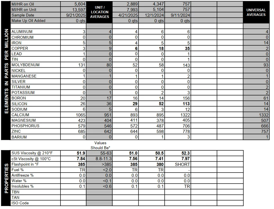

Here you go. The higher initial cSt viscosity of QSFS 5w-30 helped on this longer run. This is probably what I'll stick with throughout the warranty period with 5-6K OCIs.
Ford Maverick Oil Analysis Reports of Low Viscosity, Shearing 1761247786344-7k

Usually low kinematic viscosity in the 2.0 Ecoboost is due to fuel dilution rather than shear. What makes you think it's shear? Keep in mind that Blackstone doesn't measure fuel dilution directly--they extrapolate dilution from kinematic viscosity and flash point.
Crap…Was planning to use Blackstone to measure the fuel dilution in my full synthetic MC 5W-30…because of the fuel dilution TSB affecting my Maverick.
Seems like the Blackstone report will not offer conclusive evidence of fuel dilution even if it exists.
What doesTR in the fuel% section mean?
