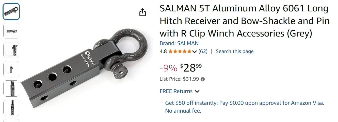

Between the recovery hooks on the front of my Tremor, and 1 of these for the hitch, I hope I'm covered.
HRG
That works. Not a huge fan of hard shackles, they can fail if not used correctly. A soft shackle won't be anywhere near as damaging if it comes loose.
