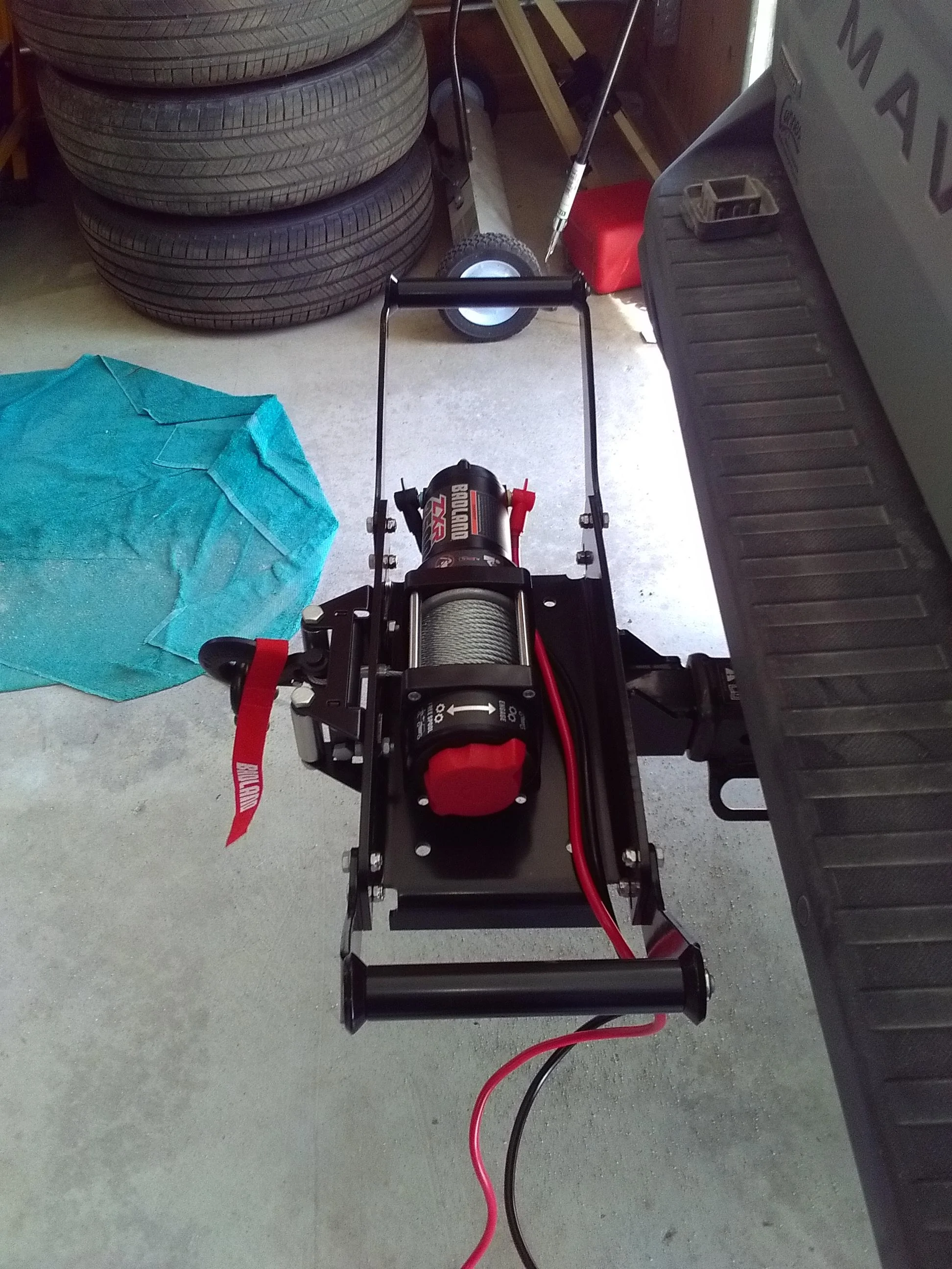

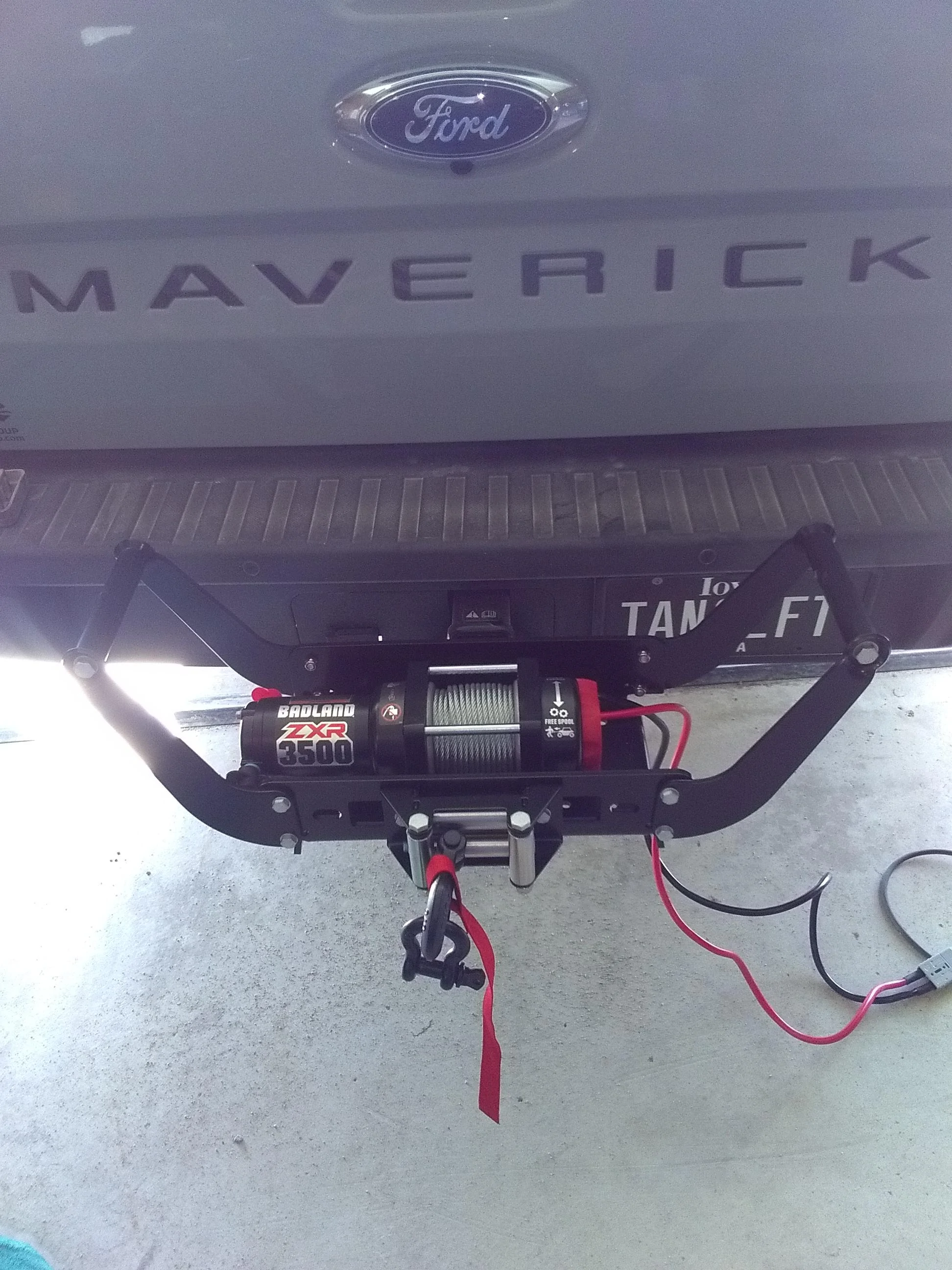

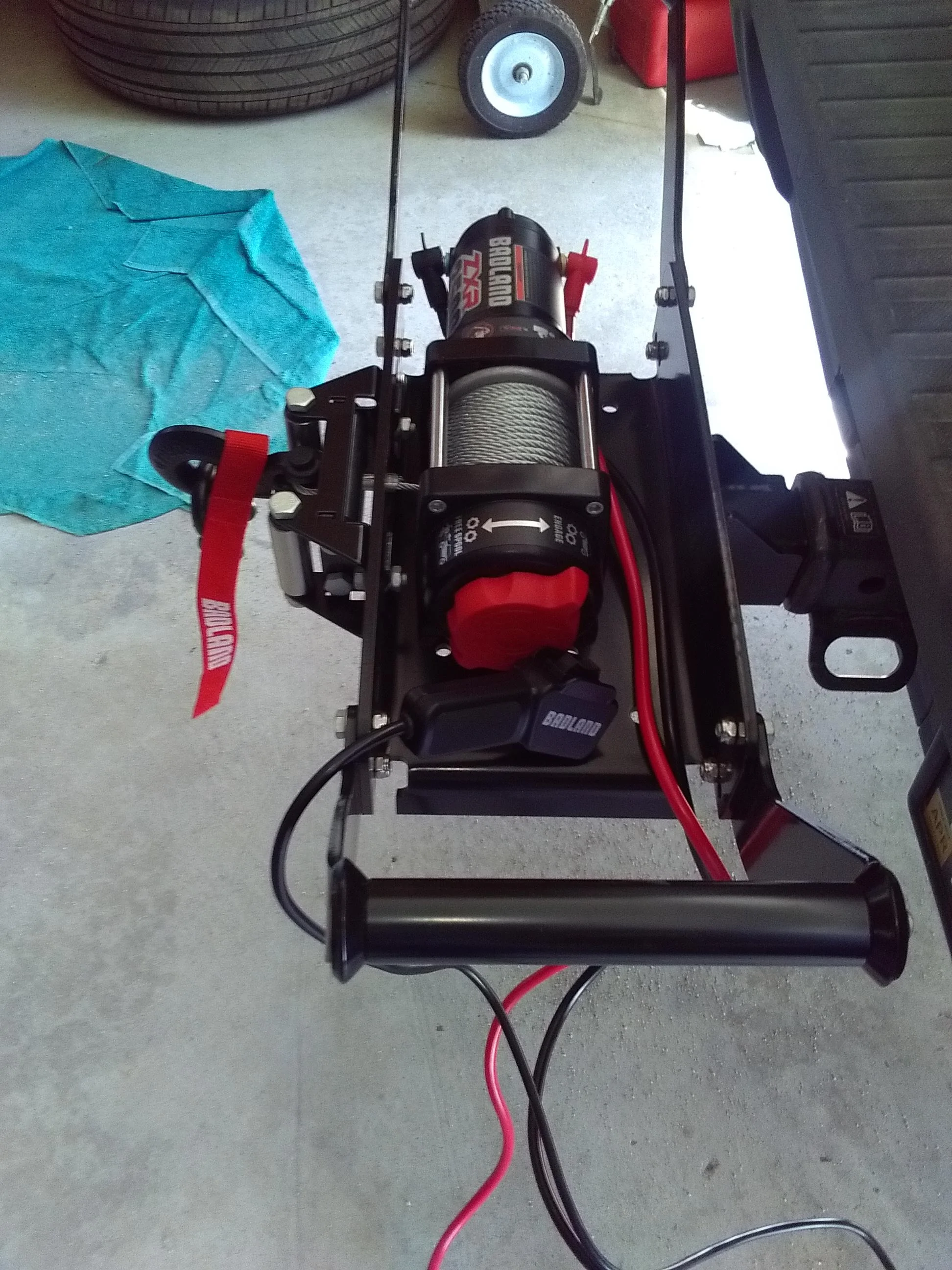

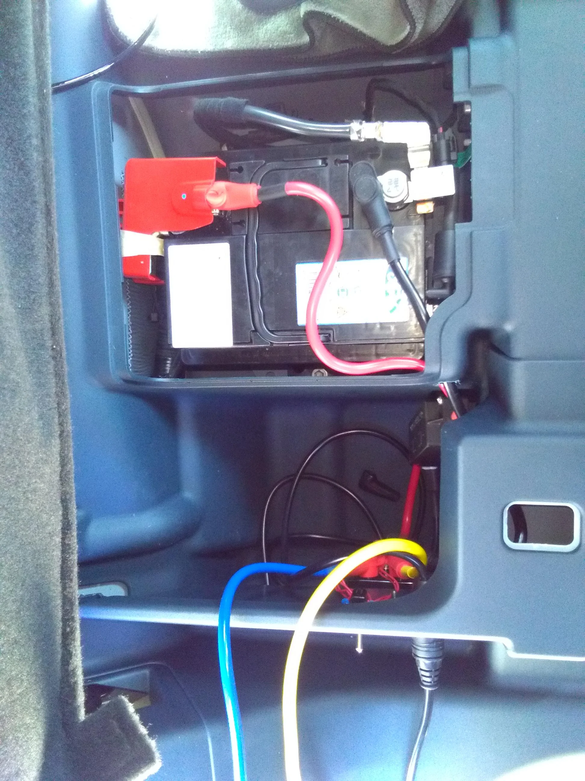

I've needed a small winch to meet the occasional need, so it did not need to be permanently mounted to the truck.
I settled on a 3500lb Badlands brand winch from Harbor Freight, along with the 12,000lb hitch mount. I liked the mount because it's heavy duty and it has handles that make it easy to mount and dis-mount the winch from the hitch. I also picked up a snatch block and tree wrap.

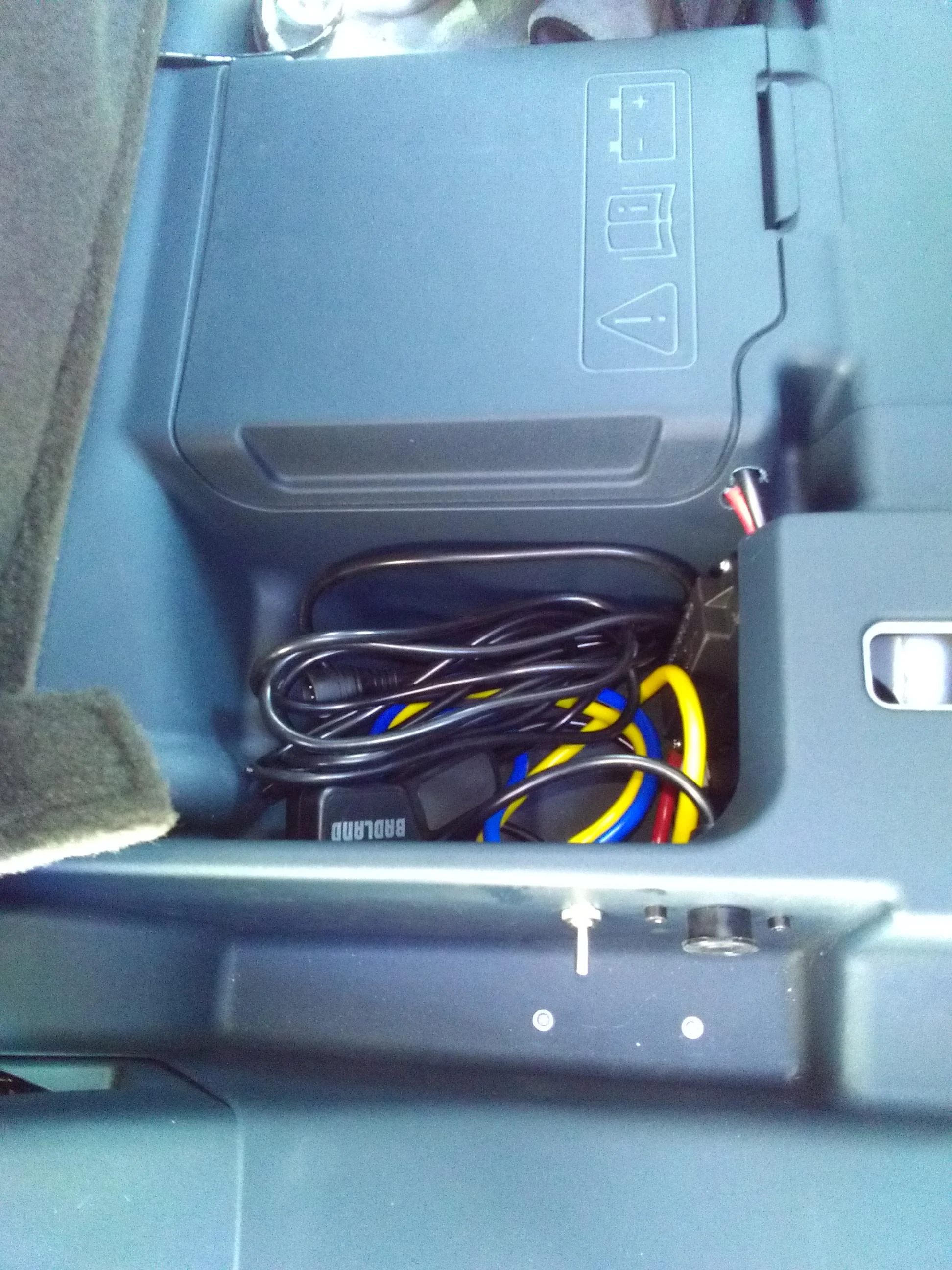

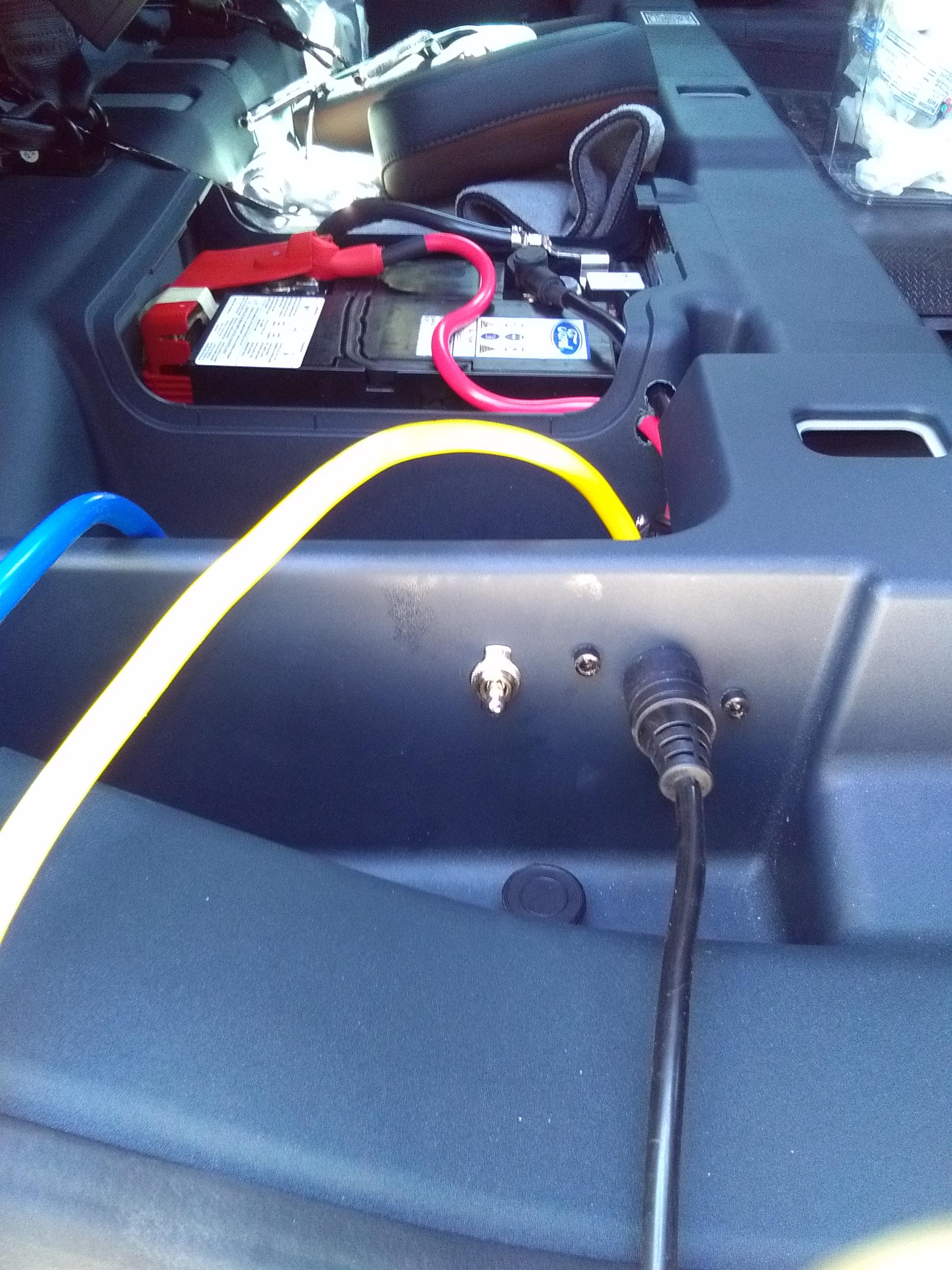

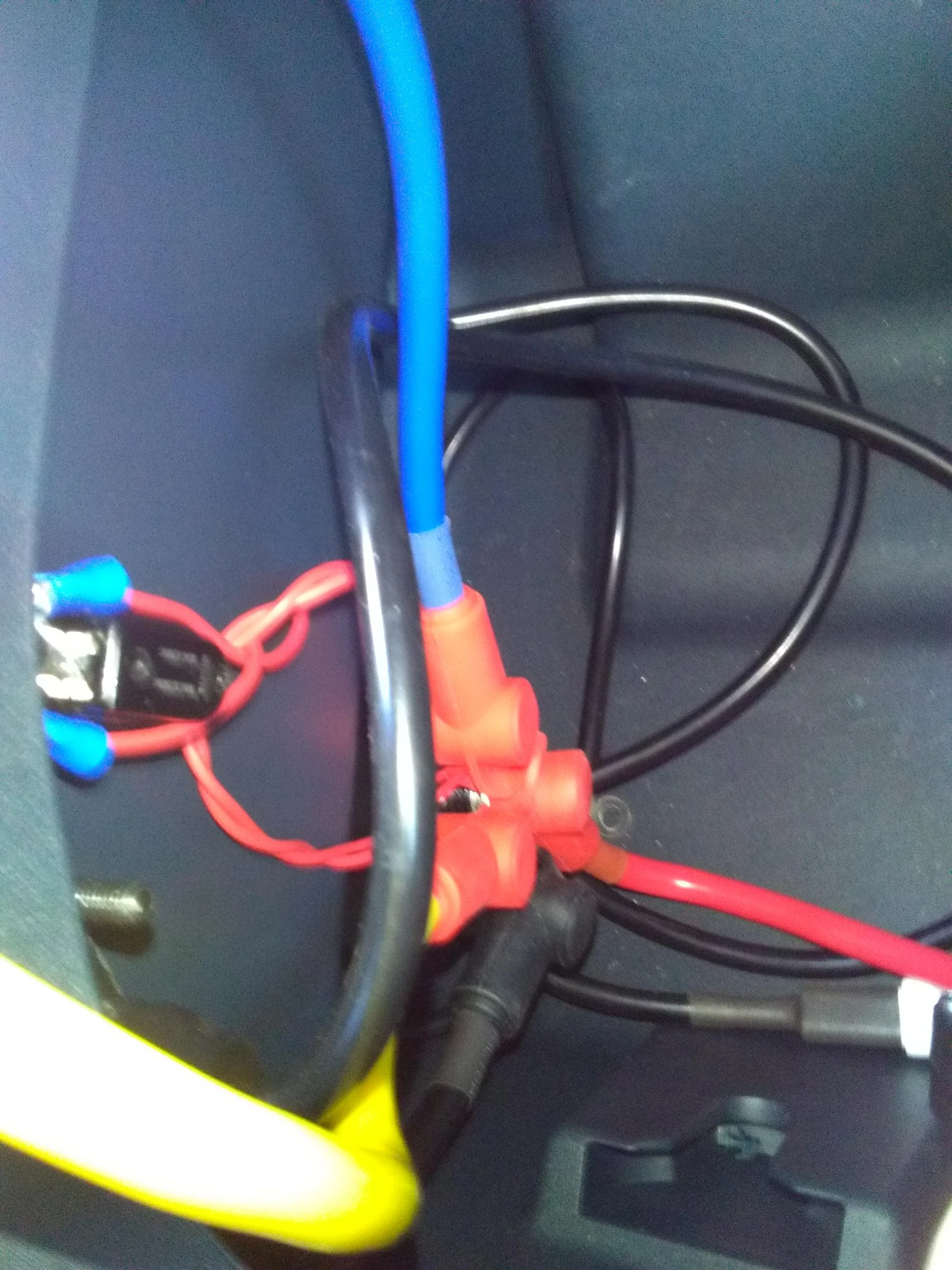

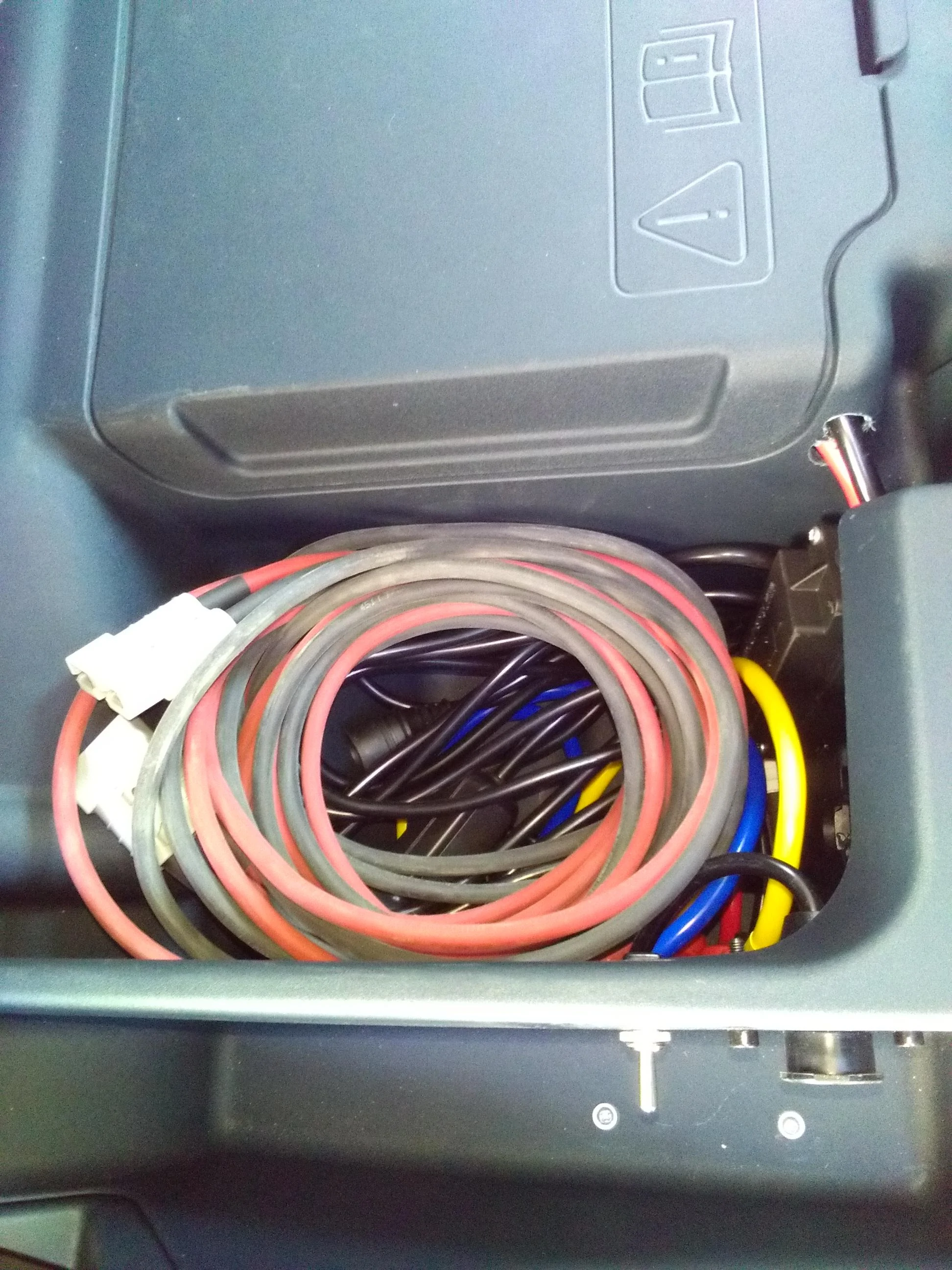

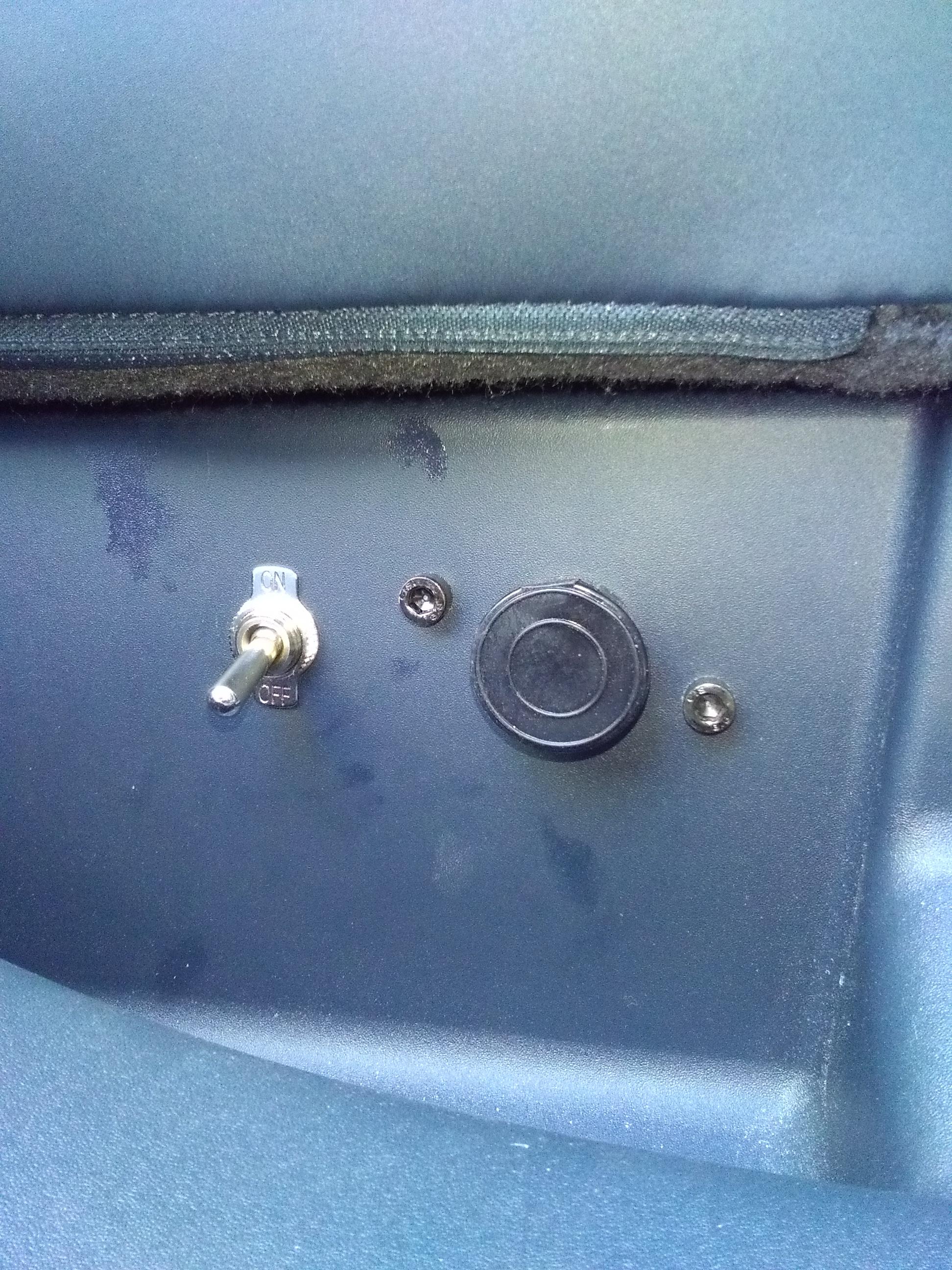

I made use of the storage space next to the 12V battery (it's a hybrid) to mount the solenoid and to store the cables and remote. There is a wire that is supposed to make connection with an ignition accessory but I routed it back to the connection on the solenoid that goes to the battery and put a manual switch between.

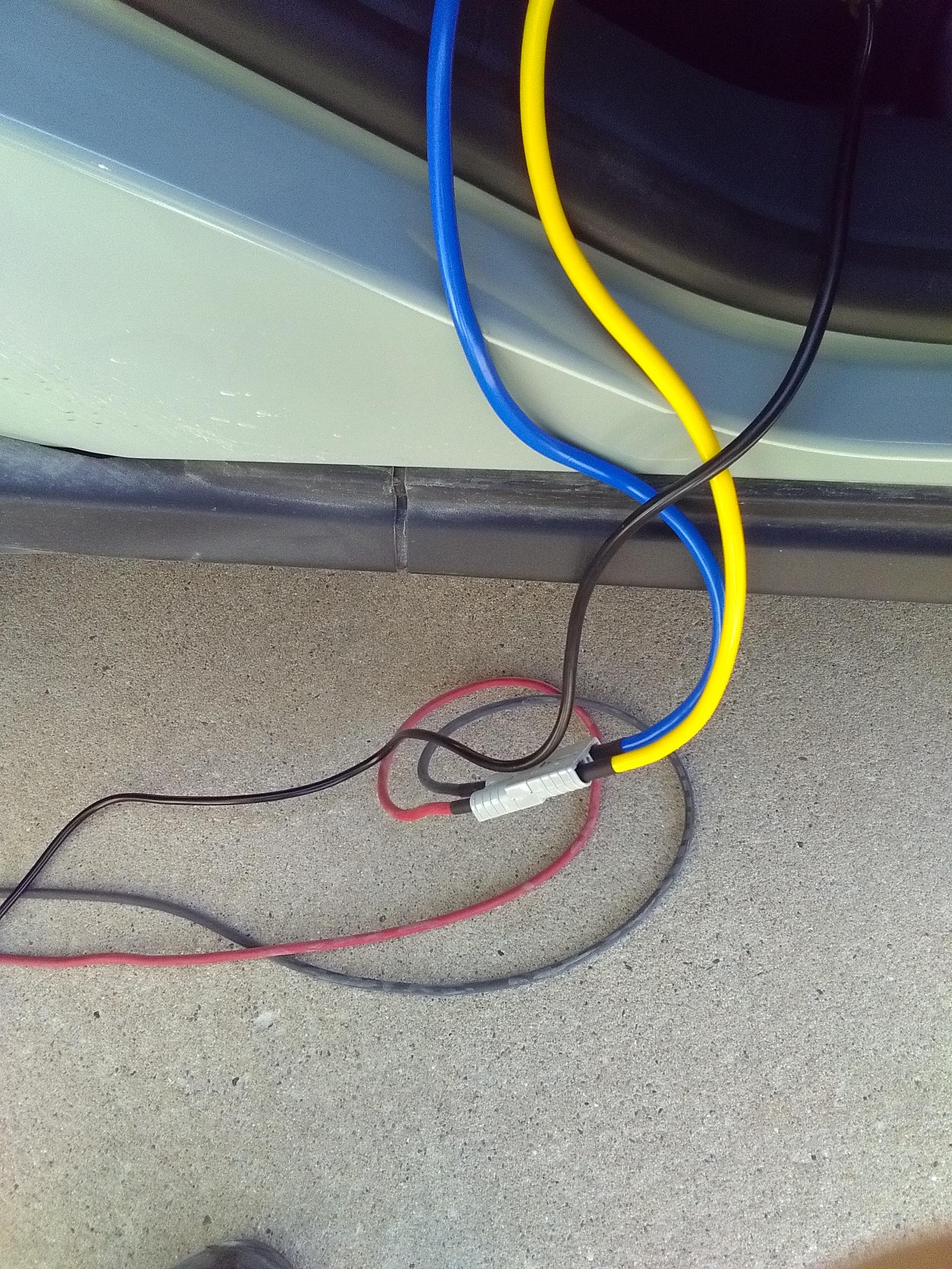

I made heavy duty power cables using 8 gauge wire and 50Amp plugs. I drilled small holes in the lugs that came with the 50Amp connectors to make it easier for soldier to flow into the lug. I used all of the 15 feet of wire to make the extension cable.
I am using the same setup to run my Larin hitch lift. There I need to use two remotes, one that came with the winch to energize the solenoid on the lift (like an on/off switch) and then the remote that came with the lift to go up and down. I also got a Roadmaster hitch adapter to lower the hitch so the Larin lift would not hit the tailgate.

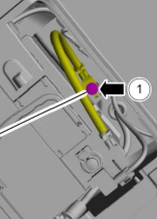

Nice install. I guess the one thing different I'd do is not connect to the battery negative. I'd run it to the same place the negative BMS cable goes to next to the battery.
Ford Maverick Installed a hitch mounted winch Hybrid 12V Battery Chassis Ground
The 2022-2023_Maverick_Hybrid_Modifier_Guide_10-25-22 does say "Ground accessories to the chassis or the vehicle battery".
The 2.0L service manual does say: "any electrical devices or equipment must be grounded to the chassis ground and not the negative battery terminal."

Interesting setup, and overall nice and clean looking. I do have a little concern about the gauge and length of the main cables, But that is coming from my experience with the 12,000 Badlands. I have overheated the factory cables at less than full load. So I upgraded to zero gauge from the battery. I dont know if the 3500 needs that but 8 gauge may not be enough at that length. Another option for cables is a good heavy premium set of jumper cables.
Anyway you setup is nice. As with any winch I would always test it before you rely on it. Maybe find a small hill or a curb to pull it up and over. I recommend always using the snatch block as a winches rating is for free rolling weight, not stuck weight. The snatch block will buy you the extra power needed for an actual recovery that traction control couldnt handle.

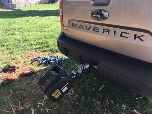

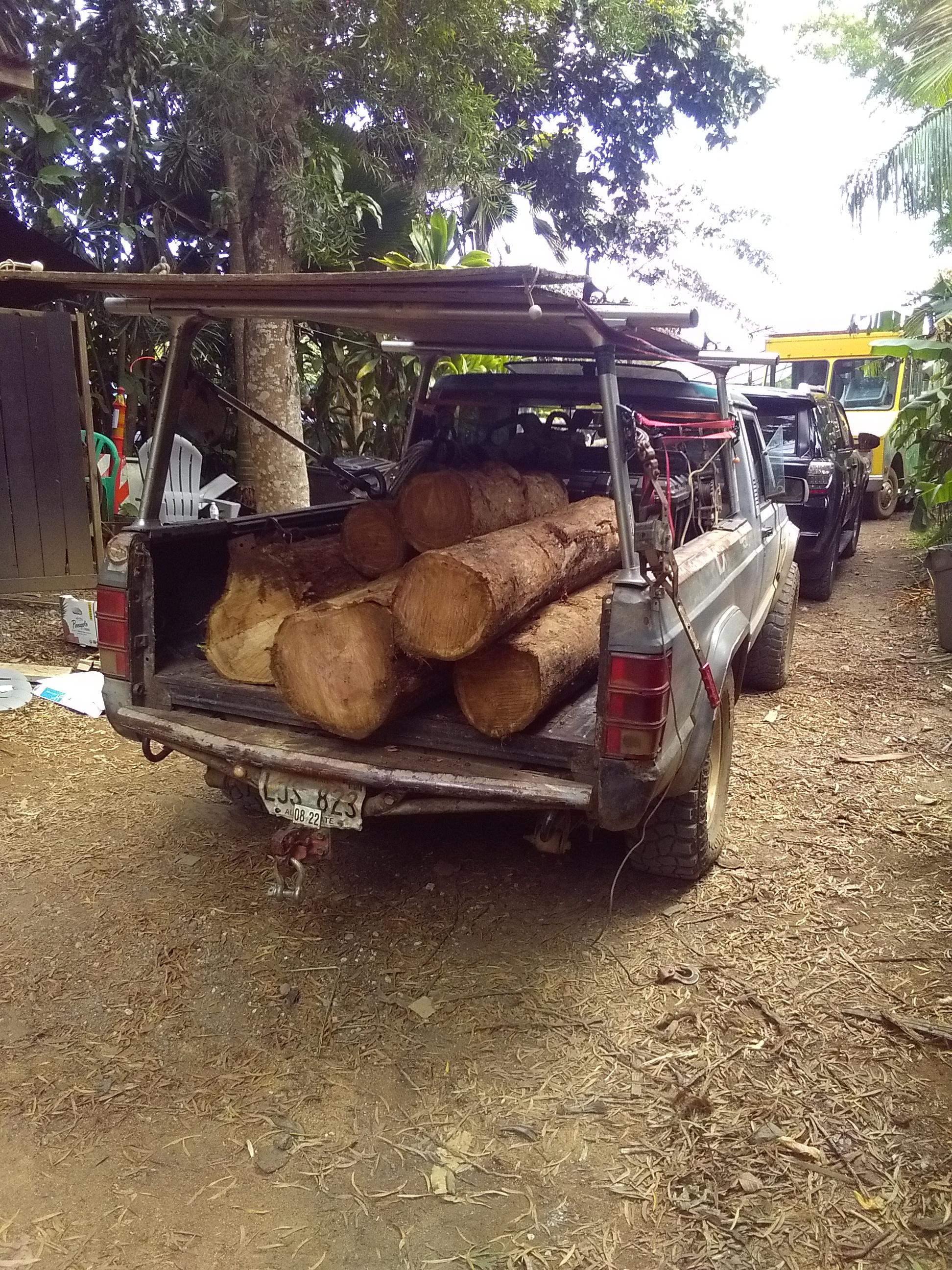

I bought a portable hitch-mounted 2000LB winches to move some 275-pound logs up a steep hill.

All pulled out of the jungle by the truck and loader by hand. Except for the big one that I had to pull into the bed with the come-a-long. My everything hurts. I cut these and several more like them in 19 benches at work with a EGO battery chainsaw.
