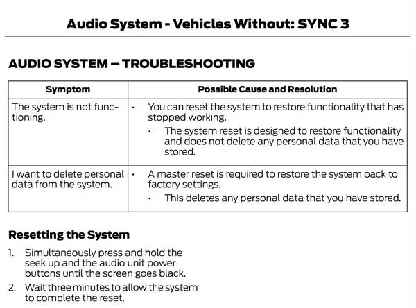

Also can do a reset -
Ford Maverick USB issue audio

My XLT does this every once and a while. The only thing that is ever plugged into it is an iPhone via its cable. It shouldn't show that message if there is nothing connected. Sounds like your system is hung up; recommend doing a reset per @PeteBerner's suggestion.
The reset is a good first try at resolving this. I have gotten the message myself, but only when a device is plugged in, or when plugged in and then removed... With my iPhone, simply connecting/reconnecting the cable is not enough to stop the message; it takes an ignition on/off cycle.
