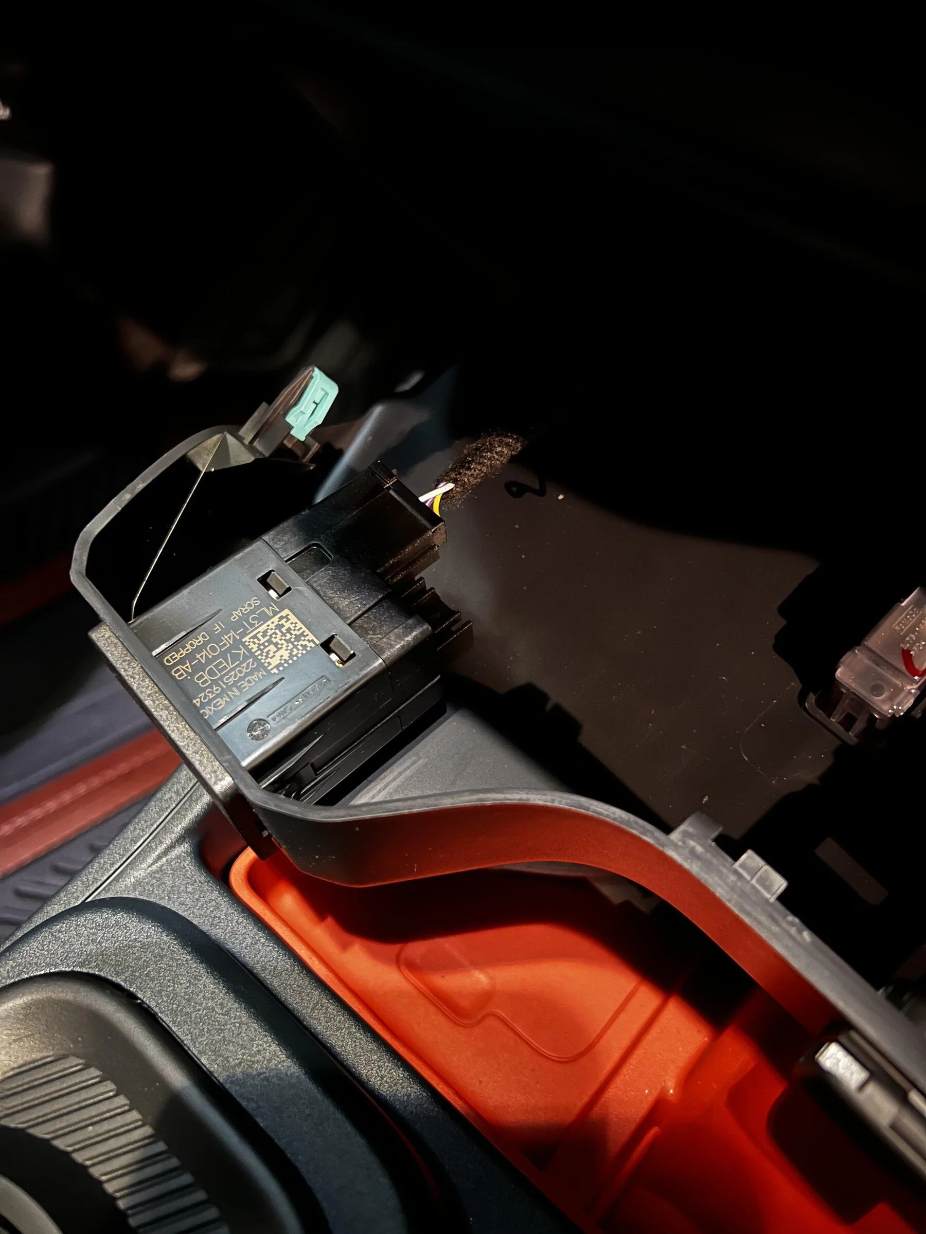

I took mine in for this problem yesterday afternoon in addition to the infamous hybrid TSB. I thought that the software would be at most a two hour job and this would simply involve pulling the trim out as shown in the pic above but apparently they needed today as well... I just hope that 1) they keep this under warranty (I explicitly stated that I expect it to be and if for whatever reason you believe that it should not be, stop and I will take it back to find a dealer that would) and 2) they actually do it today. I had an appointment, so we shall see... I miss my truck already :(

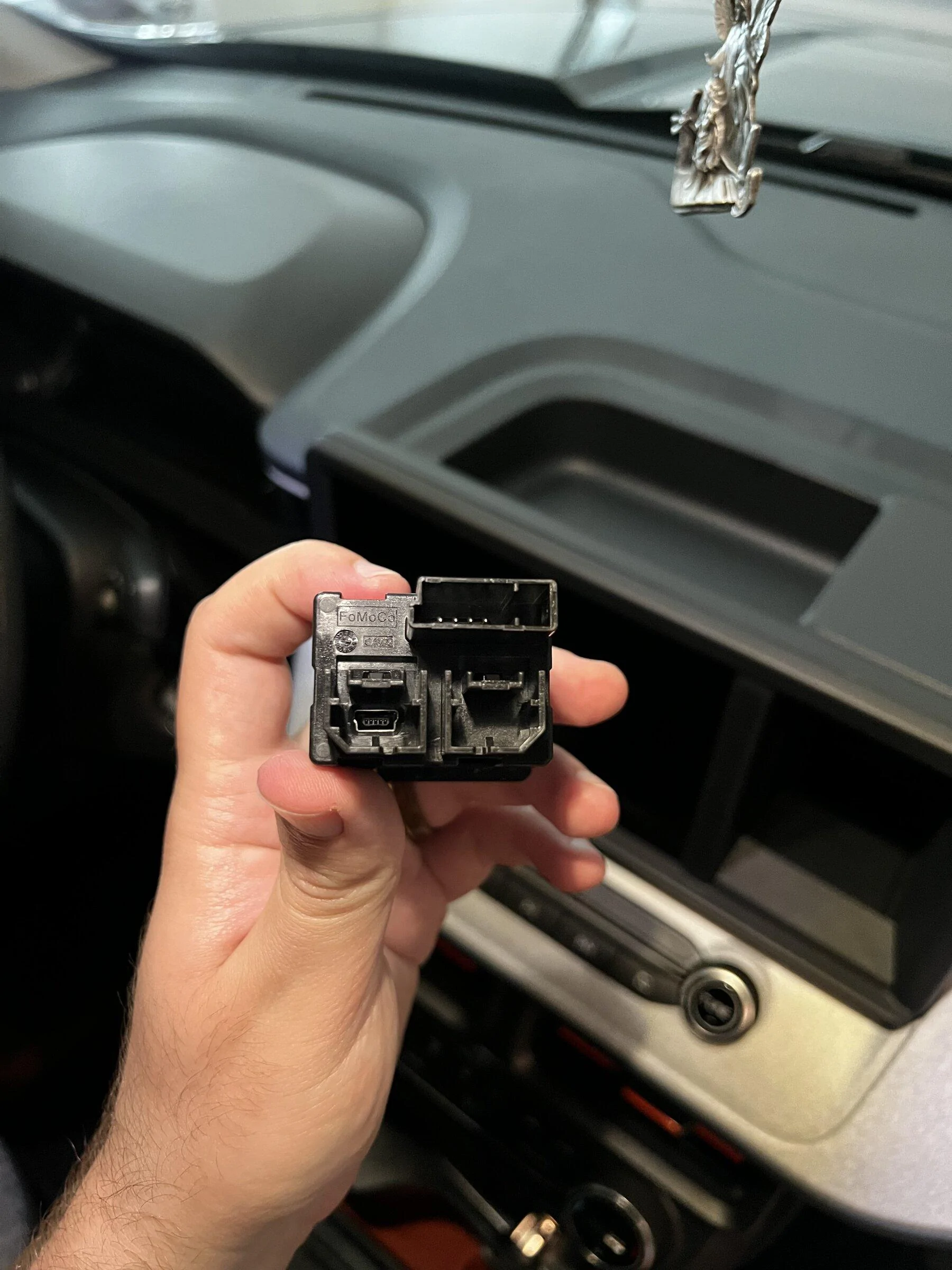

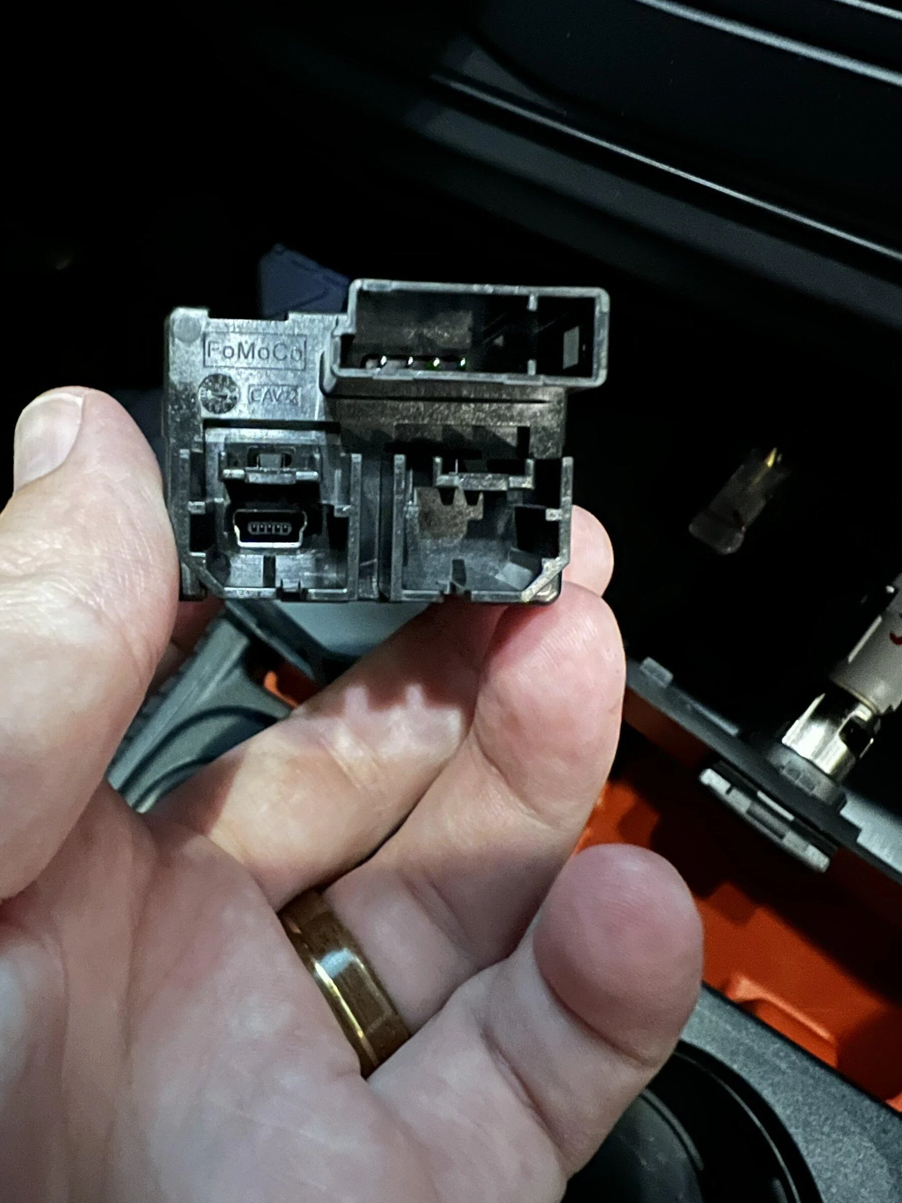

Since I had a minute I went out to my truck to troubleshoot. I pulled the interior interface panel (the blue plastic surrounding the ports) and confirmed that I am indeed completely missing the cable necessary. It looks like the part number that I need is NZ6T-14D202-AA from another user’s picture of that area but I can’t find it anywhere on google. Does anyone have the ability to browse parts on an official ford system?
Pictures I took for reference; I hope they help someone:

EDIT: I think this is it and it is indeed on back order
https://parts.ford.com/shop/en/us/e...es/cable-assembly-14200213-1#/modalAddVehicle

Thanks for the pictures and info. I have the same issue but haven't bothered taking to the dealer yet. Even if I had this part, I don't think I'd be able to plug it into the ACIM without further disassembly. I think I'll go through the dealer to get this done.
