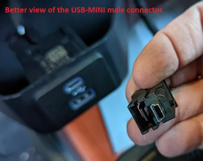

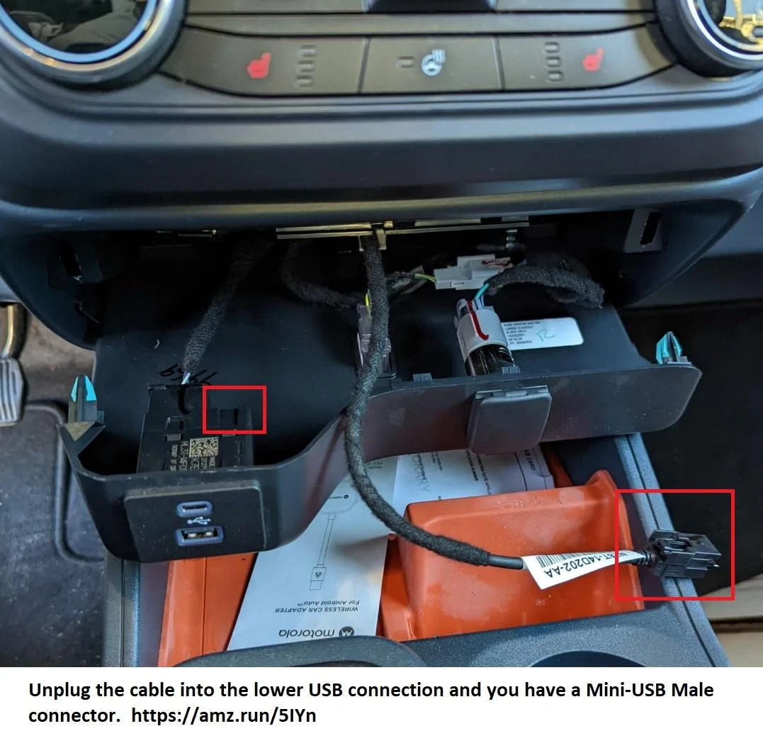

I got it to work with this cable:
https://www.ebay.com/itm/391346062477
I think this is the same cable and seller for $1 more and faster shipping:
This is the only short mini-to-mini cable I could find. The rubber plugs are too tall and fat to physically fit into the slots in the Maverick, so I sanded them down just a little bit and they have a nice snug fit now. It doesn't take much sanding at all to get it there. Pictures:
Ford Maverick USB infotainment oops IMG_1267
Ford Maverick USB infotainment oops IMG_1268
Ford Maverick USB infotainment oops IMG_1269
Ford Maverick USB infotainment oops IMG_1270
The 1 ft length is perfect and both of the panels (USB and AC control) clipped back in easily. I tested it with Apple Carplay on my iPhone 8 for an hour and it worked as expected--music, navigation, calls, etc. It also charges the iPhone. I was using the big USB-A plug. Haven't tried USB-C yet but I will report back when I do.
Once the Ford part isn't backordered, I'll remove the cable before my next oil change and take it in for a proper replacement. But this will do for now.
Thank you @BB0 for the helpful info and pointing me to the pictures showing what/where the other end of the plug was!
Fantastic!!! I will likely be getting one very similar to this shortly but sadly have not had the opportunity just yet. I appreciate you posting your success here and I’m happy for you that it’s now working!
