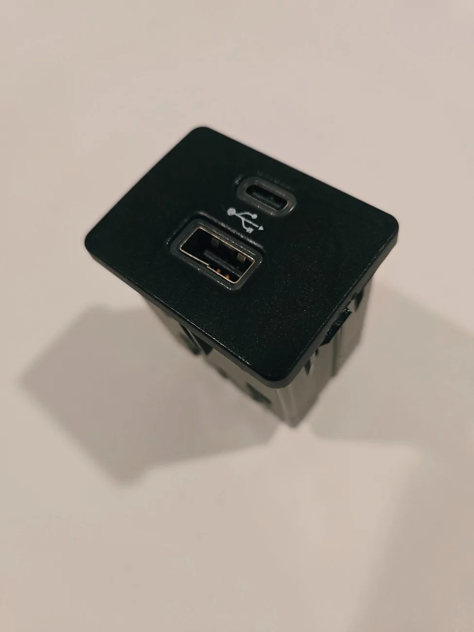

How do you remove that from the panel?
Do you have to drop the panel to depress the tabs, or can you just pull it out from the front?
Thanks
Push on both sides at the same time with flat trim removal tool, if you push one side it will pop back in most of the time when pushing the other side.

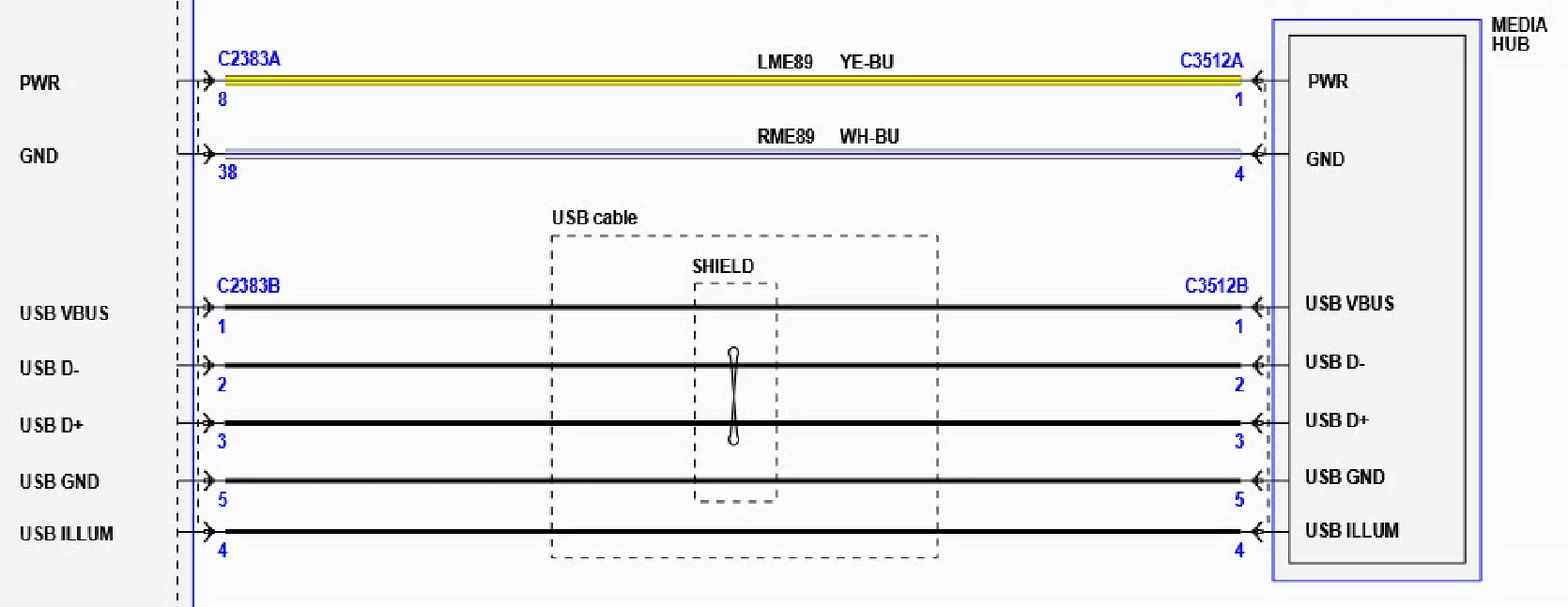

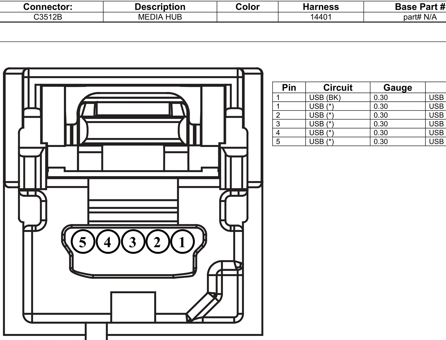

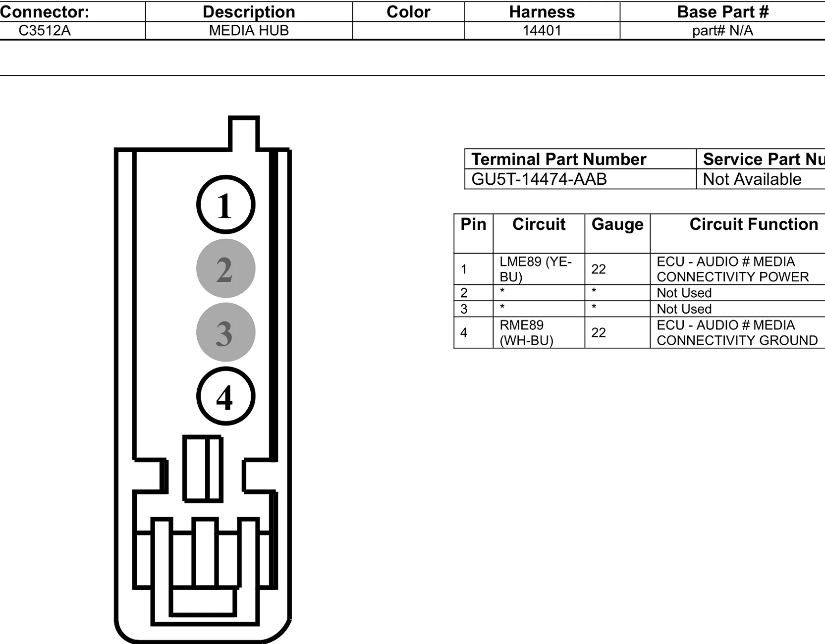

My front USB ports recently stopped working, no charge or connection (accent lights around ports also not lighting up). Does anyone know the fuse location and # for the front USB ports? I am getting conflicting info elsewhere online and the user manual isn't helpful ether unfortunately. I want to check the fuse first before ordering a replacement port hub. Thanks!

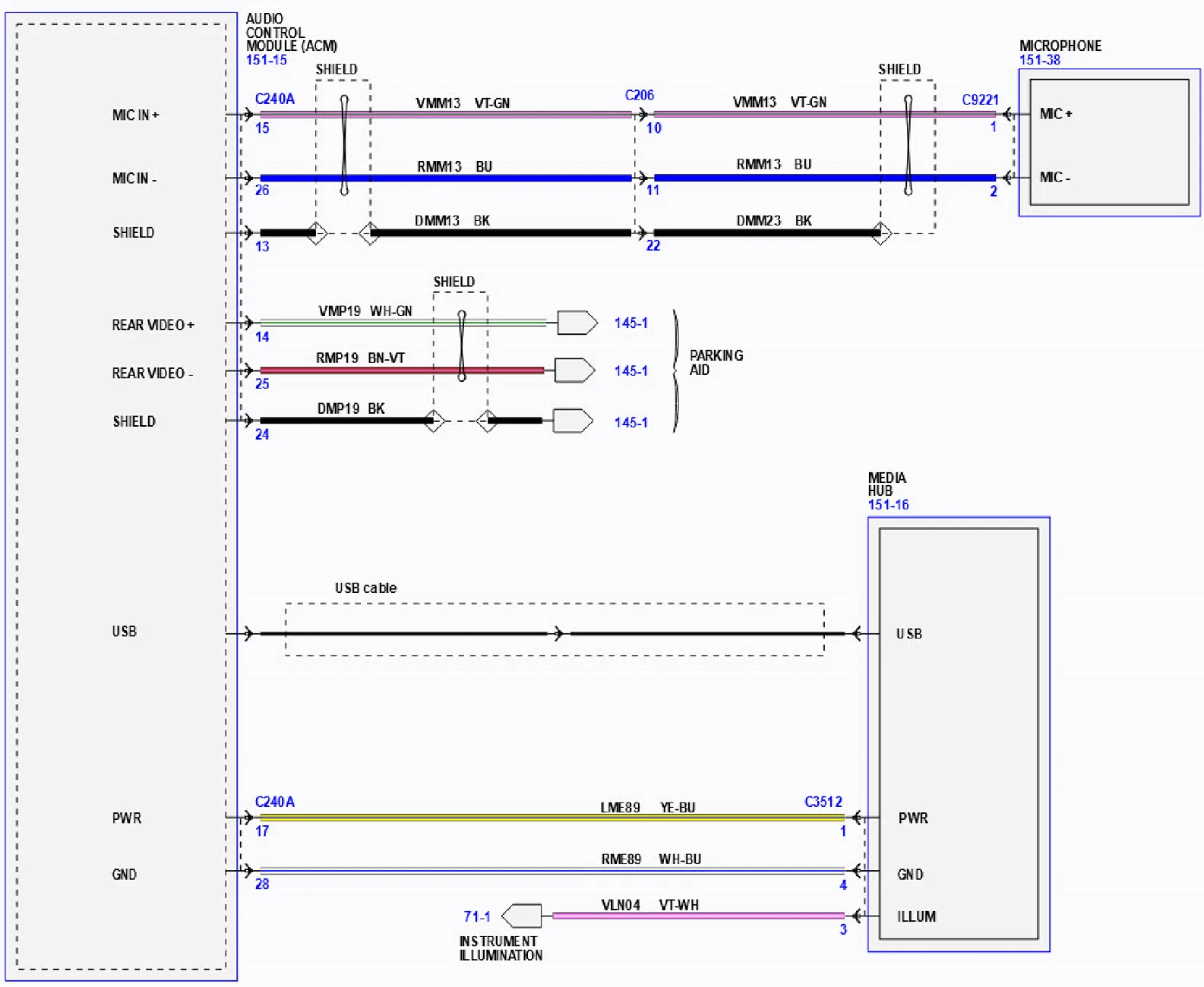

Media Hub may be getting power from the ACM.
