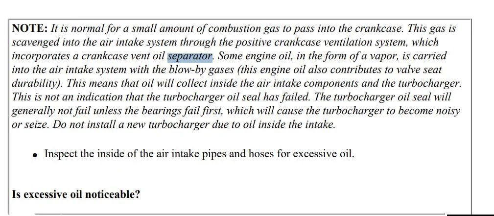

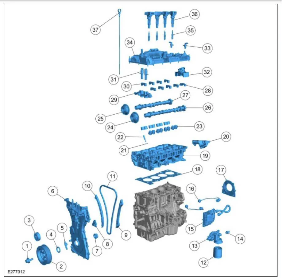

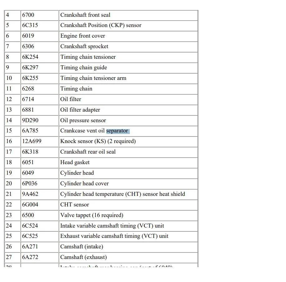

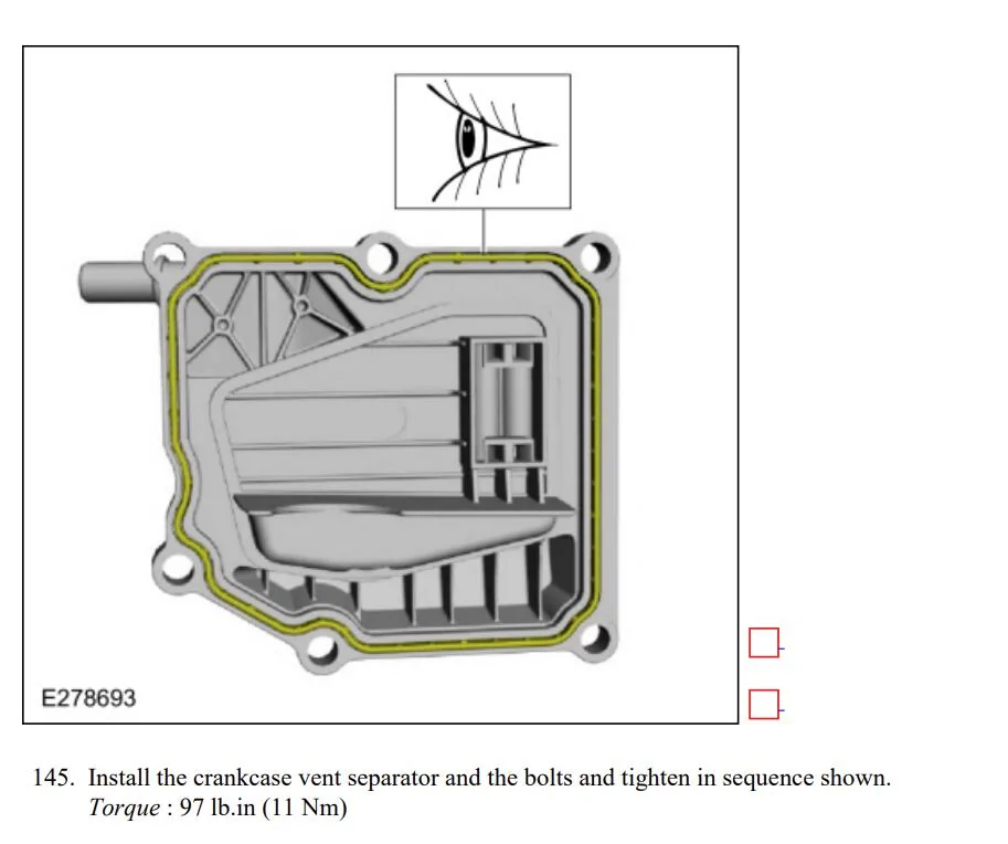

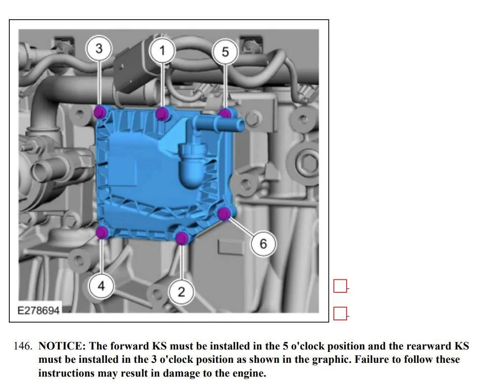

All 2022-2024 2.0l Mavericks come standard with a crankcase vent oil separator or more commonly known as a catch can.
Here is some information from the service manual about its location.
