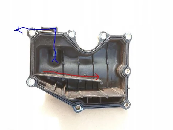

Here is a photo of the internals of a typical Ford oil separator. Blue is travel of vapor through the PCV valve at the top, and red is the travel of oil (gravity separated) back into the crankcase. That blue line goes to the input of the catch can. The idea behind the separator is that fluids will drop out through the baffles under gravity and flow back into the crankcase, but that solution is not ideal. A catch can further separates fluid and particles that the oil separator passed.

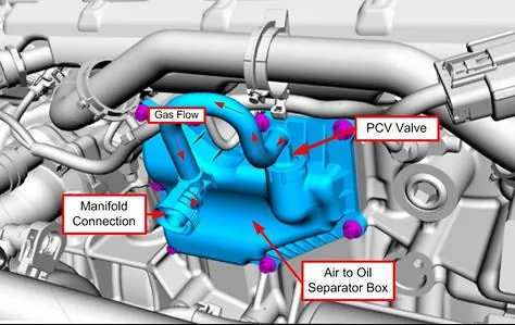

Here is an external diagram from a manual showing the mounted oil separator and direction of travel of gasses. Note that gasses flow only out of the PCV and into the manifold. Oil is trapped by the baffles in the oil separator and drain back into the crankcase as the gasses leave the PCV valve. The catch can goes between the output of the PCV valve and the manifold connection, replacing the tube labelled "gas flow" in the diagram.
