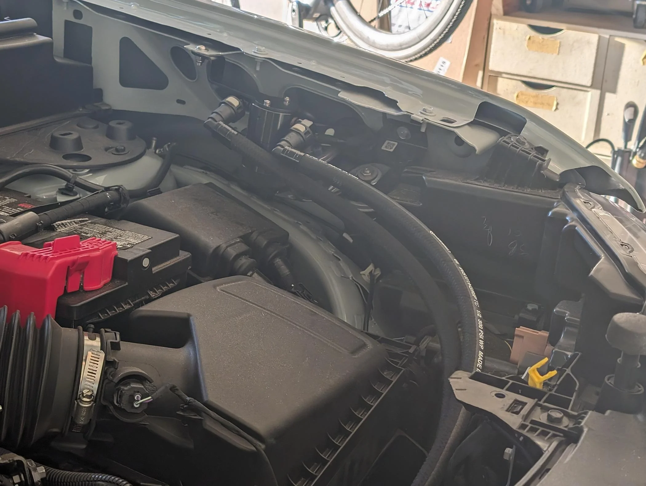

Did mine as well, opted for the larger diameter hoses.
Ford Maverick UPR Billet Catch Can for Ford Maverick 1000004932
