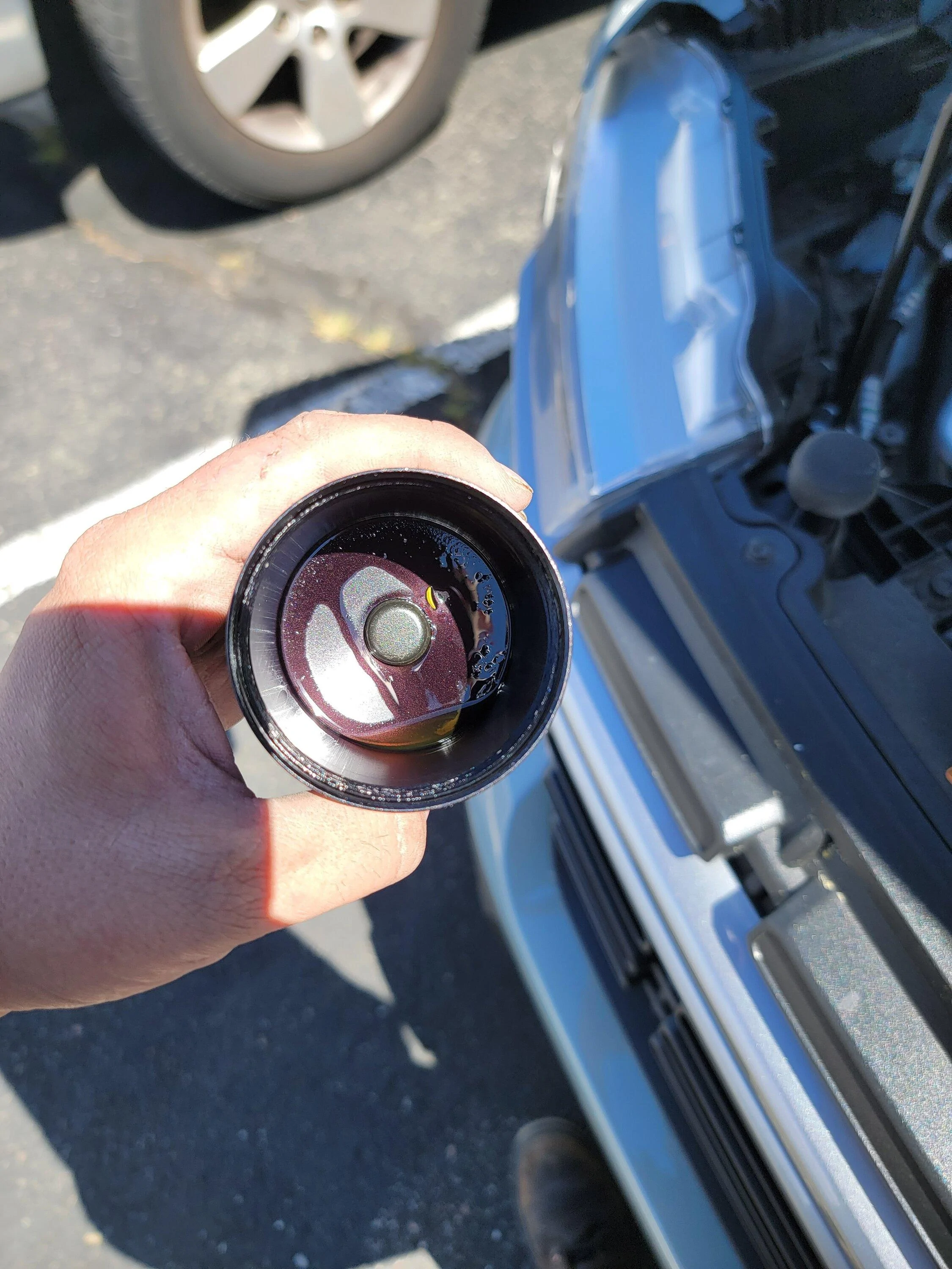

Yes I love it! I do empty it every 5,000 and it catches a decent amount of fluid (3-5 table spoons). I've put 22,000 miles on my truck and have noticed that road trips cause more fluid in the catch can. If you are gonna install a catch can, it might be easier and cheaper to buy a kit made for the Maverick. I know Boomba Racing makes a catch can for both the clean and dirty side. Good luck!

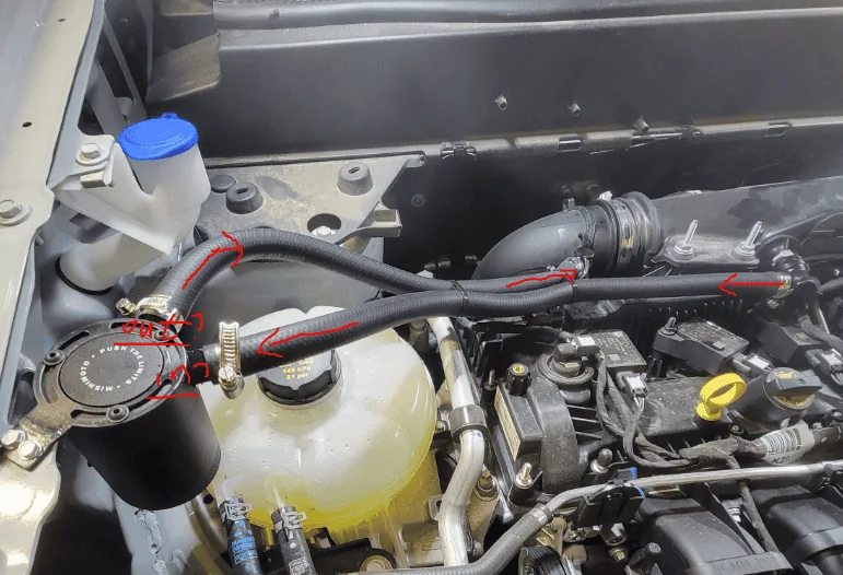

Hi OP, I am planning to install the same can but I am bit confused.
The Mishimoto catch can has a "in" side and "out" side, can you help me understand which side is connected to which? Thanks!
See my illustration below.
Or it should be the other way around with the arrows and in/out?
Ford Maverick Catch Can Installed! 1704745466715

@Desert Trek
It will be the reverse of your drawing.
