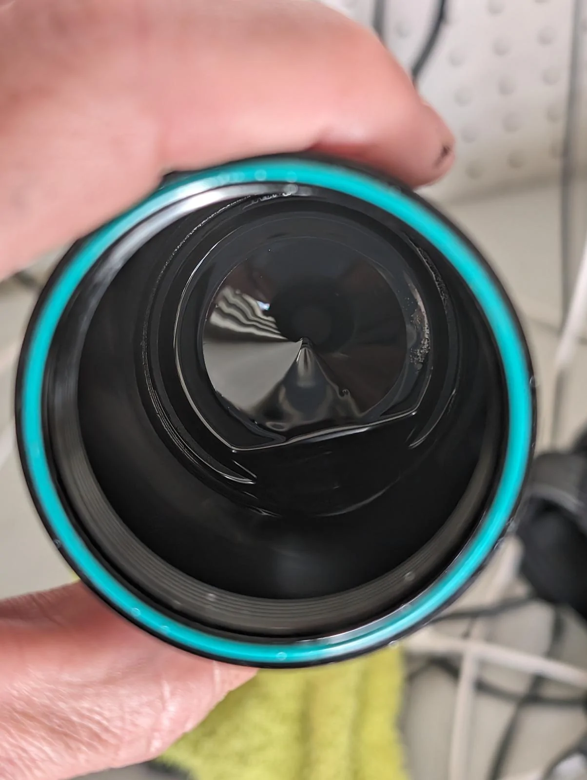

Got me a little worried, so I checked mine.
After about 1500 miles

I think there was only 1 guy who said his can was nearly full after 500 miles (mostly water). I just had a very small amount of oily fluid after 1500 miles in mine.
