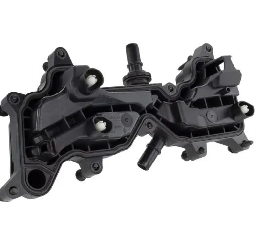

As for a catch can - the new oil separator in the Maverick is a marvel of engineering design with its baffles & chambers. I’m all for replacing a restrictive exhaust system but would leave the fancy oil separator OEM!
Pictures of 2025 EB Oil Separator:
Ford Maverick Catch Cans for 2025 Ford Maverick 2.0L Ecoboost IMG_9604
Ford Maverick Catch Cans for 2025 Ford Maverick 2.0L Ecoboost IMG_9603

The 2025 OEM oil separator is a new design & you might be smelling a problem in its functionality? Maybe we’ll see a TSB down the road…
