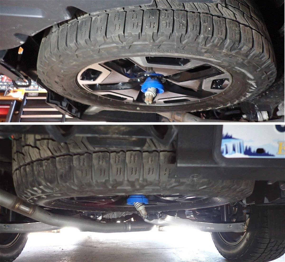

Took off the doughnut spare yesterday. Got a spare matching Bronco Sport wheel and a new set of Falken Wildpeaks for the Mav. Put one of my used Falken 235/60/R18 tires on the 18" wheel. No problem fitting it up there. Didn't reduce ground clearance.

would a full size alloy wheel fit in the spare wheel area with full original size tire? would the tread touch the exhaust pipe?
MakinDoForNow
Sep 24, 2021
8,465
6,029
If you have the OEM trailer hitch which is welded to the crash bar you have 3/16"-1/4" less room for the spare.

very good to know. I do have the factory trailer hitch. the question still stands if anyone happens to know, especially given this additional knowledge of the reduction in size due to the hitch.

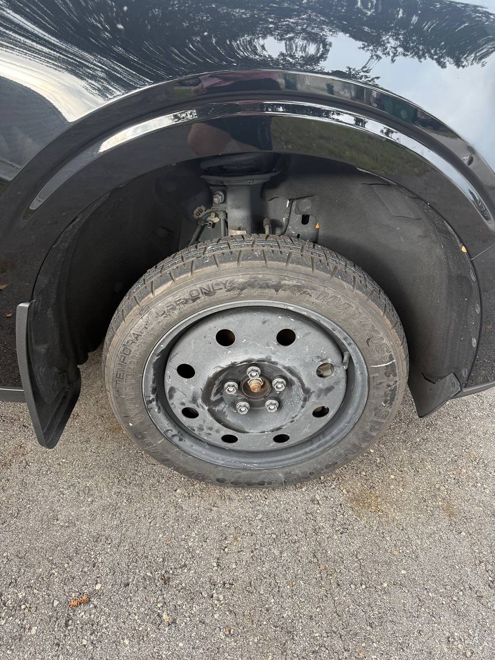

Yeah, I paid the $115 extra for the"fullsize" spare when I ordered my XLT hybrid. It's not even the same size or brand as the 4 Continentals on the ground. The Door sticker even shows that it's a smaller tire. Big misrepresentation by Ford by not disclosing that when ordering truck. And the manual indicates not to put mismatched tires on the vehicle, so what is the $115 for? A temporary oversized donut? Seems like a handling & safety issue waiting to happen! And all calls to FoMoCo and dealer just get shrugged off with a "too bad, buddy" attitude & they each tell me to call the other one.
Cheesy way to do business.
If ya have time, I would do a "practice" run of getting the jack out and lowering the spare so you'll know how to do it in case of an emergency on the interstate. It ain't easy, especially with that blue cone that's in the center holding the cable. Took me awhile to see the "slit" in it to get it off so the tire was able to be freed. But that's part of being an old geezer I guess 🤣
I just found this out the hard way at midnight. F
Ford Maverick (upgraded to) Full size spare IMG_7035
ull size spare my ass. That blue cone can go to hell. And I despise scissor jacks. Thankfully I’m a very capable woman and come prepared. New vehicle doesn’t mean no problems.
