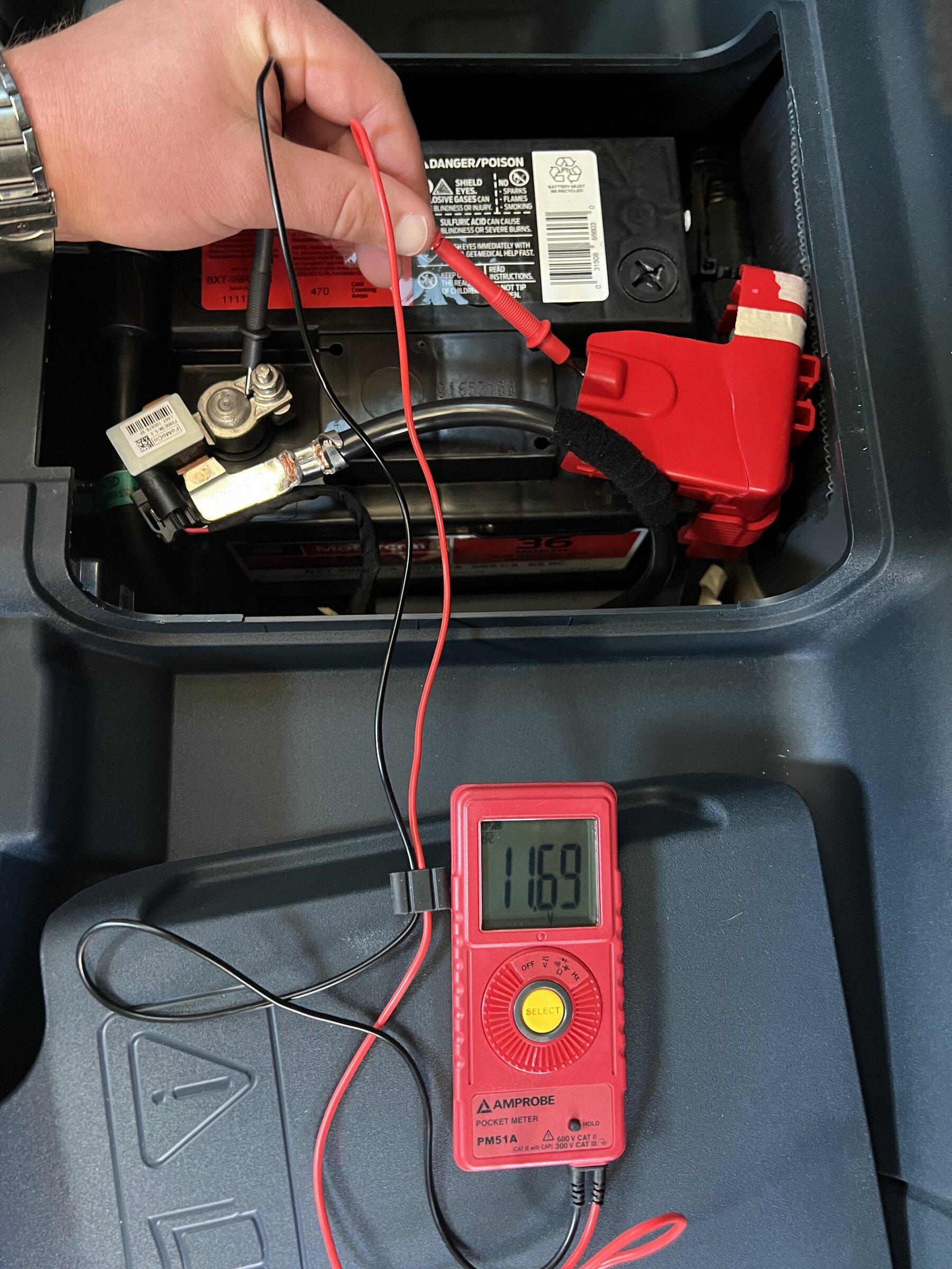

Update, the new battery the dealer installed looks like it's draining again. I got another deep sleep mode notification and the battery voltage is reading 11.6 just 3 days after getting the new battery installed. The truck hasn't died yet though. Again, I haven't left anything on, no lights on, no aftermarket things plugged in, I even unplugged my genuine apple USB charging cable to see if that made a difference.
Another thing, I thought it was normal for Hybrid vehicles to do this but when I get out and lock the car, I can hear relays throughout the entire vehicle clicking randomly for a good 30 minutes after the car has been parked.

Hmm, interesting. No I didn’t see your post before. I’m expecting my car to be dead again by tomorrow as I just checked my battery voltage and it’s 10.1 volts and the interior lights no longer turn on so I’ll contact the dealer again Monday to bring it in. I wouldn’t doubt it if my car had a similar issue. Mine just seems to be a very bad parasitic draw. I haven’t had any electrical issues/cutouts while driving other than the door chime playing through the steering column (my Mav has almost 1000 miles now). Not sure if yours did.
I really hope this doesn’t turn into a big pain in the ass and we have to wait for Ford to redesign their wiring harness and our cars end up getting stuck at the dealer for months, if that’s the case, it’s an automatic lemon (according to California lemon law at least). To make matters worse, there’s a loaner car shortage and even Enterprise/Hertz rental cars are almost always booked.
