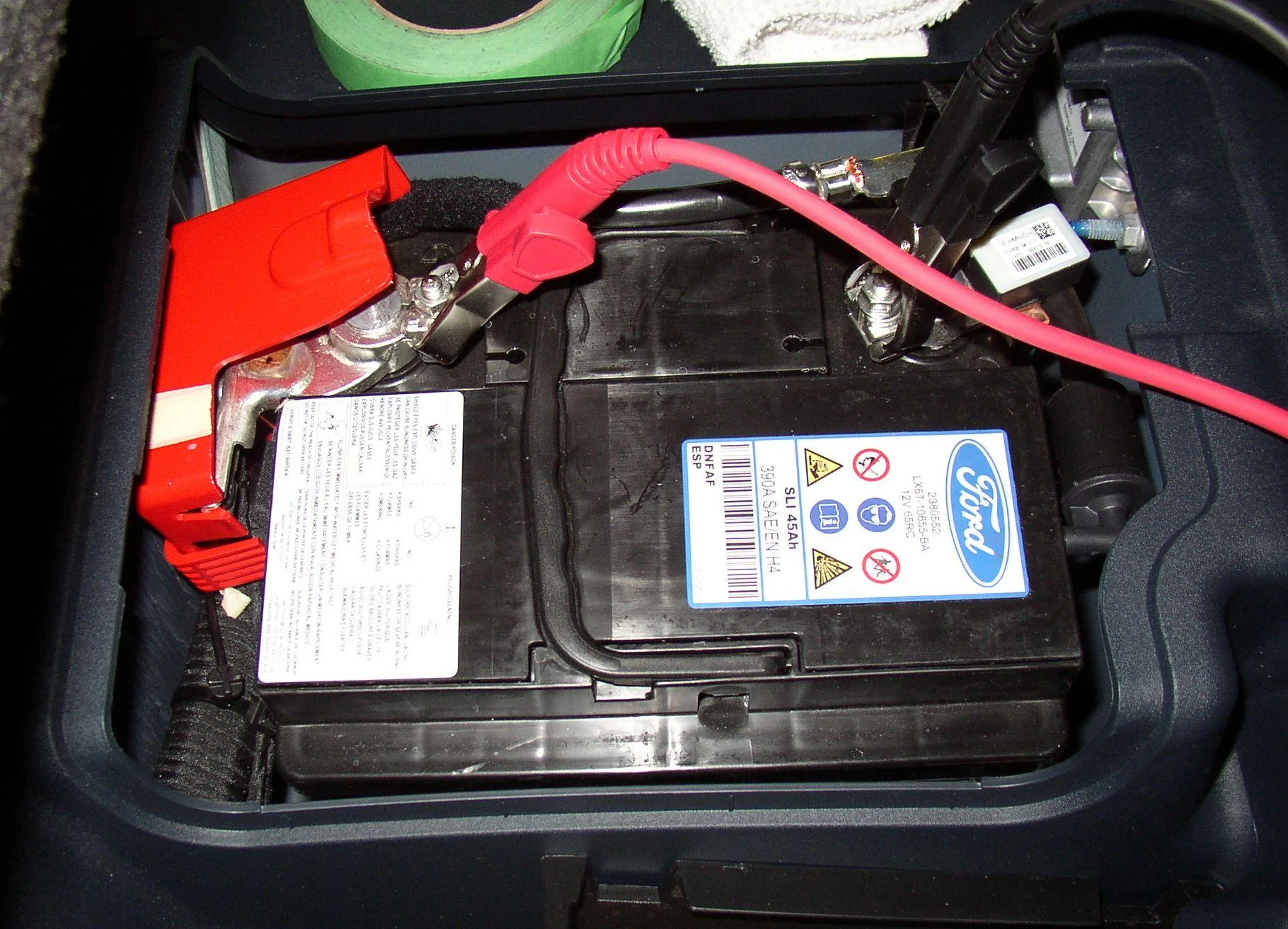

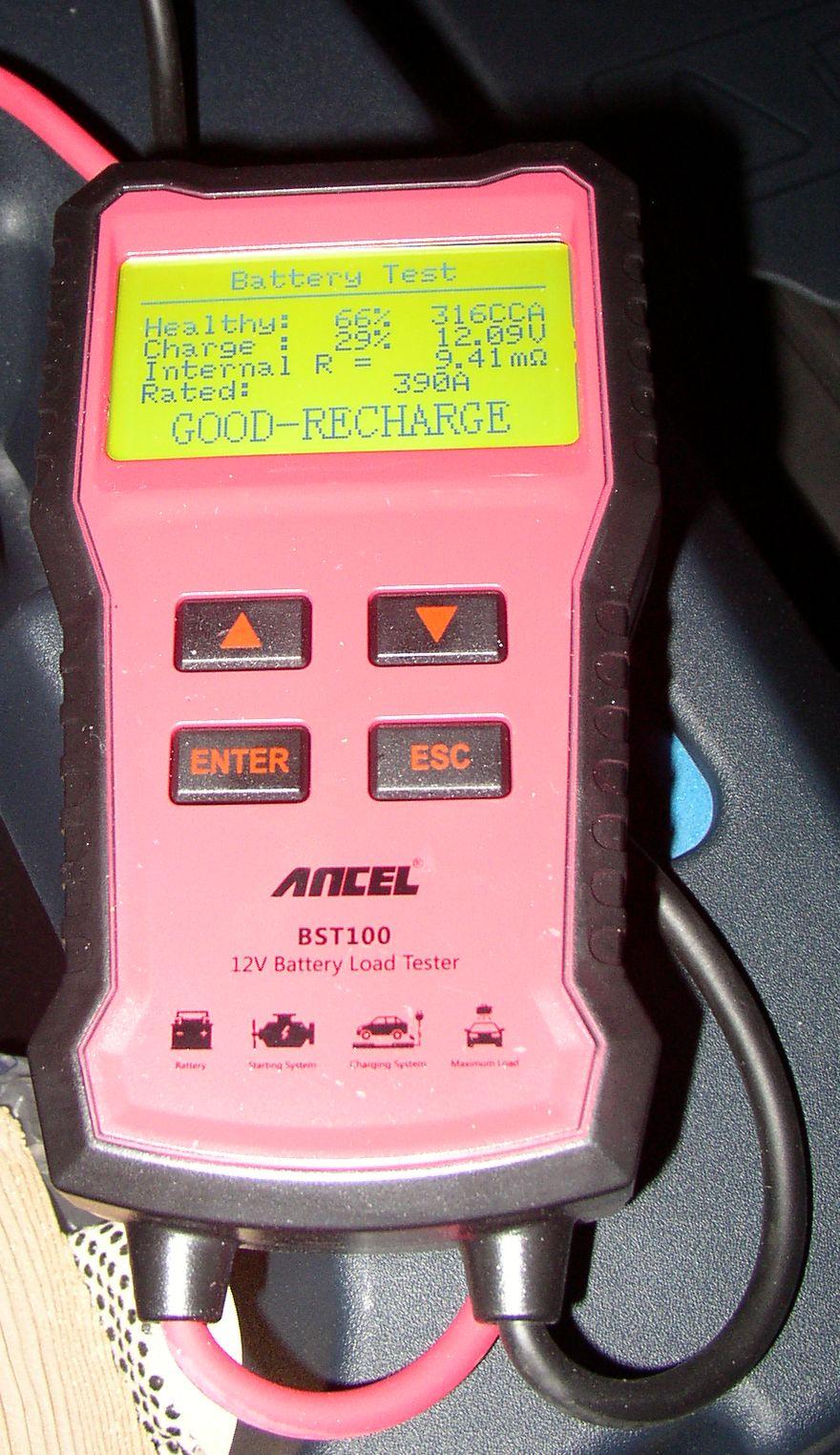

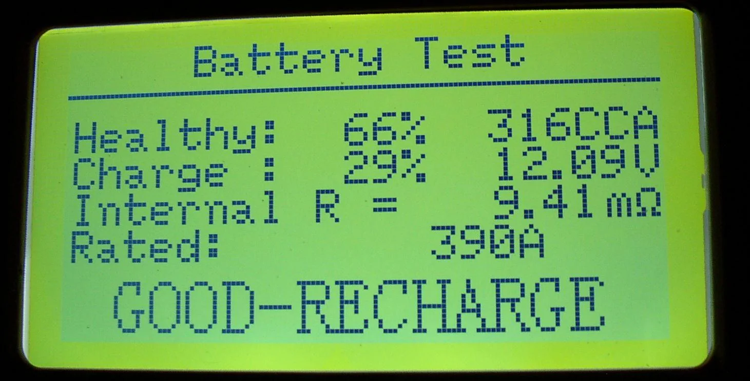

I have an ANCEL BST100 Battery Load Tester and testing the battery at the time of the Deep Sleep notice these were the results:
Healthy: 66% 316CCA
Charge: 29% 12.09V
Internal R = 9.41 mohm
GOOD-RECHARGE

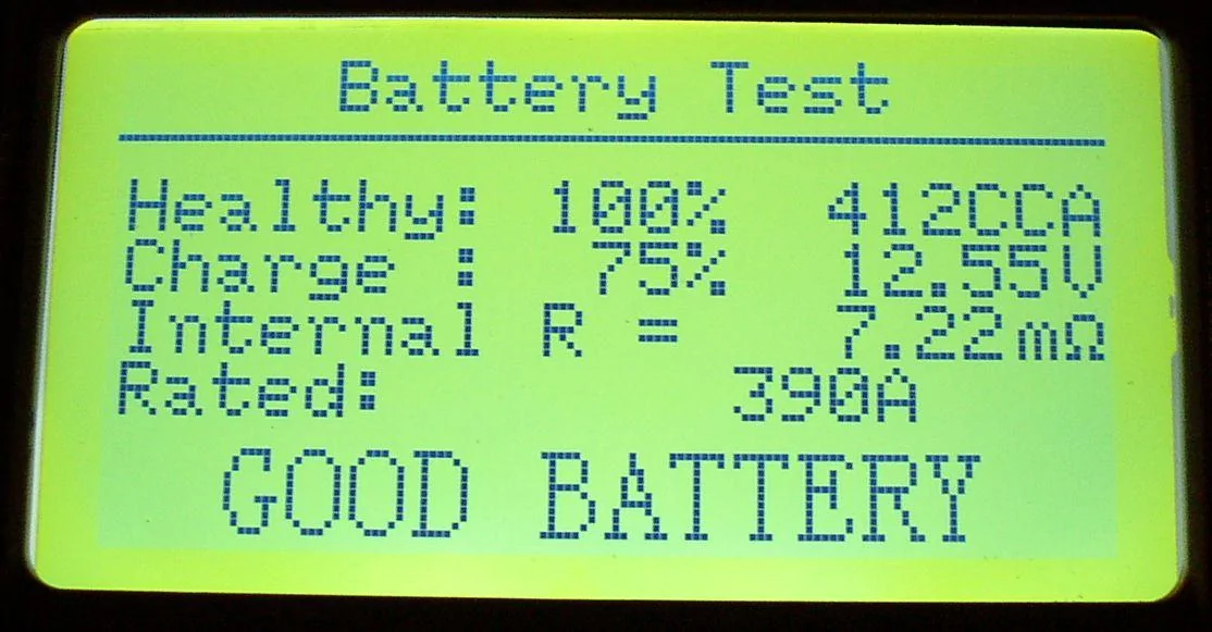

After having the Maverick ON for about 45 minutes (HV Battery charging the 12V battery) and the ICE engine running some minutes to charge the HV Battery these were the new readings when I got home from grocery shopping and washing the truck.
Healthy: 100% 412CCA
Charge: 75% 12.55V
Internal R = 7.22 mohm
GOOD BATTERY

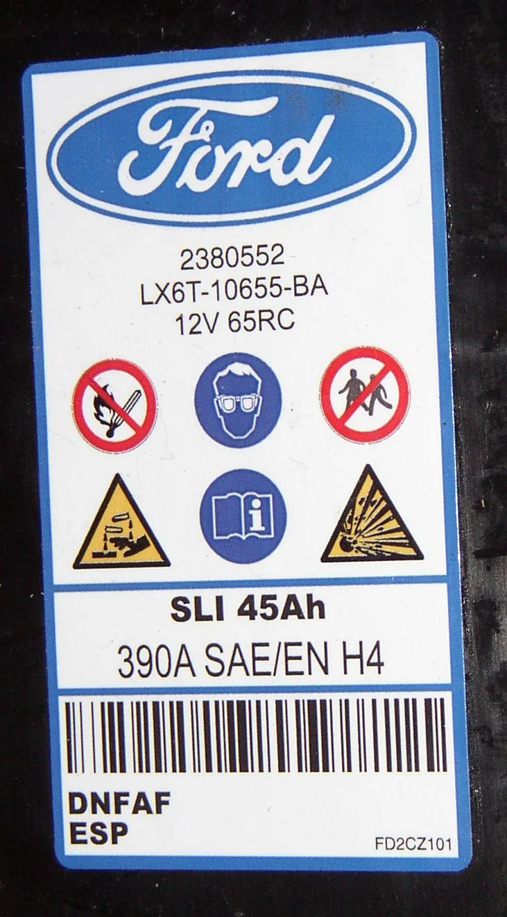

I set the tester for 390A CCA as the label on the battery shows 45Ah and 390A. Nowhere is a CCA number shown so I just used the 390A as the CCA number. If this is wrong let me know the correct number.
Healthy: 66% 316CCA
Charge: 29% 12.09V
GOOD-RECHARGE
Charge: 75% 12.55V
GOOD BATTERY

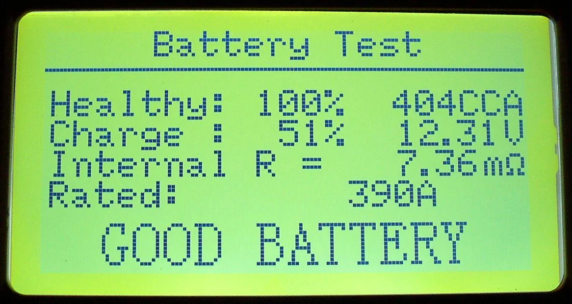

Draining and/or not charging is still happening.
I had a long trip today to and from Home Depot about 30 minutes each way and testing the battery 6 hours after the trips shows the charge is now only 51% down from 75% yesterday.
So one of three things is happening:
1. The battery is not being charged fully
2. Something is causing excessive drainage
3. The battery is starting to fail

The other thread indicated bad/loose connection on the black wire that connects the charger to the battery -ve cable, you might want to check that. It's right next to the +ve terminal under the hood, it has a plastic flip up cover with DO NOT JUMP markings.

I think you can rule out the drain by checking the battery right after a trip. It show more charge after a trip, compare to before. If it does not, that means it's not being charged during the trip.
