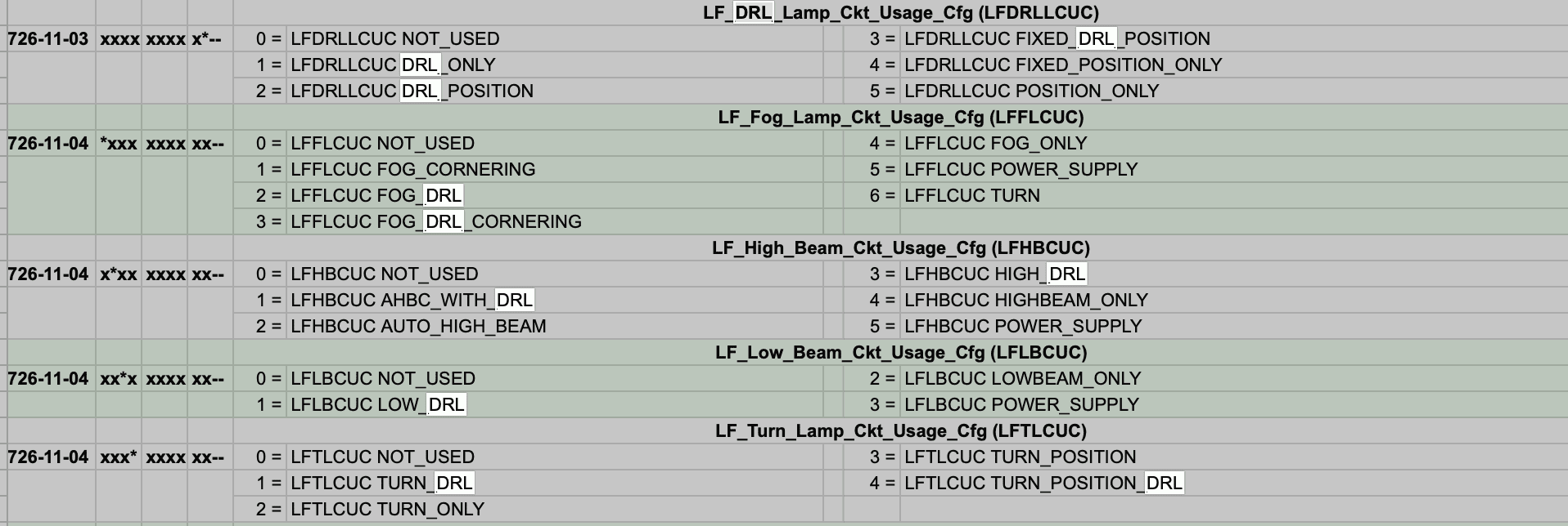

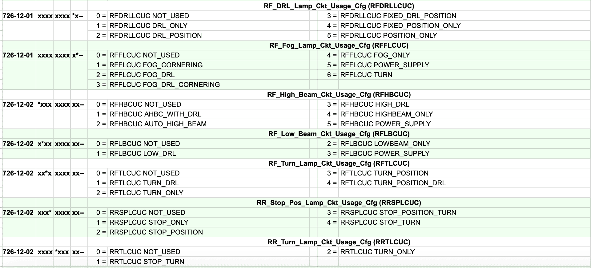

I saw on your first pic a cutoff of the DRL’s. Are there lines for the LF and RF DRL? That’s what I’m trying to change.
Sorry for the late reply. Here you go. I would consider comparing your entire BCM coding with the BCM coding from a Lariat to ensure you are changing the right settings. These are th epics you looking for i think

Yes perfect thank you! And yes I plan on referencing a lariat BCM coding. Just need a baseline haha. Thanks!
looking through these seems like these are available in the “easy mode” but I am not sure where to go to get this module to communicate over the Lin line. I guess I keep trying!
thanks for all your help!

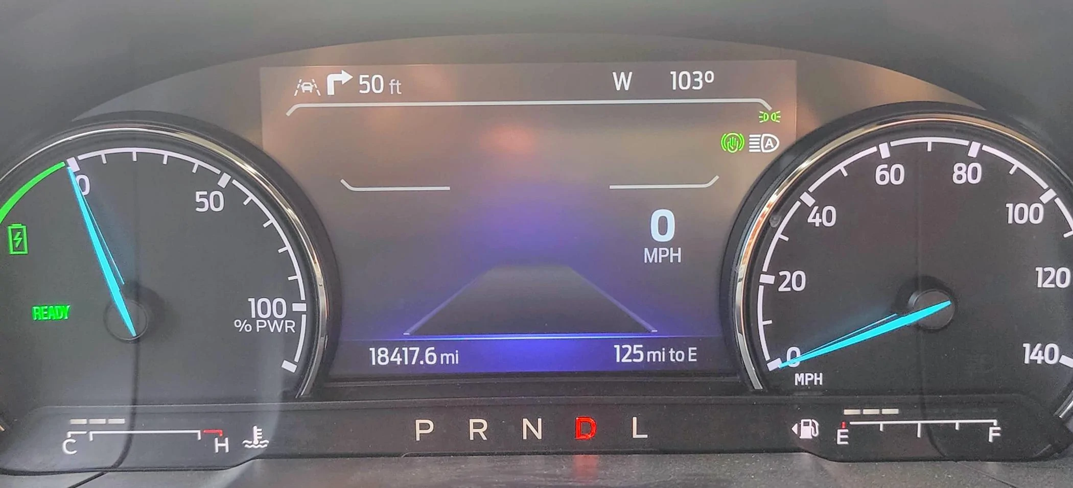

UPDATE: JUST FOUND A NEW CODING TO TRY TO ENABLE TURN BY TURN DIRECTIONS IN THE CLUSTER
Booyah 👊🏽 😁 👍🏽 🇺🇸
