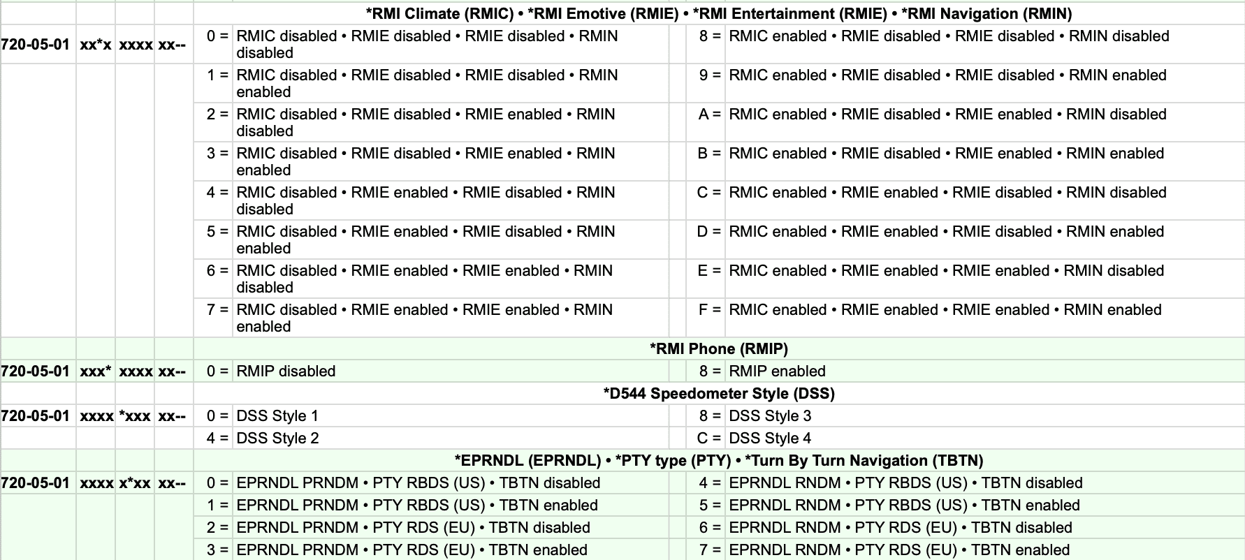

UPDATE: JUST FOUND A NEW CODING TO TRY TO ENABLE TURN BY TURN DIRECTIONS IN THE CLUSTER

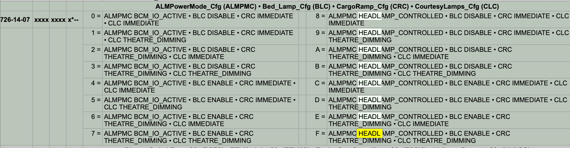

I know you said you've been working with some f250 and other owners to get s spreadsheet together for figuring out what controls what... do you happen to have any info on what lines affect the headlights, specifically designating what trim has what headlights?
definitely in the BCM I can track down what coding lines specifically

In other Ford vehicles the Nav screen will show next turn and distance to it. The caveat being that if you are using CarPlay you MUST be using Apple Maps. Conversely if using Android Auto you must be using Google Maps. If you have built in Nav (Sync 3/4) it’ll also show up there.
Yeah so it looks like you have to have sync for the NAV to work

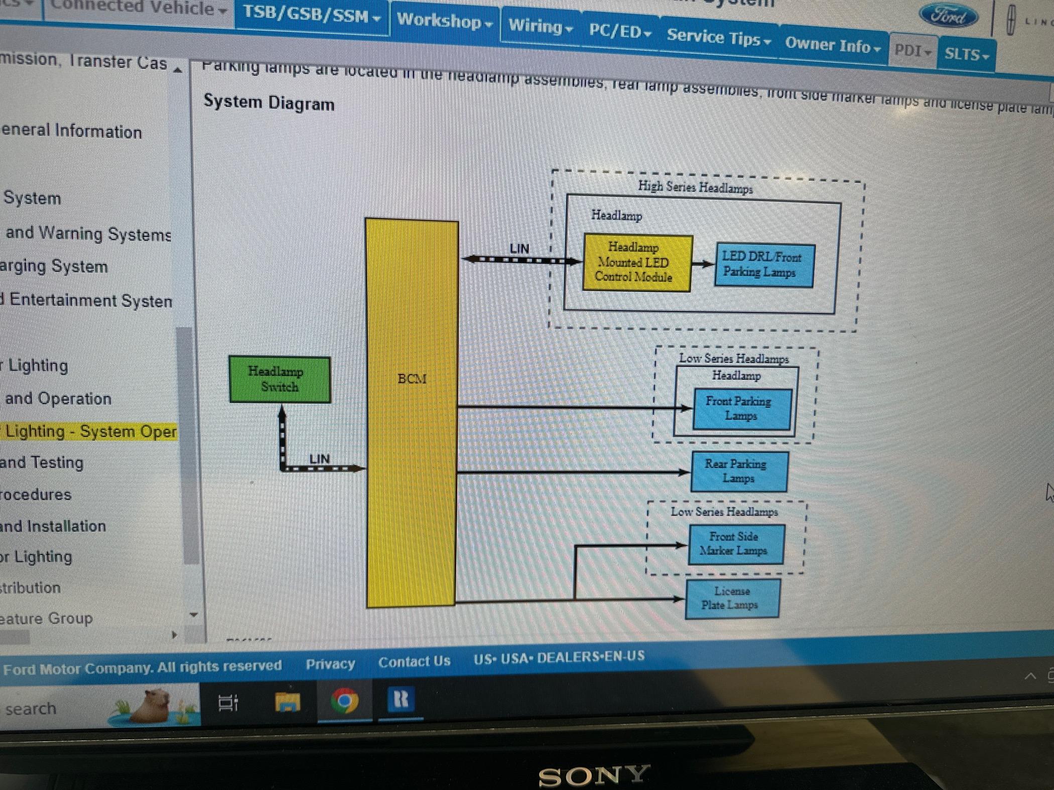

Which ones control the headlights, specifically DRL. Trying to see if there’s settings beyond what’s available in ā€œeasy modeā€. I got my lariat lights working but they were on at 100% brightness, even at night. In attempting to fix, I did a Lin, which now they don’t light again and I have to go down the rabbit hole. According to ford workshop manual, the upper light is controlled by the headlights internal module, activated by the Lin line to the headlight from the BCM… maybe there is a line to tell if this vehicle has that module or not.

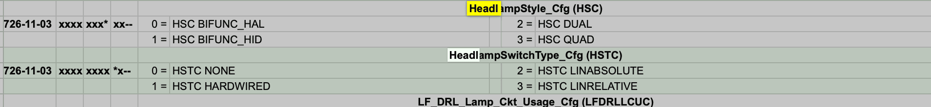

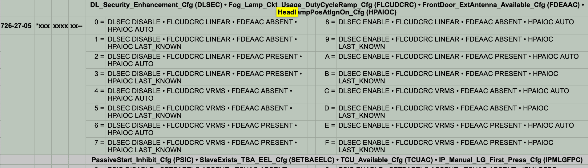

I got you let me send you some pictures.
Ford Maverick Unlocking More Hidden Features for 4 inch Cluster using FORScan Screenshot 2024-03-28 at 2.40.41 PM
Ford Maverick Unlocking More Hidden Features for 4 inch Cluster using FORScan Screenshot 2024-03-28 at 2.40.58 PM
Ford Maverick Unlocking More Hidden Features for 4 inch Cluster using FORScan Screenshot 2024-03-28 at 2.41.18 PM
Ford Maverick Unlocking More Hidden Features for 4 inch Cluster using FORScan Screenshot 2024-03-28 at 2.41.31 PM

hey I edited my last response with pictures of coding i just did a quick search for headlamps in the BCM. I can do some more digging if those pictures of coding options do not help!
Thank you!
I’ll be completely honest, I’m not sure what I’m really looking at here. Which controls the headlamp type, I’m assuming I need to tell it it’s Lin now since the lariat lights have a module that communicates that way, and whatever controls DRL?
I saw on your first pic a cutoff of the DRL’s. Are there lines for the LF and RF DRL? That’s what I’m trying to change.
