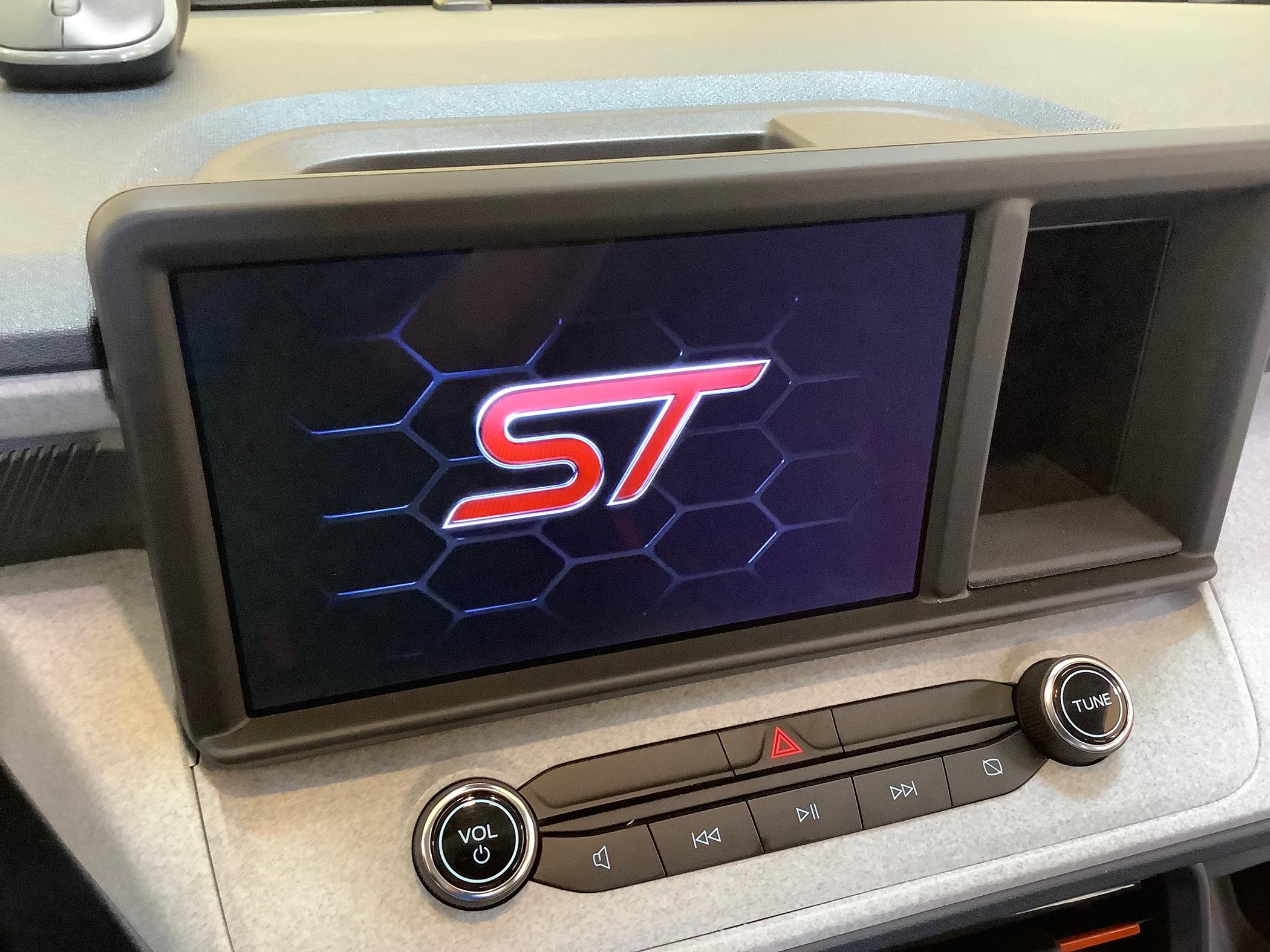

On my 24 XLT FX4, I went into ACM in easy mode and was able to change from default Ford flash screen to ST as the only other option. I am told that I will not have sync3.
So now I have below:
