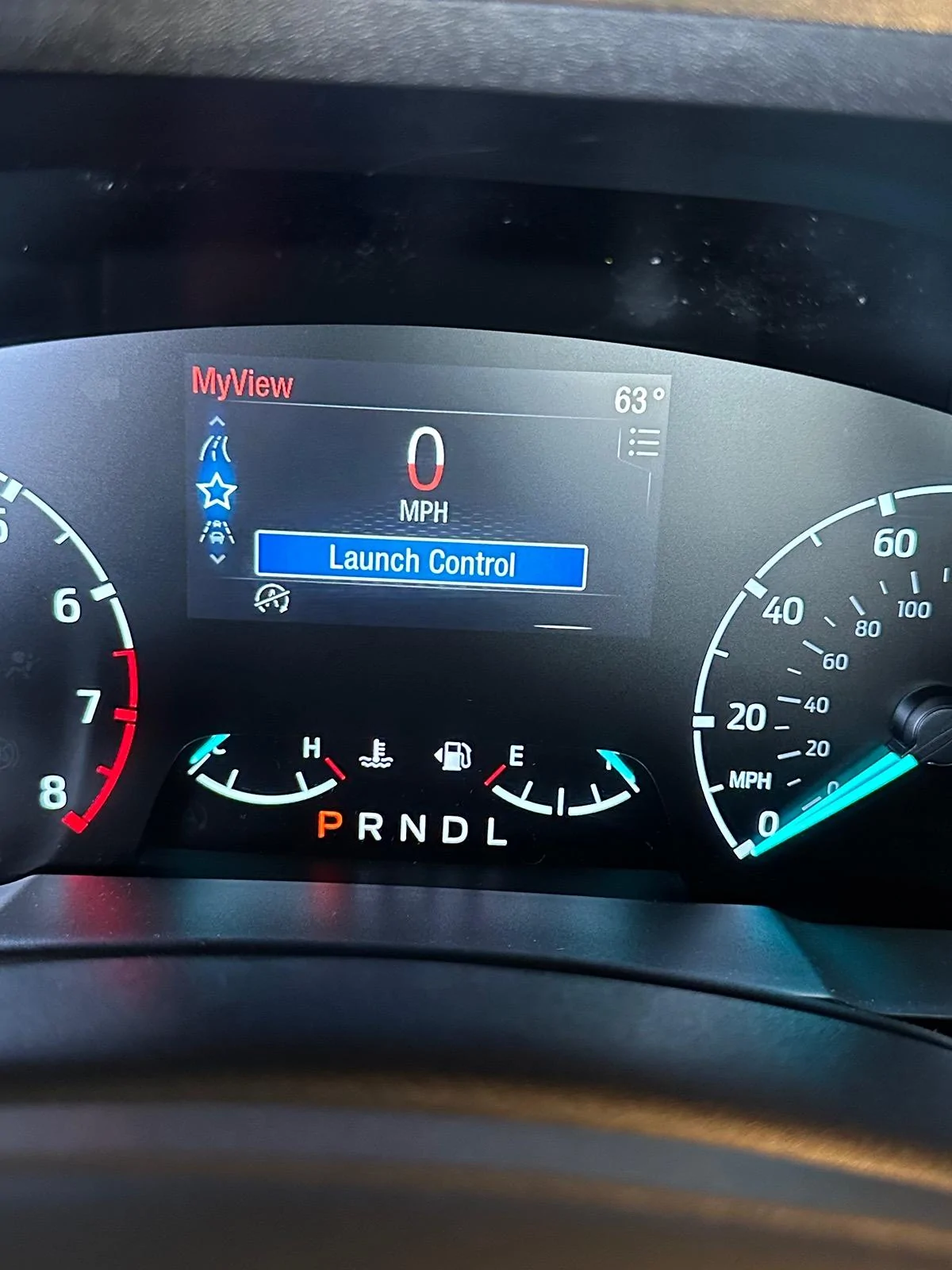

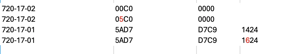

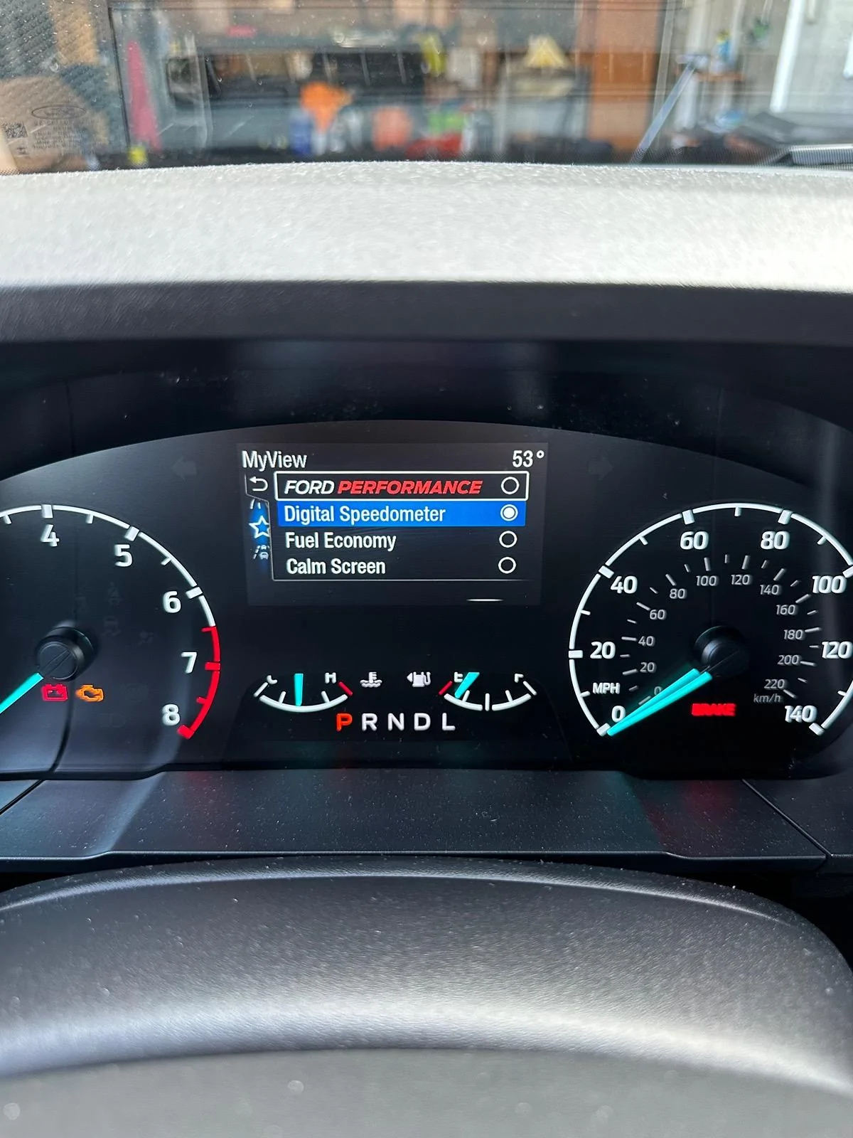

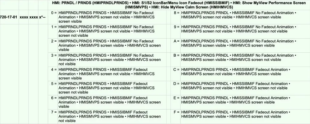

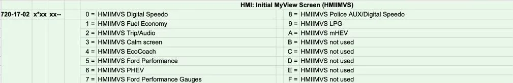

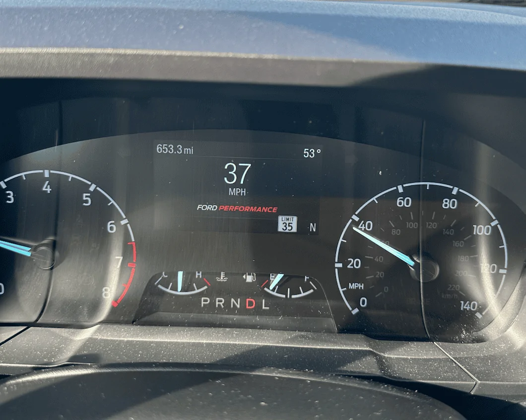

FORScan Coding to make your 4 inch Cluster look COOLER AND LAUNCH CONTROL
Iakona
Jason
Jan 30, 2022
Beavercreek, Ohio
2023 Maverick Tremor, 2022 Maverick FX4
I may test it out once and let you know! The launch control can be enabled on any MAVERICK! but the little display and button for it can only be enabled on the 4 inch cluster.
Gotcha. I may play around and see if I can figure it out on the larger display....
