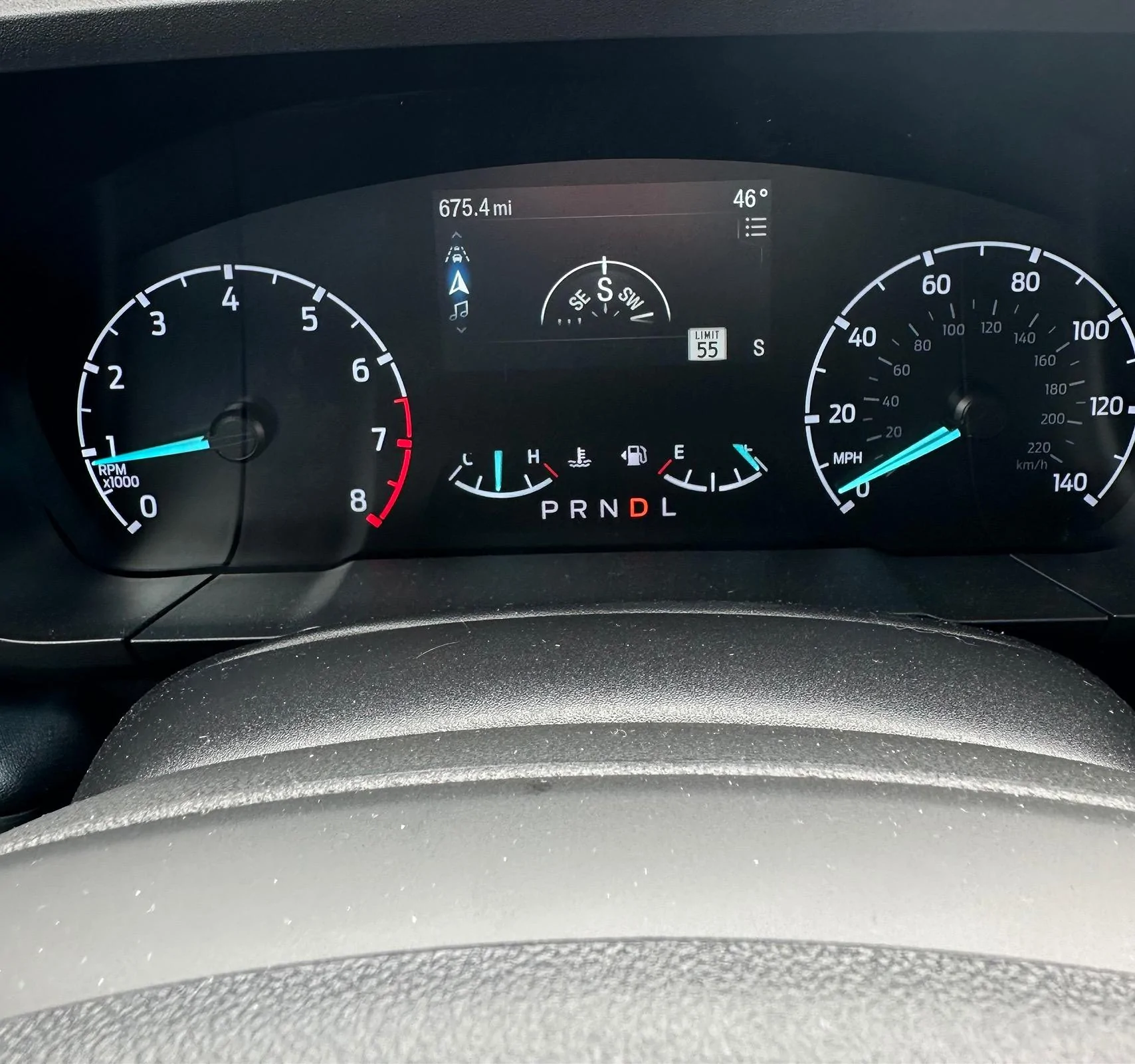

Hey everyone!
So I have just been digging through this Maverick Hex Code Spreadsheet (mostly the IPC section) and I found a few more useful coding changes for the 4 inch Cluster in addition to my ORIGINAL THREAD. I will list the coding and pictures below.

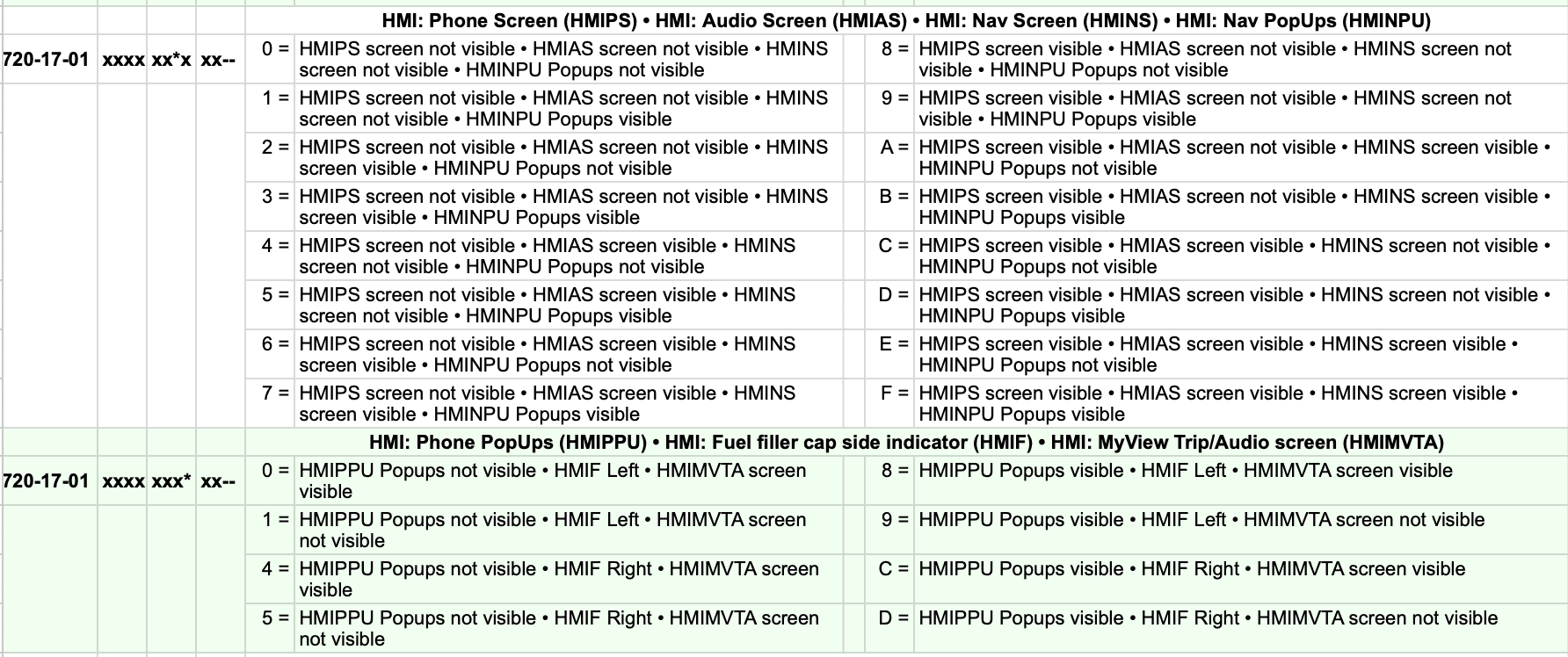

ENABLE OR DISABLE PHONE, AUDIO AND NAV SCREEN
1. OPEN IPC AS BUILT
2. Go to 720-17-01
3. Change the seventh digit based on this guide below
DISABLE ALL "0" xxxx-xx0x-xxxx
ENABLE ALL "F" xxxx-xxFx-xxxx
(Factory Coding Below)
PHONE AND AUDIO ENABLED, NAV DISABLED "C" xxxx-xxCx-xxxx
I THINK NAV SCREEN ONLY WORKS WITH SYNC WHICH IS LARIAT ONLY. IT CURRENTLY SHOWS A COMPASS BECAUSE I DONT HAVE SYNC

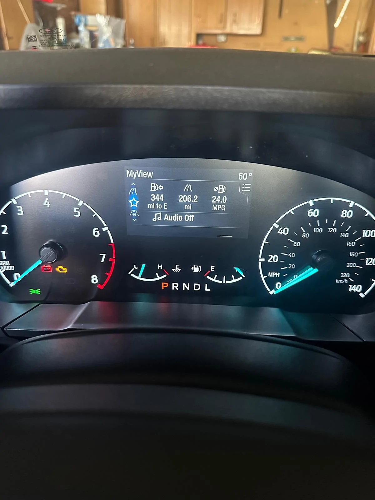

ENABLE TRIP/AUDIO MY VIEW SCREEN
2. Go to 720-17-01
3. Change the eighth digit to a "8" as shown below. (Factory coding is a "9")
xxxx-xxx8-xxxx

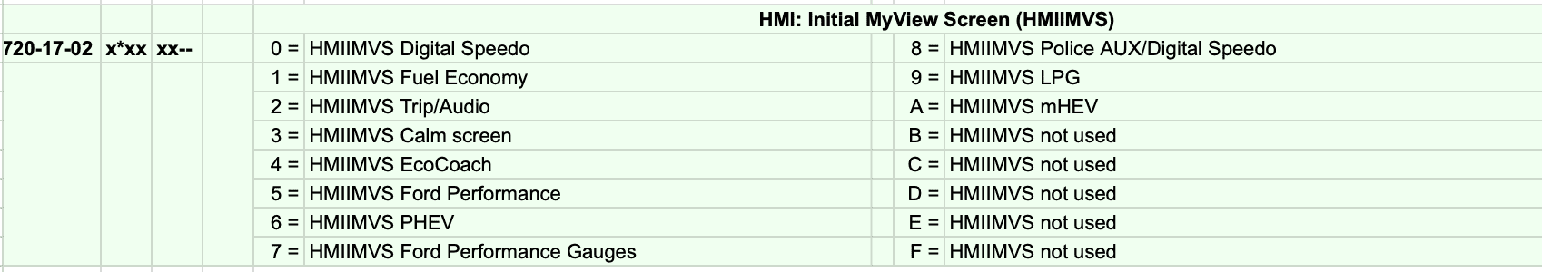

CHANGE YOUR DEFAULT MYVIEW SCREEN
2. Go to 720-17-02
3. Change the second digit based on the guide below
(Factory Coding) Digital SPEEDO "0" x0xx-xxxx
FUEL ECONOMY "1" x1xx-xxxx
TRIP/AUDIO "2" x2xx-xxxx
CALM SCREEN "3" x3xx-xxxx
ECO COACH "4" x4xx-xxxx

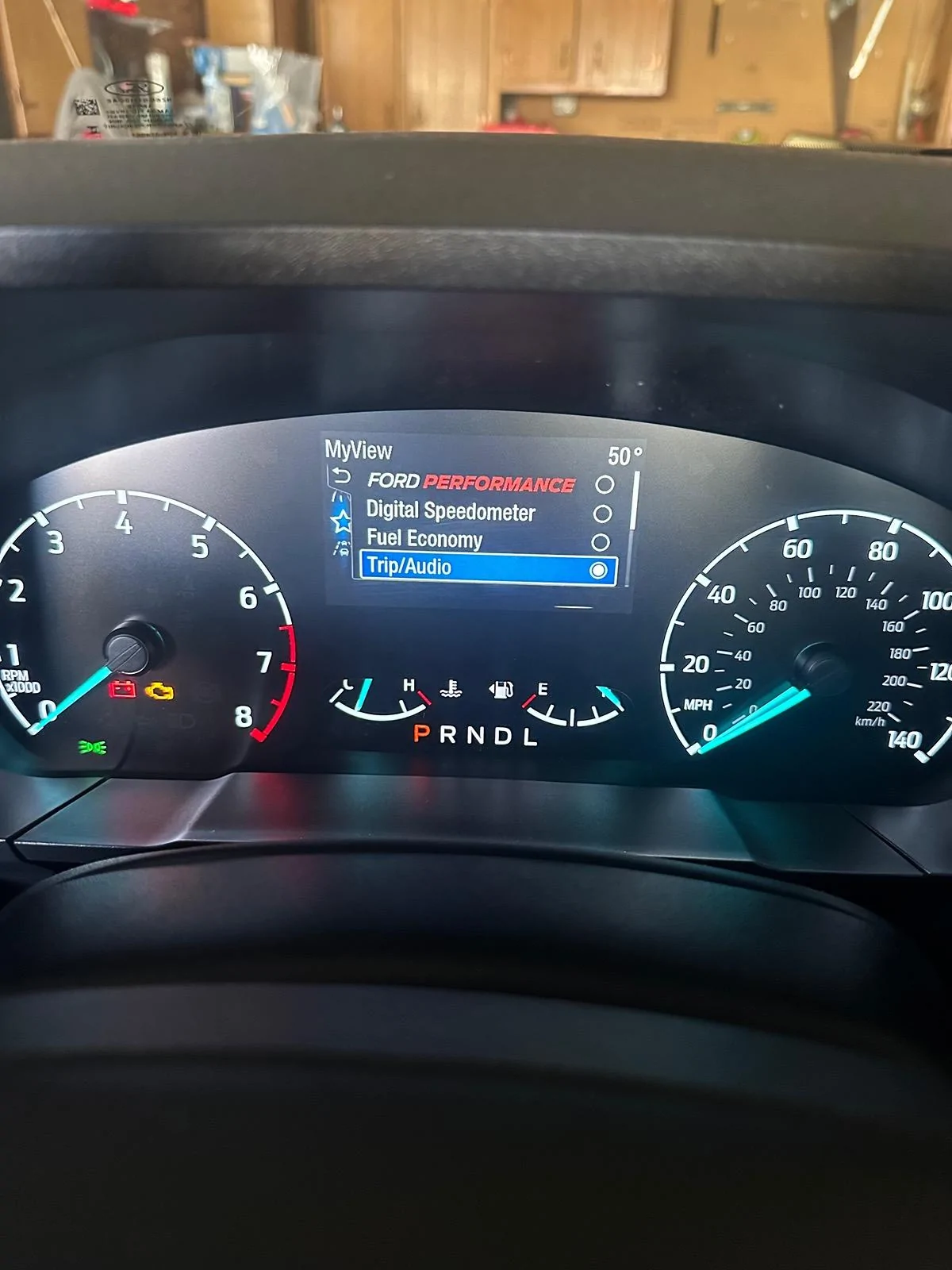

FORD PERFORMANCE "5" x5xx-xxxx

So I did a little research on this for the Ford Performance Screen.
The Fiesta & Focus ST 2018+ came with the 4" screen, then in 2022 the ST's came with the full 12.3" cluster (2021 for the Puma ST). So it actually makes sense that there is the option for a "Ford Performance" screen on the small cluster and most likely the 12.3" cluster, but none available for the mid-tier 7" screen cluster, because (unfortunately) it was never offered with any of Ford's ST offerings. I guess us 7" guys will just have to keep dreaming unless someone comes up with something custom.
It would be SWEET if someone could get the ford performance screen working on a 12 inch cluster on the Maverick!
I agree, I'm not sure if the ST Explorer actuallly comes with an ST Splash Screen with the 12" Cluster, but I assume it would. If it does I'm sure someone could figure out how to get it programmed with the Maverick.
I guess we'll have to see what gauges the 2025 Maverick ST comes with!
