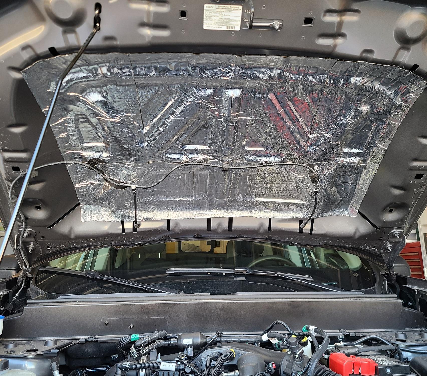

I installed Dynamat yesterday
It did cut down sound at low speed (haven't taken it on the freeway yet)
I made a cardboard template first and cut it to size.
I think it makes for a much cleaner look as well!
I had some extra KillMat from another project that I installed first - I put the KillMat into the depressions to make the surface more flat for the Dynamat to stick to.

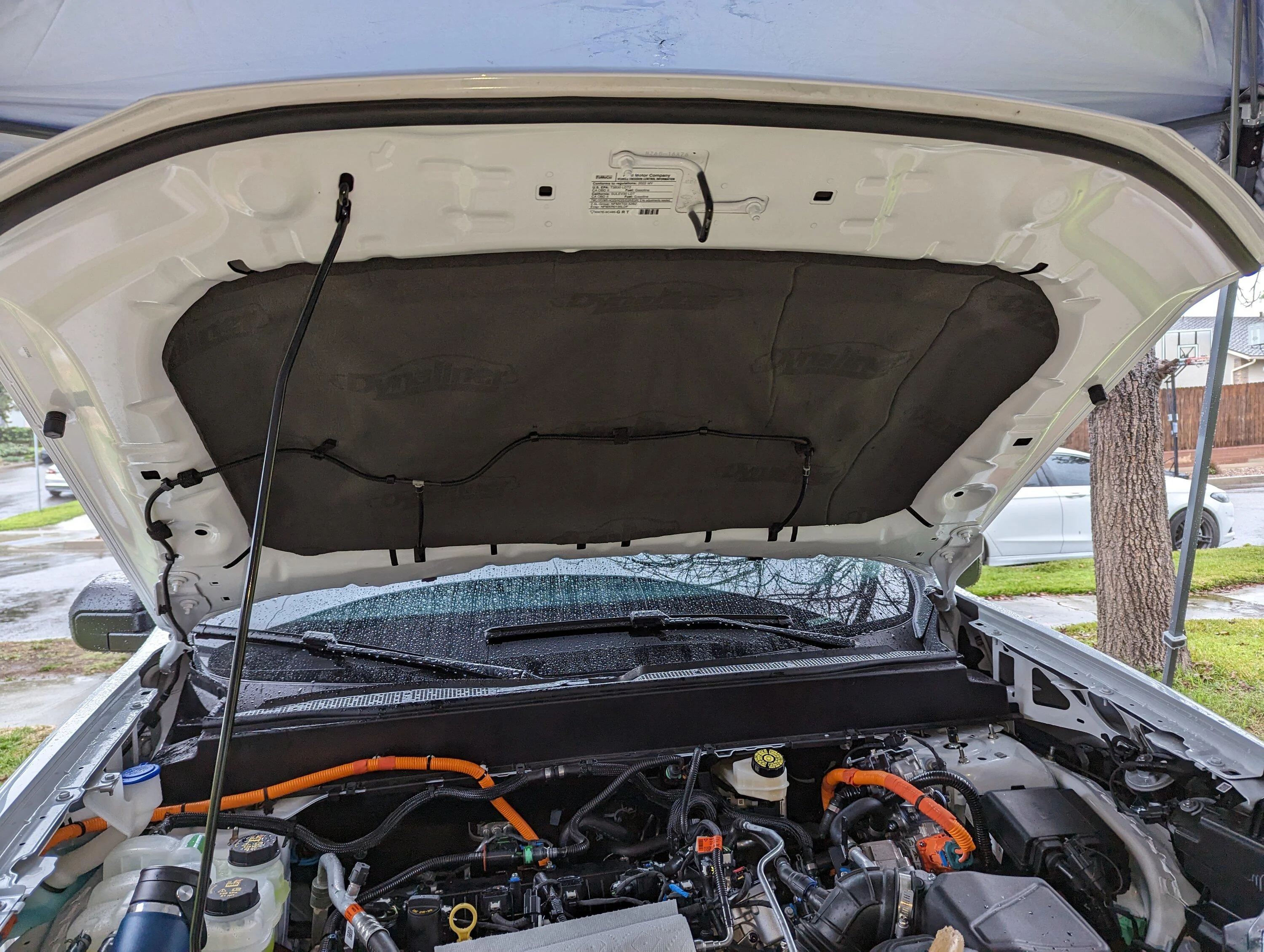

Hood insulator: Mine arrived today 12/12/2022. Part # M1PZ16738-B is a blanket type material and mounts ON THE UNDERSIDE OF THE HOOD. Not to be confused with the molded rubber engine cover for the 2.0L EB that mounts on the engine. The blanket included the rectangular plastic clips positioned in holes stamp-cut into the blanket. HOWEVER it is not a direct fit. The holes do not align with any under the hood. Additionally, there are two flaps and no place under the Mav hood to tuck them into. Before I go and cut and modify the blanket I would like to know what others have done. Did you simply disregard the pre-cut holes for the clips and cut holes where the hood has them or did you use contact cement to glue the blanket to the underside of the hood, disregarding the clips entirely? I attached a photo of the part for those who requested one. The overall dimensions are 21 1/2" deep X 53" and it will fit exactly under the hood. It just doesn't mate with any existing cut outs or holes in the metal.

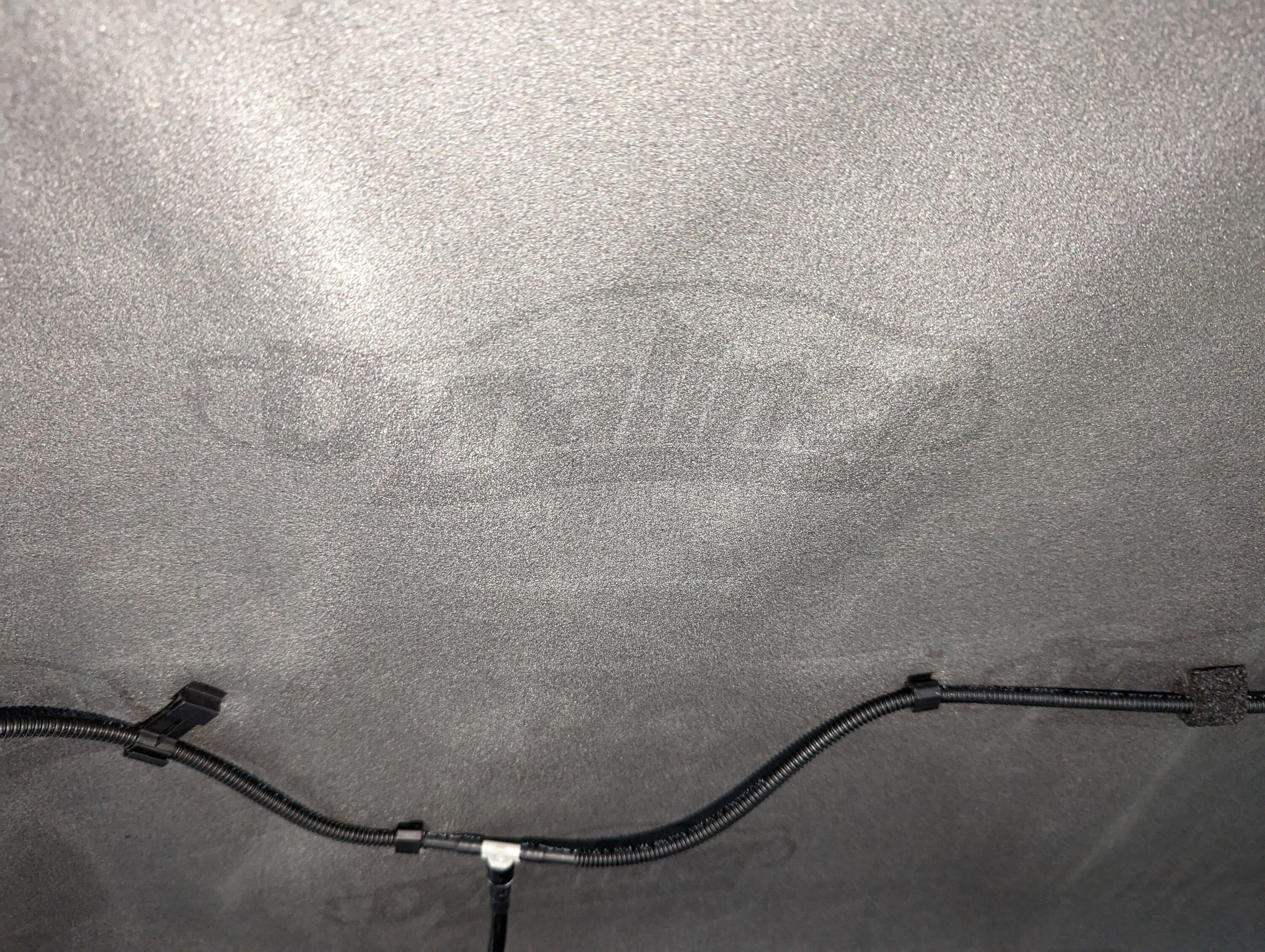

Skip this product and use Dynamat Extreme instead- Dynaliner is useless.
Reviewed in the United States on July 25, 2017
Verified Purchase
The Dynamat Extreme that I installed in my old truck cab is awesome, and it works very well. This Dynaliner (1/4" thick) that I installed inside my cab roof is pretty much useless and did nothing at all to attenuate noise. If you are going to use this product, apply it OVER Dynamat- do not use it as a stand alone solution. It might work better as a speaker enclosure material, but it is not something to be applied to metal panels that you are trying to quiet, though... a waste of my money for my needs.
