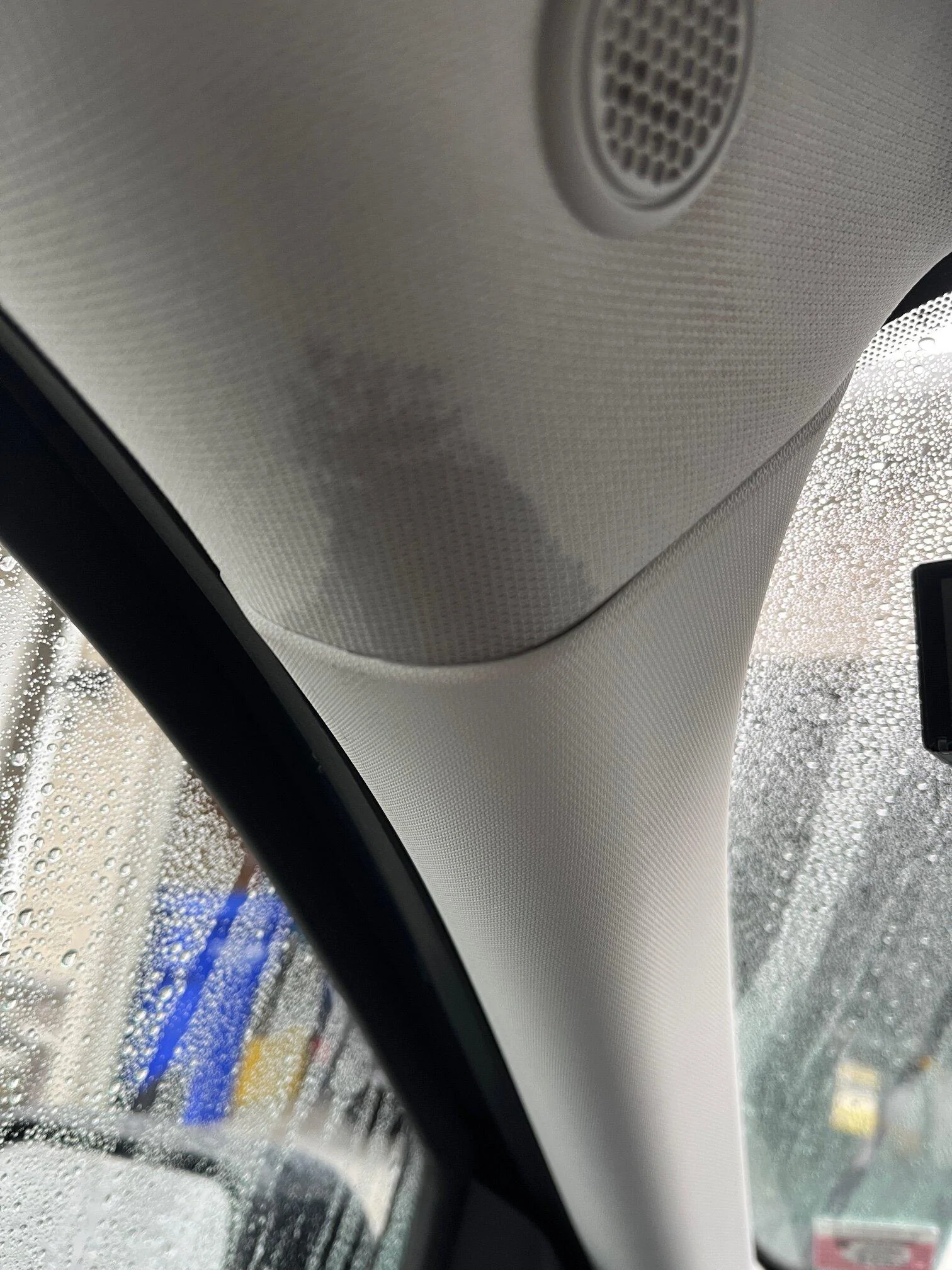

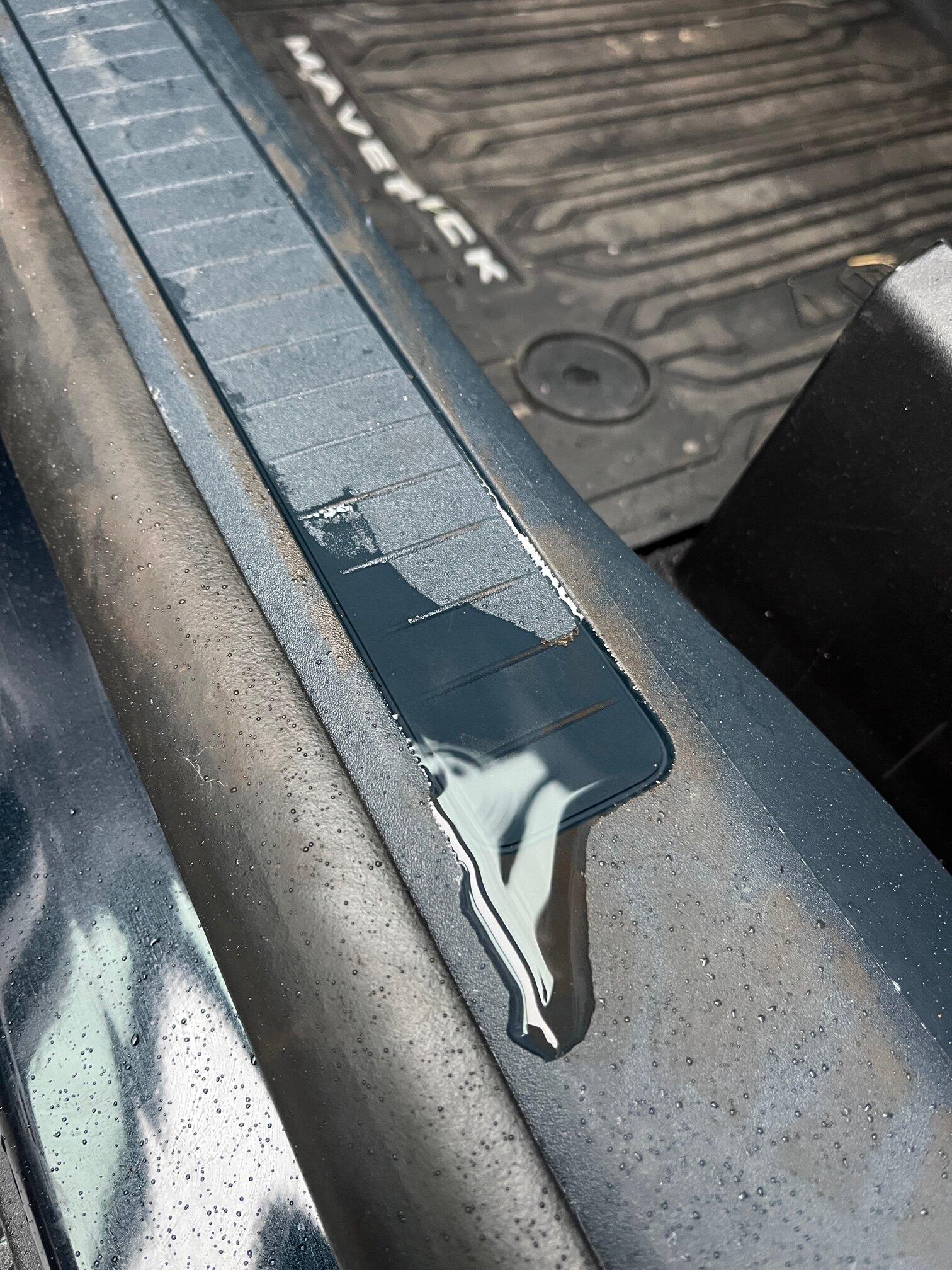

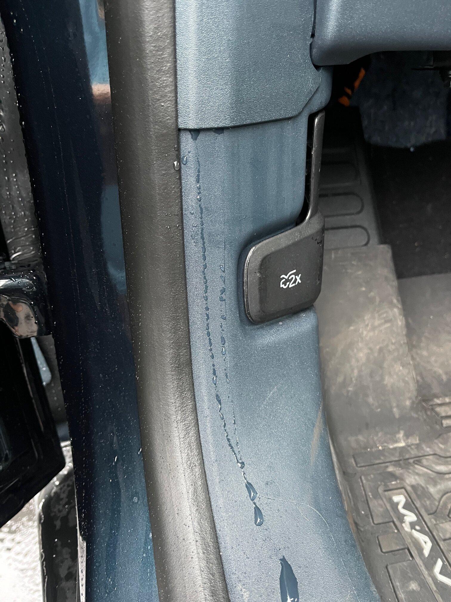

I'm taking my truck back to the dealer this Tuesday (9/12/23) for this and an odd water leak inside my driver side pillar that makes its way onto the driver doorsill as a puddle(what's with this truck and rain?:unsure:), and I'll be pushing for the 23-2060 update unless they can answer my question as to what is meant by 'superseded by'. Any additional insight you can offer would certainly be greatly appreciated.

They found my leak. My leak was because the factory didn't install the sunroof drain tubes on the drivers side (see images). If that's your problem too, then give them a few days to order the parts and install them; basically the dealer helps build your truck because the factory didn't. That's the good news. The bad news is I'm getting into the - "your build date doesn't qualify for any of the fixes for the brake grab problem and the dealer doesn't get paid for doing updates that Ford claims aren't required" - phase of getting the brake grab problem fixed. The good news on that is that it had rained a lot before I went to pick up the truck up yesterday. My brake grab issue only shows up when it has rained a lot. I was able to have a service guy drive the truck around the lot and experience the brake grab problem first hand. That takes the he said she said element out of the equation. The dealer is now taking a different approach to the brake issue. Waiting to hear back from them on what they do or do not find and the path forward. But one more bad news item. My driver side door had a scratch in it about a foot long that wasn't there when I brought it in. I had washed and shined up the truck the day before, so I know what was and wasn't going on with the body. They'll buff it out and re-do the ceramic coating. I bought this truck as a retirement gift to myself. I'm beginning to think I'm real bad at picking out gifts.
But here's a question for Ford. If the factory can't even put in the sunroof drain tubes, how can you assure me that the factory did the PCM updates that my truck required? 23-2060 came out right after my truck was built.
