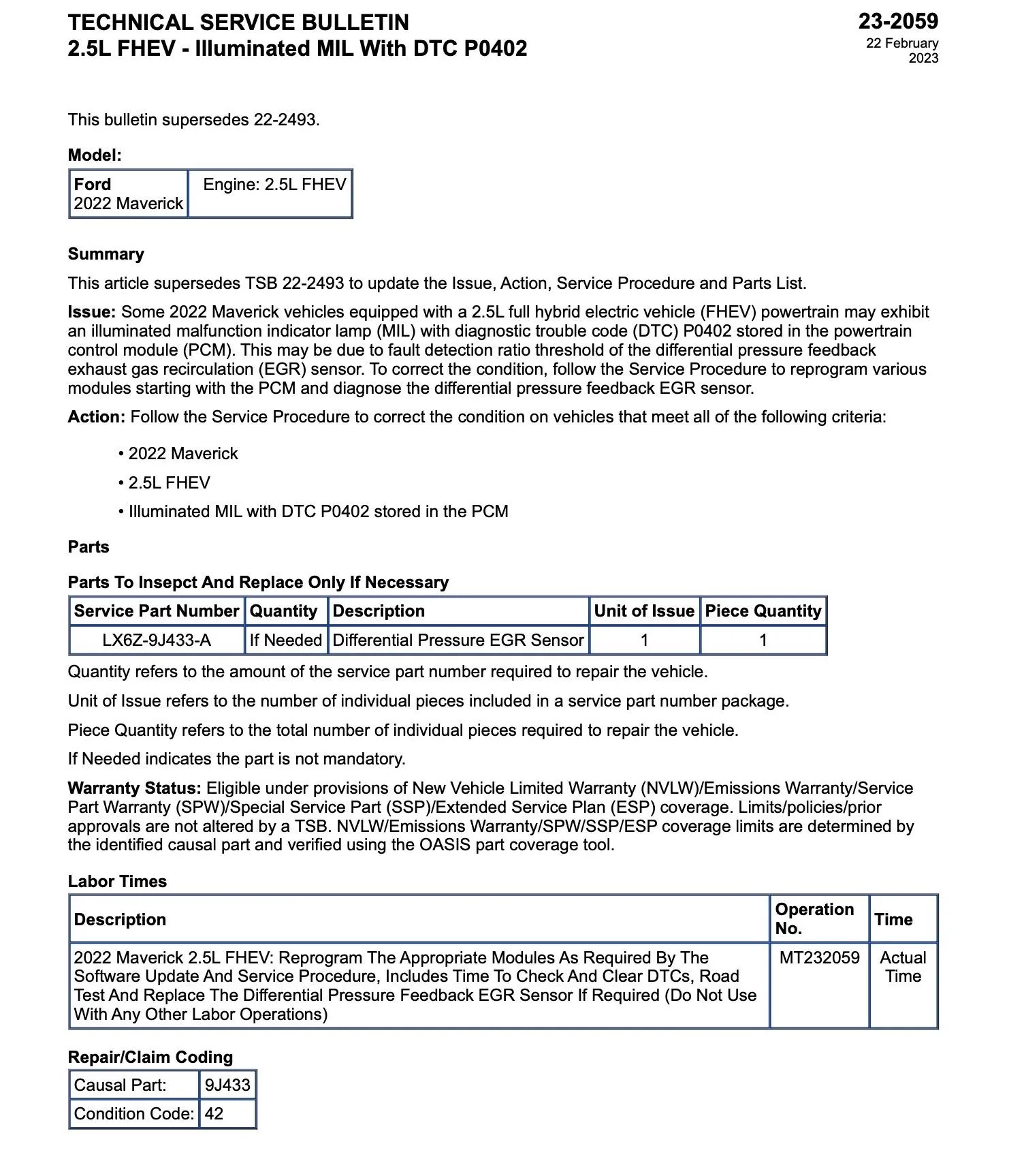

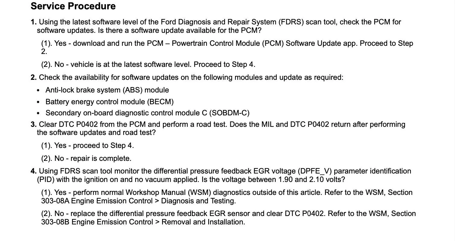

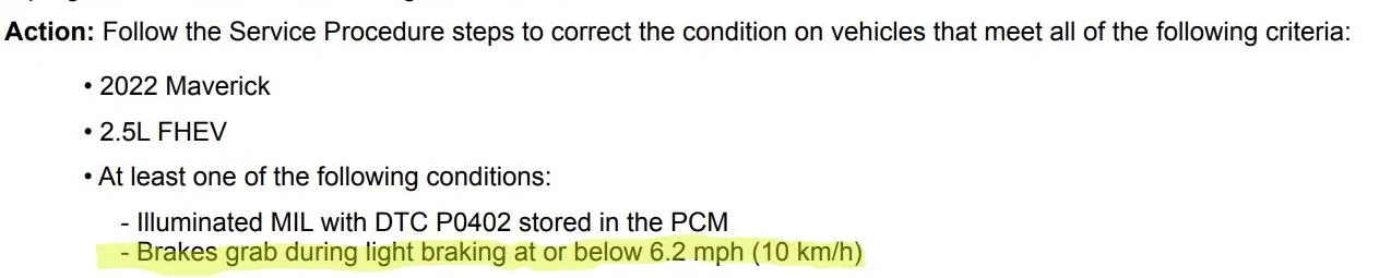

I was planning on getting the software update soon for the issue with hybrid braking at low speeds. The earlier TSB did not require a error code being thrown (as I understood it). It looks like this one does. So what happens if i have this issue but no error code? Am I missing something?
