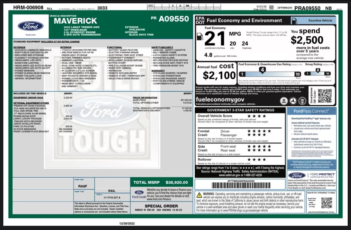

Just received for production next week! A bit disappointed in the MPG drop.
Ford Maverick Tremor real-world MPG? Guesses? 6FBB0D0A-97A7-4BA8-AB7B-53DE5D9DE547

Wow, that is a massive drop on the highway mpg...I don't think I quite believe it'll be that much in real life.

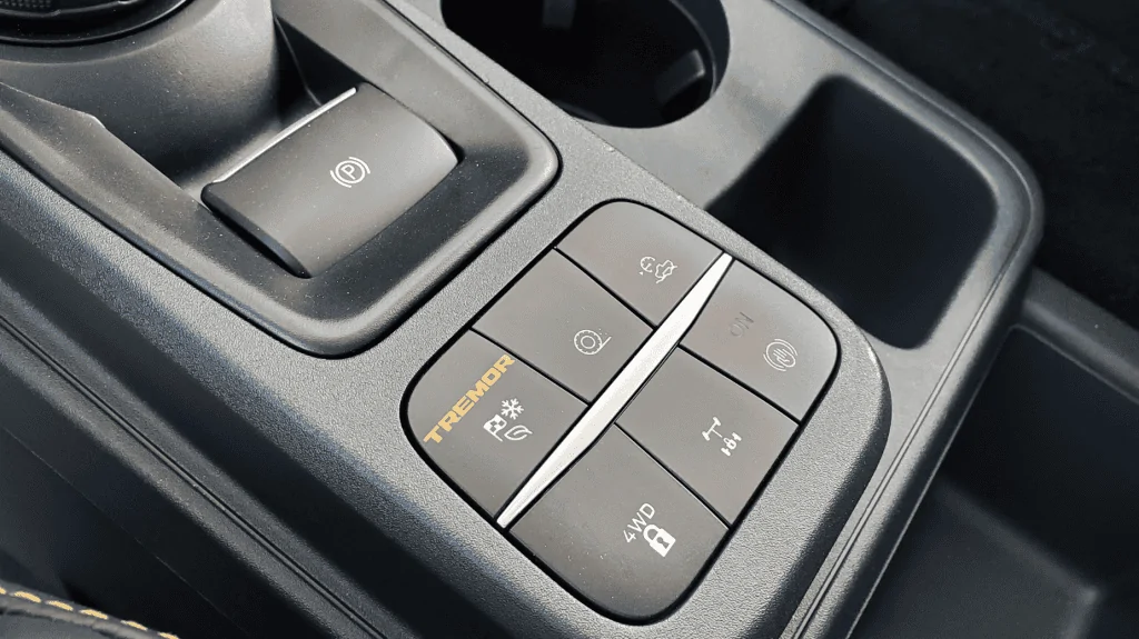

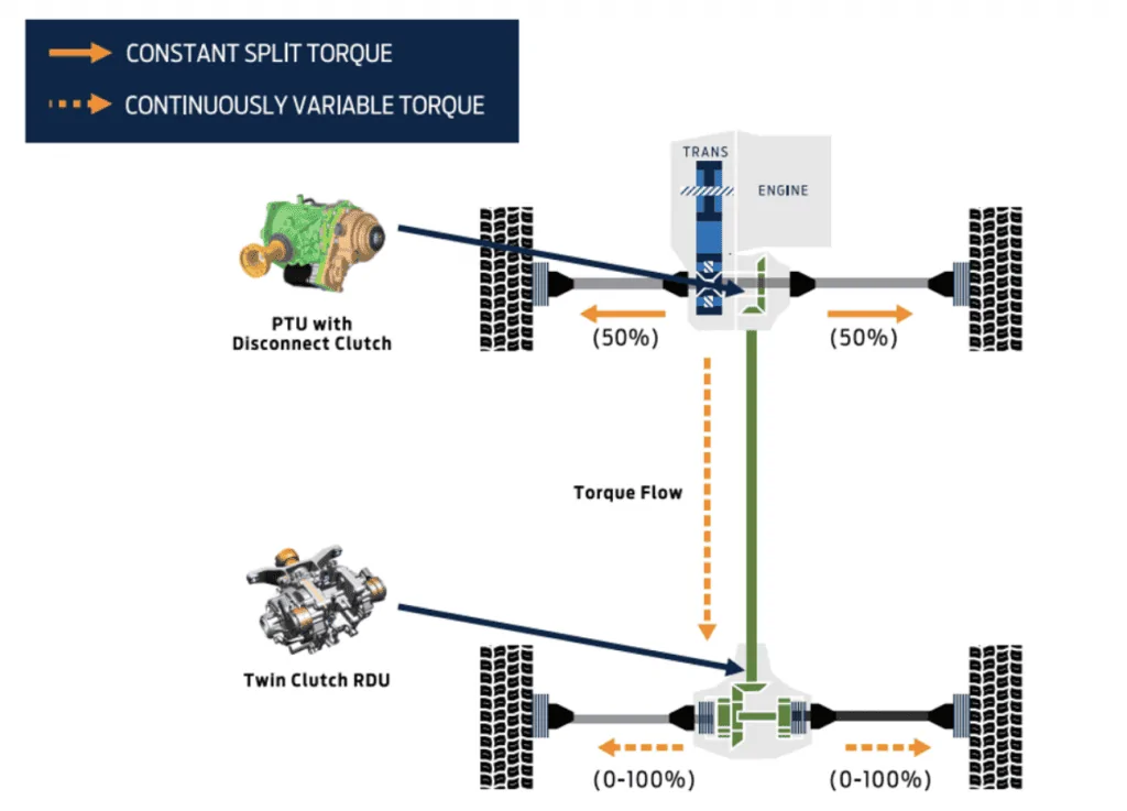

In short - all Mavericks (except Tremor) have an AWD system that is part time with open differentials. This means the Maverick is FWD until it detects wheel slippage and then it will send power to the rear wheels. There is no way to lock AWD in.
With open differentials - anytime time one of the two wheels per axle (front/rear) experiences less traction that wheel will get all of the power and spin freely. The system will recognize wheel slippage and then apply ABS to the freely spinning wheel to create traction and transfer power to the other wheel.
With the Tremor - it receives the Advanced AWD system found in the Bronco Sport Badlands and formerly the Focus RS. This has an entirely different RDU (rear drive unit) that is capable of splitting torque and locking AWD in and has the ability to lock the rear differential (via a twin clutch pack) so both wheels will spin 1:1 regardless of which wheel has less resistance.
Ford Maverick Tremor real-world MPG? Guesses? Screen-Shot-2022-08-12-at-9.40.56-AM-1024x737
You can see the locking 4WD and right next to it is the rear "locker".
Ford Maverick Tremor real-world MPG? Guesses? Screen-Shot-2022-08-12-at-9.52.17-AM-1024x575
It's really a great system. The Focus RS uses the torque-vectoring to actual assist in steering the vehicle during corners. It will apply power to the outside rear wheel to assist with turn in. The Mav won't do this - but it shows the capability of the system.
The standard AWD Maverick and the Tremor will perform identical in on road situations as you would not want to lock the AWD system OR rear locker in a dry or even wet pavement scenario. So both systems will be FWD on road until slippage is detected.
However - I wouldn't take a standard AWD Maverick much off the beaten path due to the open differentials, low front fascia, and standard tires.

I read a lot about the Focus RS RDU back when it launched, interesting stuff.
I cannot verify but it has been reported that in sand mode the Badlands RDU disconnects the inside wheel and drives the outside for your "torque-vectoring" while in non Tremor setups the traction control uses the brakes to control wheel spin sapping power.
At this point we really don't know what kind if tricks Ford has programed into the Tremor RDU and it's interface with the main traction control but it will be interesting to find out.

Yep - I want to assume that it will match the Badlands RDU programming but that seems like a point that Ford would highlight or market - similar to the trail turn assist in the bronco.
