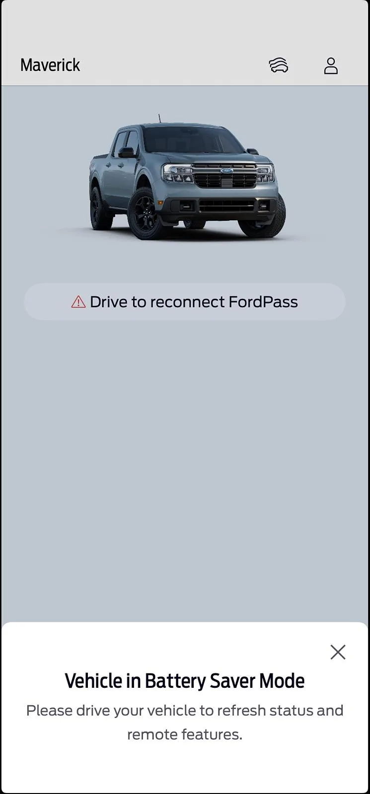

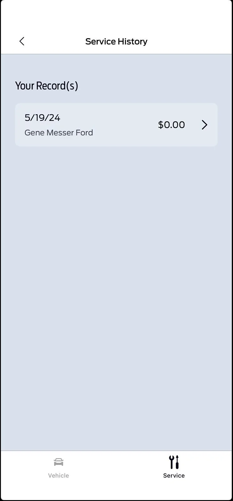

3 week update: Truck still at the Florida dealership, still no reimbursement for flight home and Ford’s offer to reimburse for a rental hasn’t panned out. No one has a Ford available to rent and they will only reimburse if you rent a ford. Not one call from the dealership with an update, usually when I call I just get voicemail which has never been returned. Twice I got through to a human, first one couldn’t tell me anything. Second said they did get the transmission in but couldn’t say when it would be installed. That was last week. So still no eta for repair or getting it shipped back to me.
I keep checking my ford app hoping it will give a clue, but no changes there either. 21 Days since it broke down looks like I’m going to hit at least 30 before it’s back to me.
Ford Maverick Transmission failure under 6k miles IMG_2421
Ford Maverick Transmission failure under 6k miles IMG_2422

Update 32 days, still no reimbursement from ford, no loaner or rental, I was told yesterday thry are almost done with repairs and it could be done by the end of the week. That didn’t happen. Said delays caused by other parts they had to order, after ordering transmission, ordered a transmission cooler line, and then a subframe bolt.
Ford corporate guy also said I’d get an extended warrantee once truck is back to me. We’ll see if that all pans out. He also confirmed I am getting a brand new transmission, not rebuilt.
Nothing has changed on my Ford pass app.
