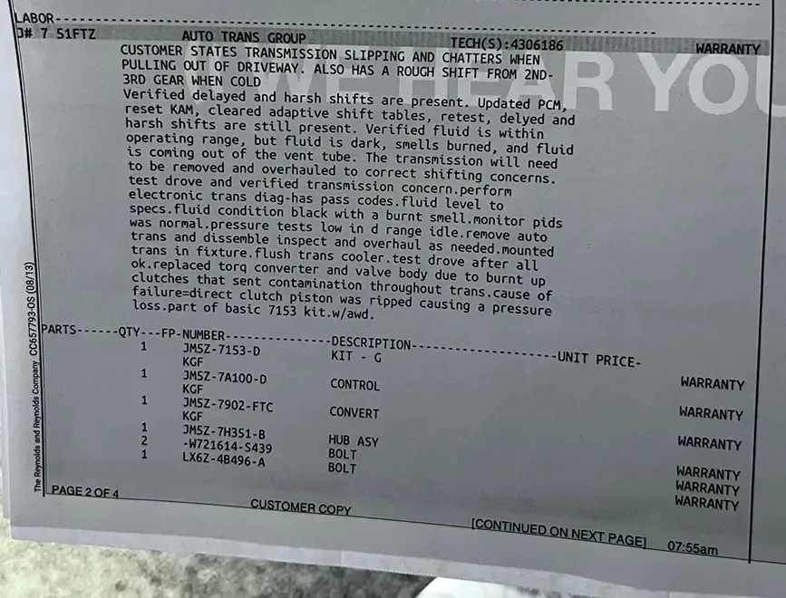

The dealer later called and said the transmission needed a full rebuild. They found a burnt clutch, dark fluid that smelled burnt, and internal contamination.
Fortunately, this was still under warranty, and Ford approved a full internal rebuild without pushback.

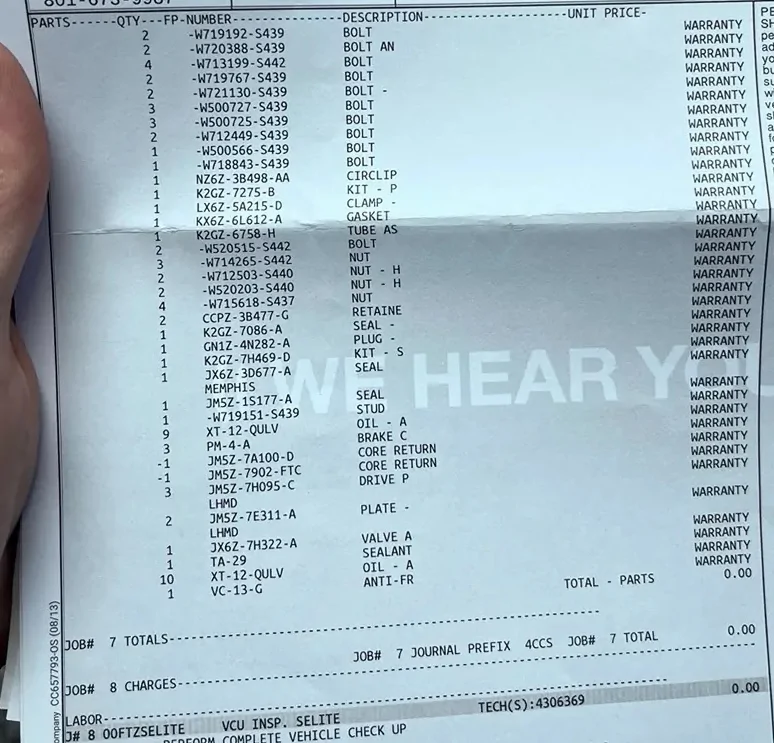

(no way they did a rebuild at a dealership under warranty)
Could you clarify what you mean? I have the documents with all the parts.

I just assume that a dealership would outright replace a transmission rather than rebuilding it. Maybe your dealership has a guy who knows that stuff and can do it.
Or did you mean the part about the computer learning your driving behaviour? If so, when the tech rest the transmission data table while testing it that would remove the learning the computer gets from reading your driving style. The computer would then have to relearn your driving style, which may take a few thousand miles or more, I’m not sure how Fords system does it.

I almost thought their work description sounded like mainly a cleanout of the bad fluid from everywhere, a crack it open flush.
Plus torque converter, and valve body while in there.
I didn't think it sounded much like a rebuild either, no comment on new plates or other items.
Whole bunch of single use bolts!

Way to much of that kind of stuff on the Maverick, what a waste of materials, and needless expense for anyone doing it out of warranty. I could see doing that on a 10 year old truck in the rust belt, but on a newish vehicle, just silly.

I believe they're called torque-to-yield/stretch bolts. They create a predictable clamping force. Once they're stretched, they're no longer usable.
I would assume that Ford wouldn't spec them if they didn't see the benefits from a performance/cost perspective. But I am not an engineer. 😁
