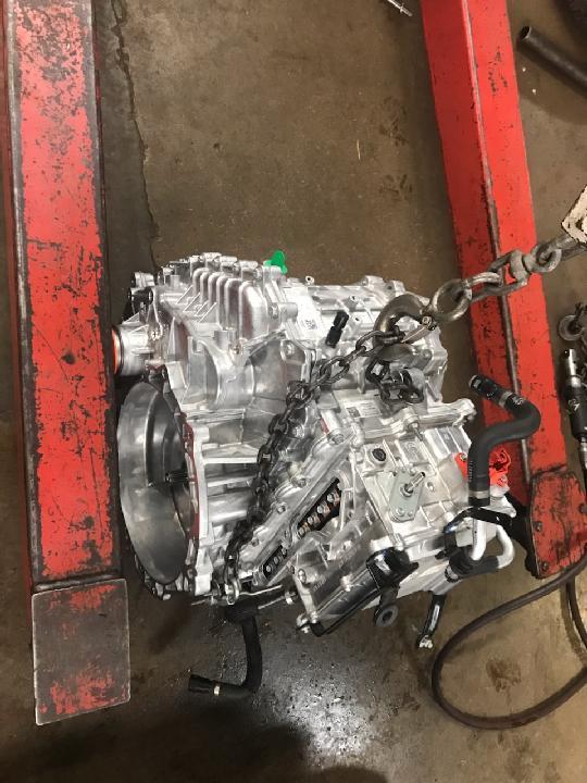

UPDATE: New tranny is in, works great so far, put about 40 miles on it to charge all batteries.
Ford Maverick Transmission Failure Maverick Hybrid eCVT Original Tranny
Dealership diagnosed this morning, tranny failed on my Hybrid XL, lurched to a stop
as i was traveling approx. 35mph coming home from a 210 mile trip Friday 09/23/22, got 10 miles from home.
I thought it was something to do with the 12v battery cable, I wish. Never had a shudder or
lurching issue before this, never had a single issue ever, 6495 miles. I did have the fire hazard
recall taken care of at the dealership but nothing else. Its devastating but I'm gonna hang tough and
roll with the punches, i love that little truck. Just wonder what kind of timeline were looking at
to get the new transmission, hopefully will find out soon.

Exactly, maybe a chinese supplied bushing or bearing eh, new tranny is on its way, 3 day lead time they said.

I will assume they are what we used to call black boxing it. Meaning get a whole new transmission. New transmissions used to come in this black plastic box at GM dealerships. Hence black boxing it. Hope they get you a new one soon. Did you get a rental car?

Low-time in service, less than 12 months or 12,000 miles allows use of a complete unit - after 12/12, have to tear down and do a cost comparative analysis and many times forced to do a repair -- UNLESS, no parts available...If it is going to break, hope within 12/12...

Yup new transmission coming from Detroit, its on its way, i was very surprised that it was available. Going to the dealership tomorrow, they have a loaner for me, whew thank goodness, i thought i was going to have to fight Ford corporate. C.S. said i had to foot the bill for a Rental if it came to that and then they would reimburse me later once the job is done.
