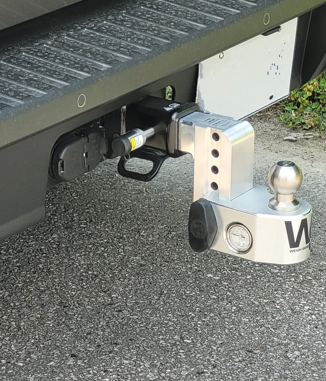

That B&W unit looks good, just wish they'd offer a single 2" ball version. I ain't NEVER going to tow a trailer that needs a 2-5/16" ball.

If you want to buy the best there is the B&W and it's well worth the small price premium.
No doubt that B&W is amongst the best, but I doubt that it's a "small" price premium.
I suggest @sanpablo get the coupler heights and ball sizes of the trailers, and then choose something. A $30 Towing Starter Kit from U-Haul might be all that is ever needed, compared to $250+ for a B&W that @sanpablo will rarely use.

It's a small price premium over competitive adjustable ball mounts with multiple balls. As you noted its not price competitive with a simple non-adjustable (but flippable) ball mount with a single ball.
There is also an inherent safety issue with any ball mount without height adjustments and that issue is so obvious that we don't even think about it. If you show up at a rental place with a ball 18 inches off the ground (perfect for a U-Haul trailer) and the wood splitter you are renting tows level with a ball 12 inches high (typical for wood splitters and small construction gear) what are you gonna do? The majority will simply say "oh well, good thing I'm not going too far..." and tow it away.
And that wood splitter is going to be wagging back and forth behind you at any speed.
