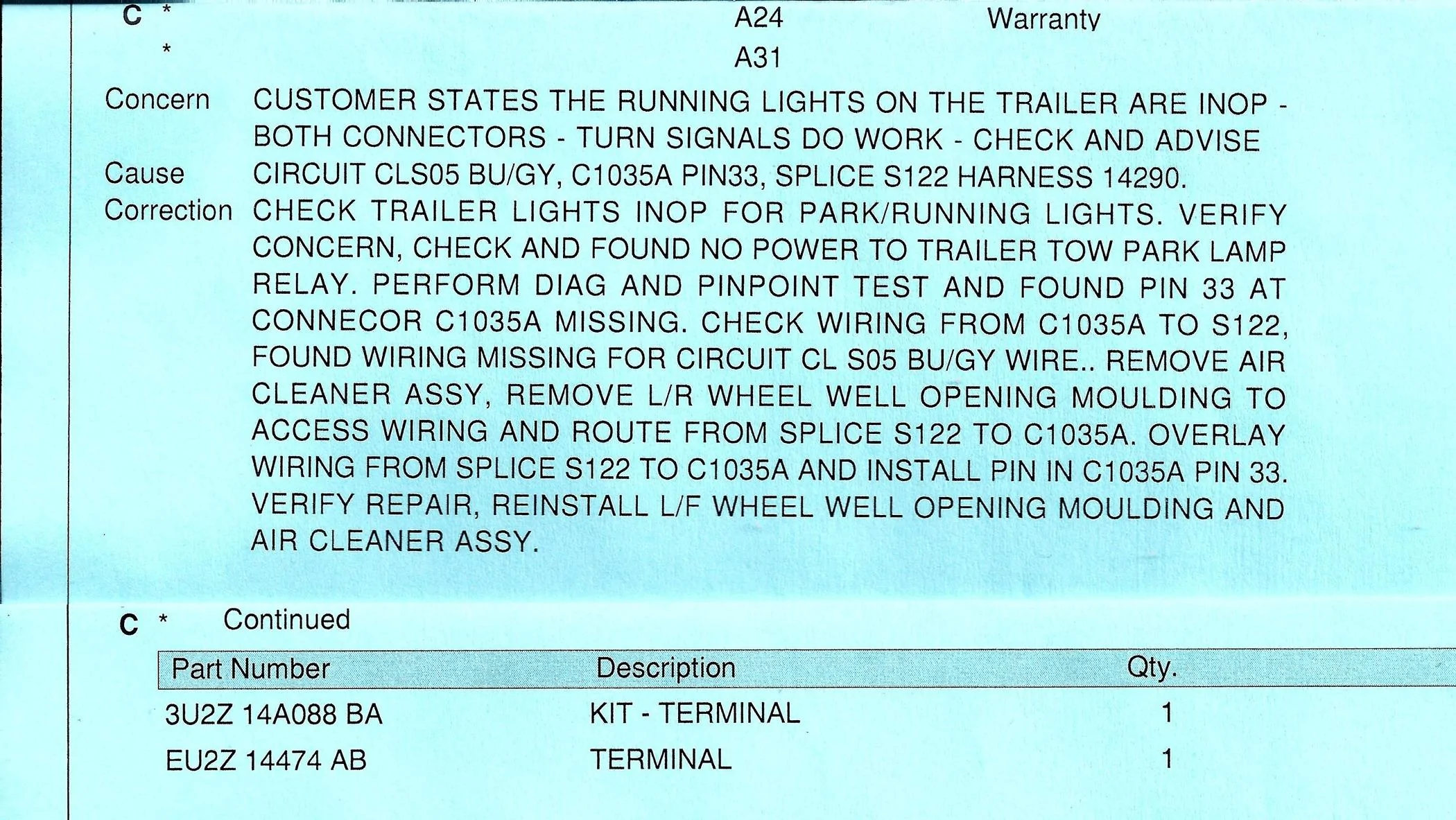

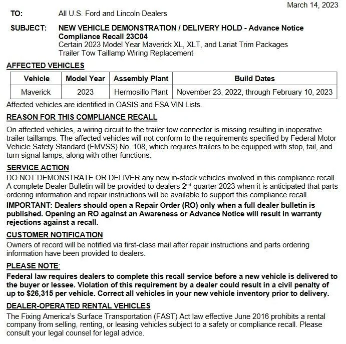

There was a recall I believe for this. Not sure if the attachments are relevant but take a look
Ford Maverick Trailer hitch problems 2023 recall notice 3-14-23
Ford Maverick Trailer hitch problems Maverick trailer light repair

UGA beat me to it, I discovered this back in Jan 2023. Check your VIN # to see if the recall covers your build.

There was a recall for this,which was done before I picked up my 23 maverick in May of 23.
