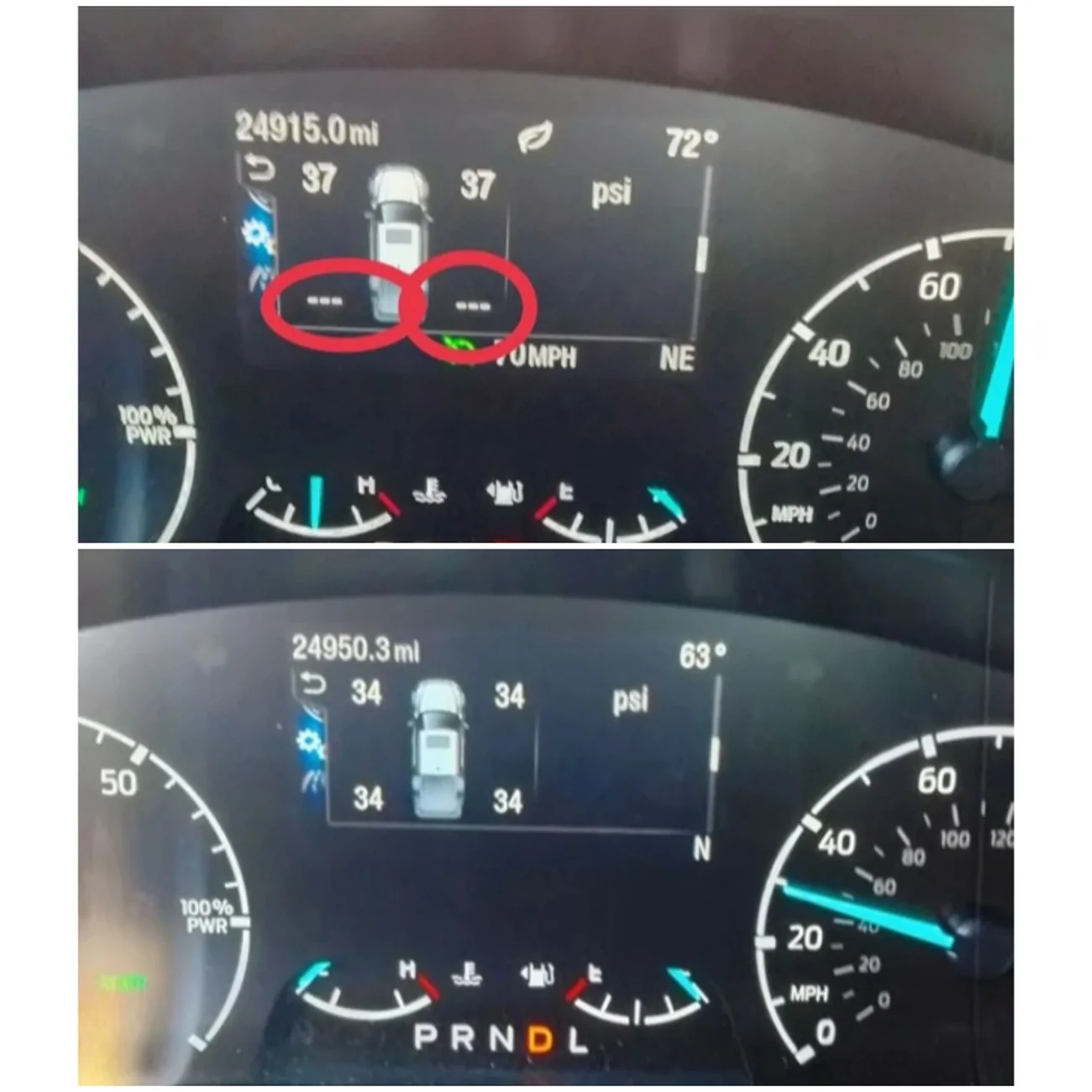

My 23 drops random TPMS quite frequently. On our fourth of July trip last year. It became a guessing game, which one it was going to be.
Sometimes two at once. All good 35 miles later Like magic. They're both working again.
Ford Maverick TPMS BAD 20260713_082328
The sensors are perfectly fine. They always comeback with 20 miles.
I attributed to the cheap computers or terrible software.
