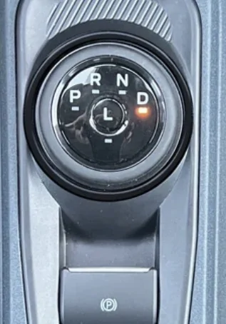

Find out almost 2 weeks ago. On my 2024. They tested it. I have problems getting stuck in Reverse. When I turn off the truck, than be try to start it. It will not start. Then move it to park than it will be fined every 2 months it do it. I tell my ford dealer to test it. Turn out when they turn back bad. And parts was on back order. Finally the parts come in. But I miss my truck, they have it for 2 days now. They say it will be ready tomorrow morning.
Ford Maverick dial shifter went bad IMG_0174
