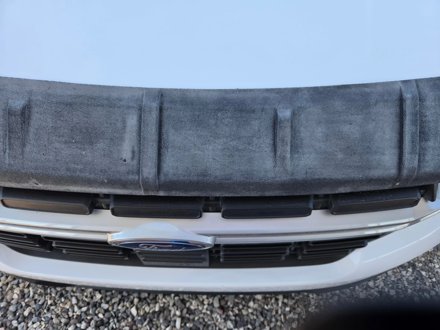

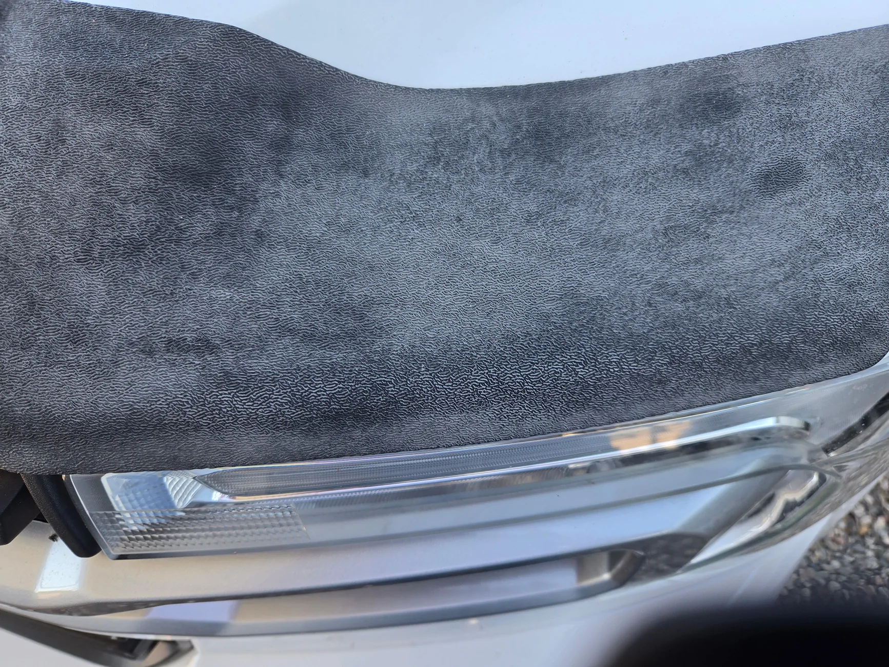

Purchased in Dec 2024, did not last 2 years in the Arizona heat and sunlight. I've tried "back to Black" and Armor-All to no avail. The material seems to suck up the liquid protectant but by morning it's back to ugly. I'm going to remove and replace with paint protection film. More expensive yes but it should last.

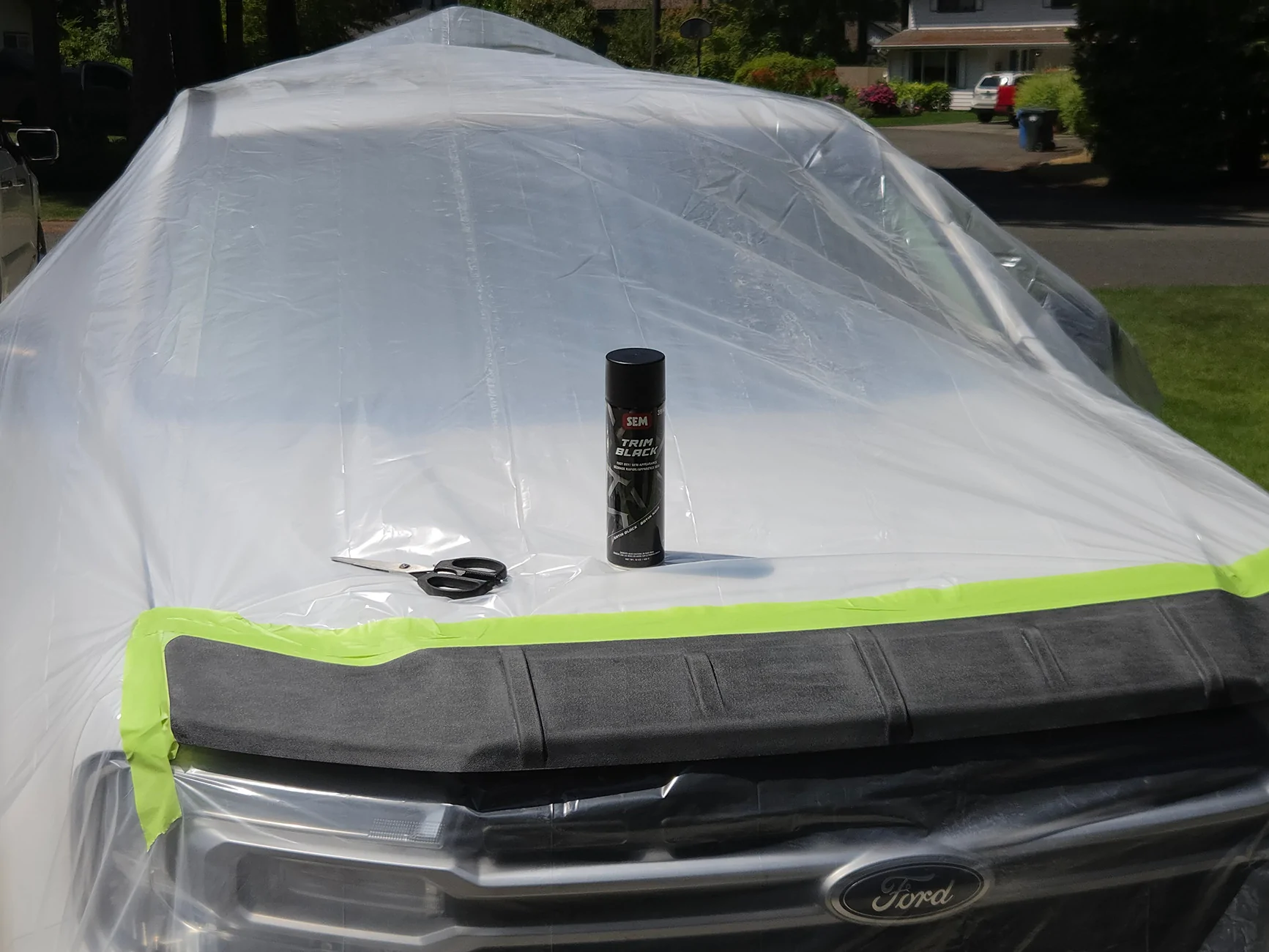

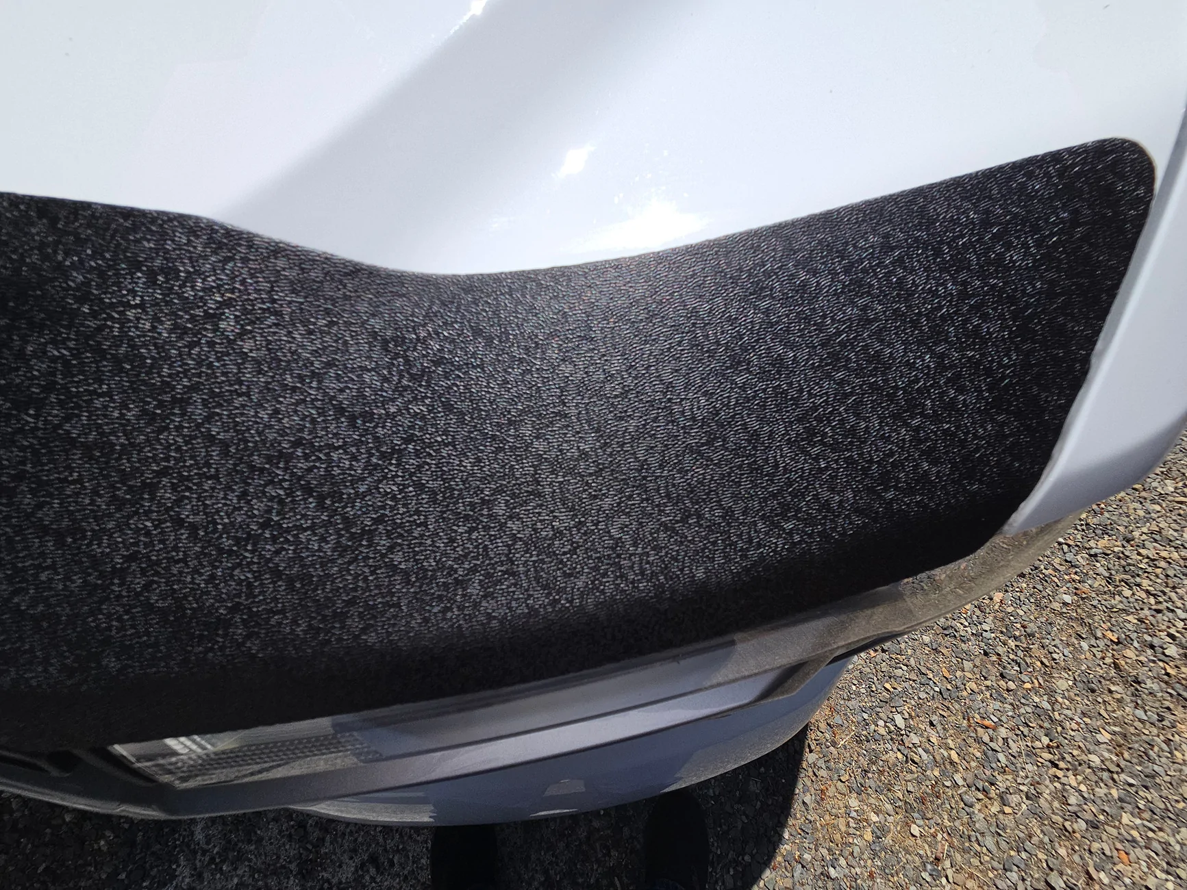

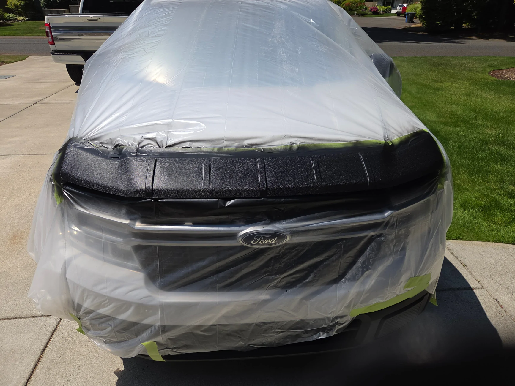

OK, Folks here is the final result for the Chinese hood protector:) As stated above my son is a 30+year helicopter tech. His suggestion was to use the SEM Trim Black, so that's what we did. The results speak for themselves. After washing twice with scotch brite and a good grease/oil remover then wiping down with alcohol we covered the little "Nanny" truck with plastic and proceeded to paint the hood protector.
I'm happy with the end result but the real test will be how well the SEM Trim Black holds up the Arizona desert heat and sun.
