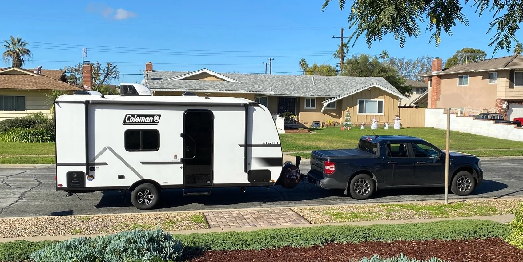

Mumbo Jumbo. Does not match real world scenarios.
I put my truck / trailer combo on a three axle scale with people in the truck to get actual axle weights.
Facts:
Front was a little HEAVIER than the unladen curb weight.
Two big adults in the front seats and luggage in the rear seats was pretty far forward of the rear axle. More so than the trailer is rear of the rear axle.
My trailer has brakes. My Maverick brakes about the same with the trailer attached as without. But I always brake early just incase.
You need to enjoy your hobbies. If you are a worry wort you probably never leave the house.
