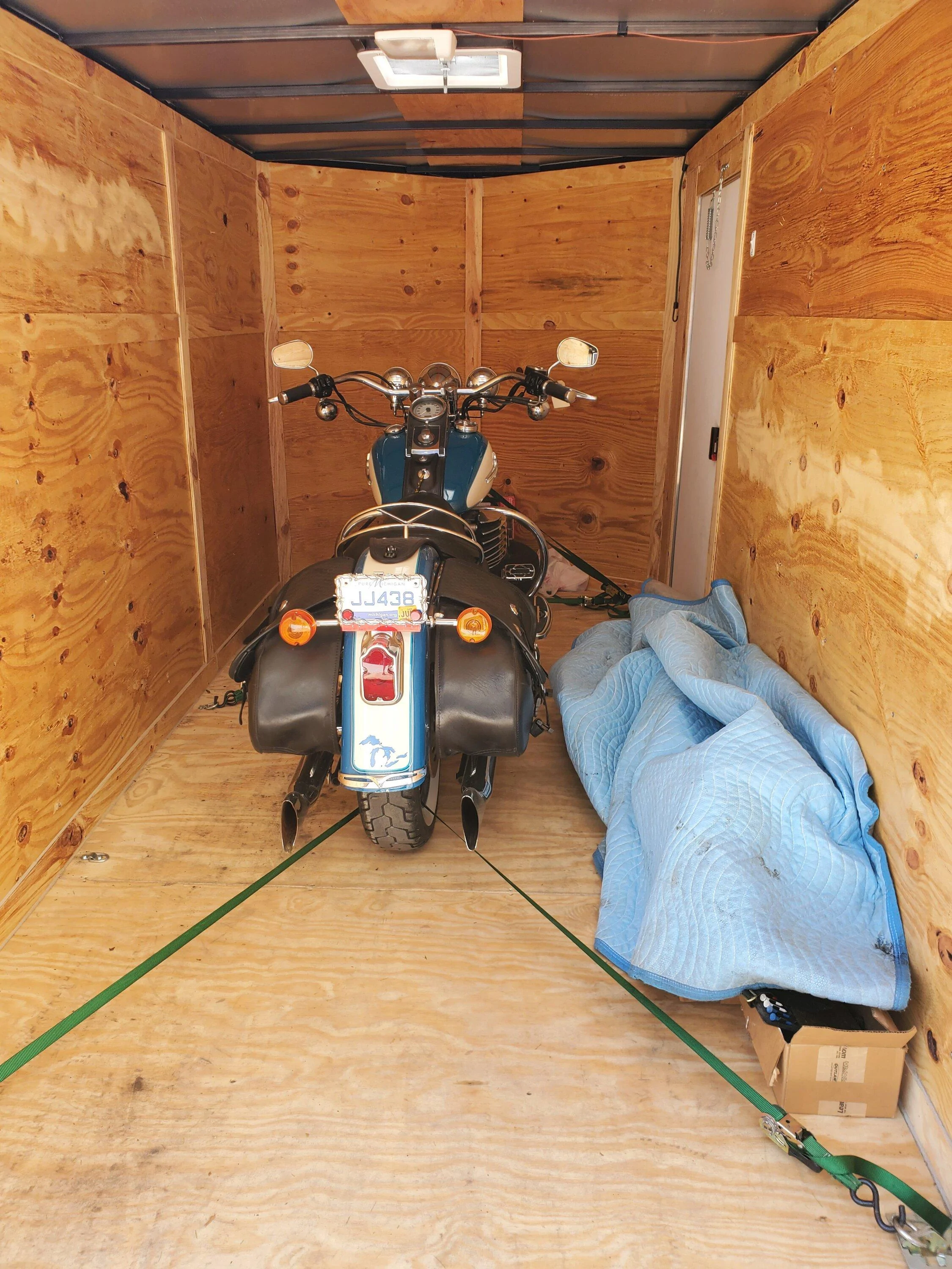

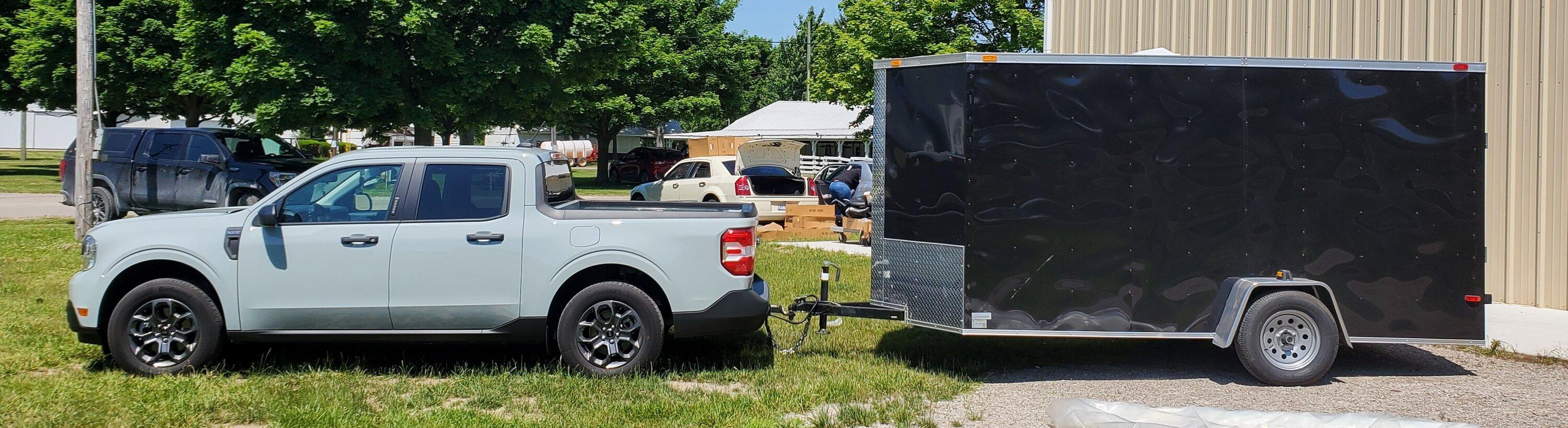

I towed my 6x12 enclosed trailer 100 miles this weekend with my hog in the back, maverick hybrid. Avg 23 mpg on 55 mph roads.
I'm looking to haul a similar trailer, what was the weight if you know?
