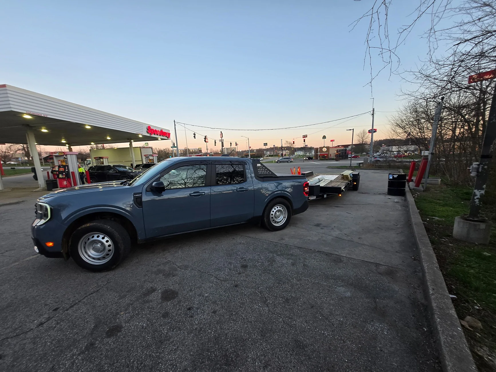

My truck is in the body shop for repair (for over a month) after someone clobbered me, which is a separate thread if I choose to tell the story. When I took it in on April 6, the shop ran the VIN and told me there was a very recent recall and update for trailer lights becoming inoperable (2025 XL 2.0 ICE w/ 4k tow pkg). I did confirm the existence of the recall on-line later that day. Has anyone here needed to address that issue, and was the update successfully installed via wireless, or did you need to take your truck to the dealer? I am gong to need to tow not long after get the truck back, and I need to plan ahead if I will need dealer intervention. Thanks.
I had the dealer perform two recalls while I was having some sloppy trim work corrected. One of which was the towing recall, and I do tow heavy at times. Trailer brakes are a must!
I'm more concerned with the brakes giving way 25% during normal braking which requires a sudden need for heavier brake application while not towing. It's a very uncomfortable feeling when the brakes suddenly glitch and let loose affecting stopping distance. I'm at 30k miles and bought the FORD ESP to 100,000 as I suspected bugs with this truck. This week I noticed there's no 120vac power.
Built in Mexico 🇲🇽 ! Cheap labor isn't good and good labor isn't cheap.
