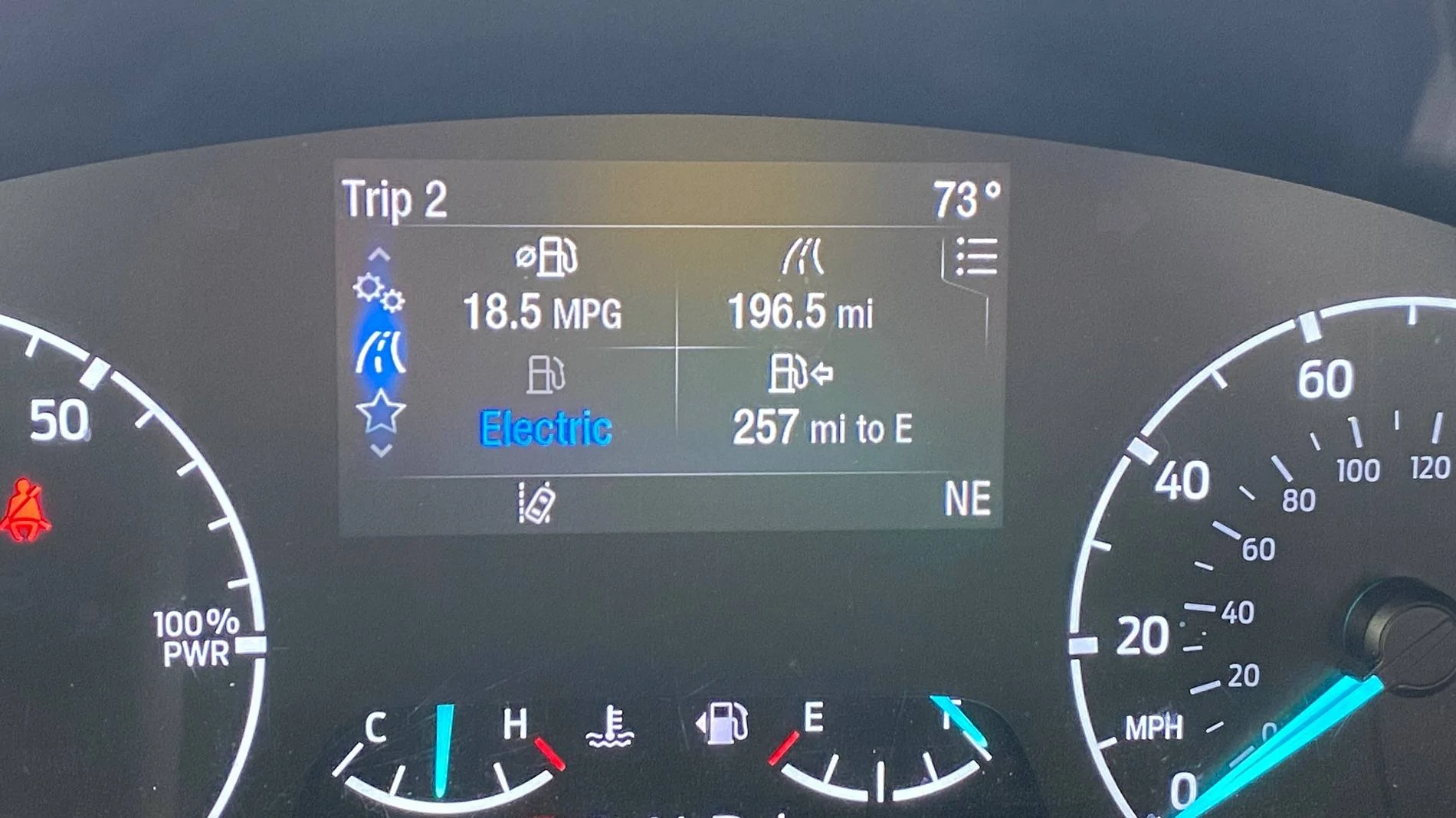

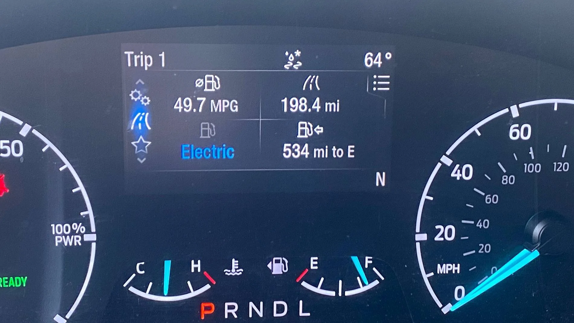

MPG will be 3-4 MPG better than the Ecoboost while towing. 18-20 MPG at 65 MPH.

Not towing / 65 MPH 75% with city 25%
Ford Maverick Update after 3 years and 49k towing miles IMG_3418

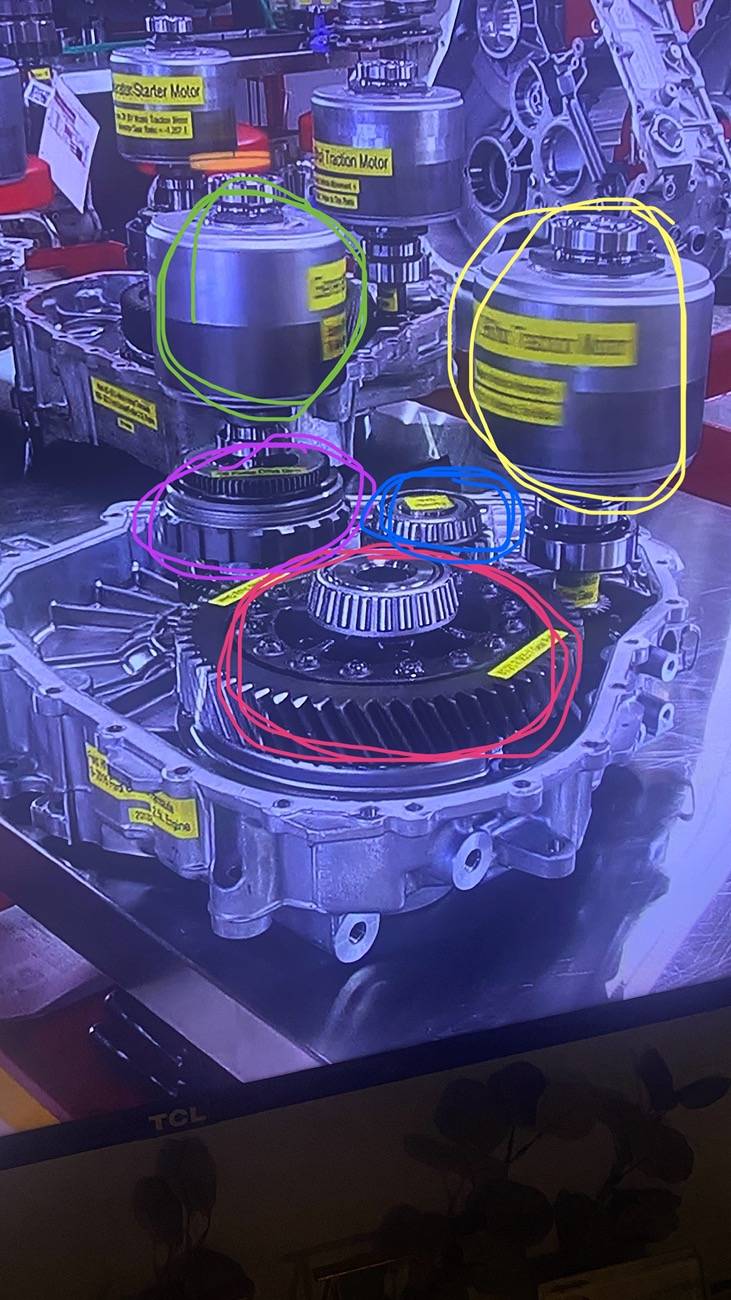

Hybrid transmission. Look at those beefy gears ALWAYS in mesh ALL the time.
Big (red) is your power output to the wheels.
