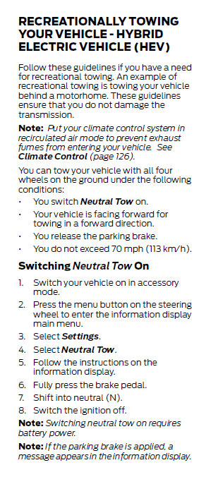

I'm not going to doubt you, but where did you get your information? Are you a Ford employee? The instructions state run for 30 minutes or drive it. If over heating the transmission is a reason then Ford should include it in the manuals instructions for sure. I would say that's a pretty major discrepancy. Because they clearly say it's to charge the battery.

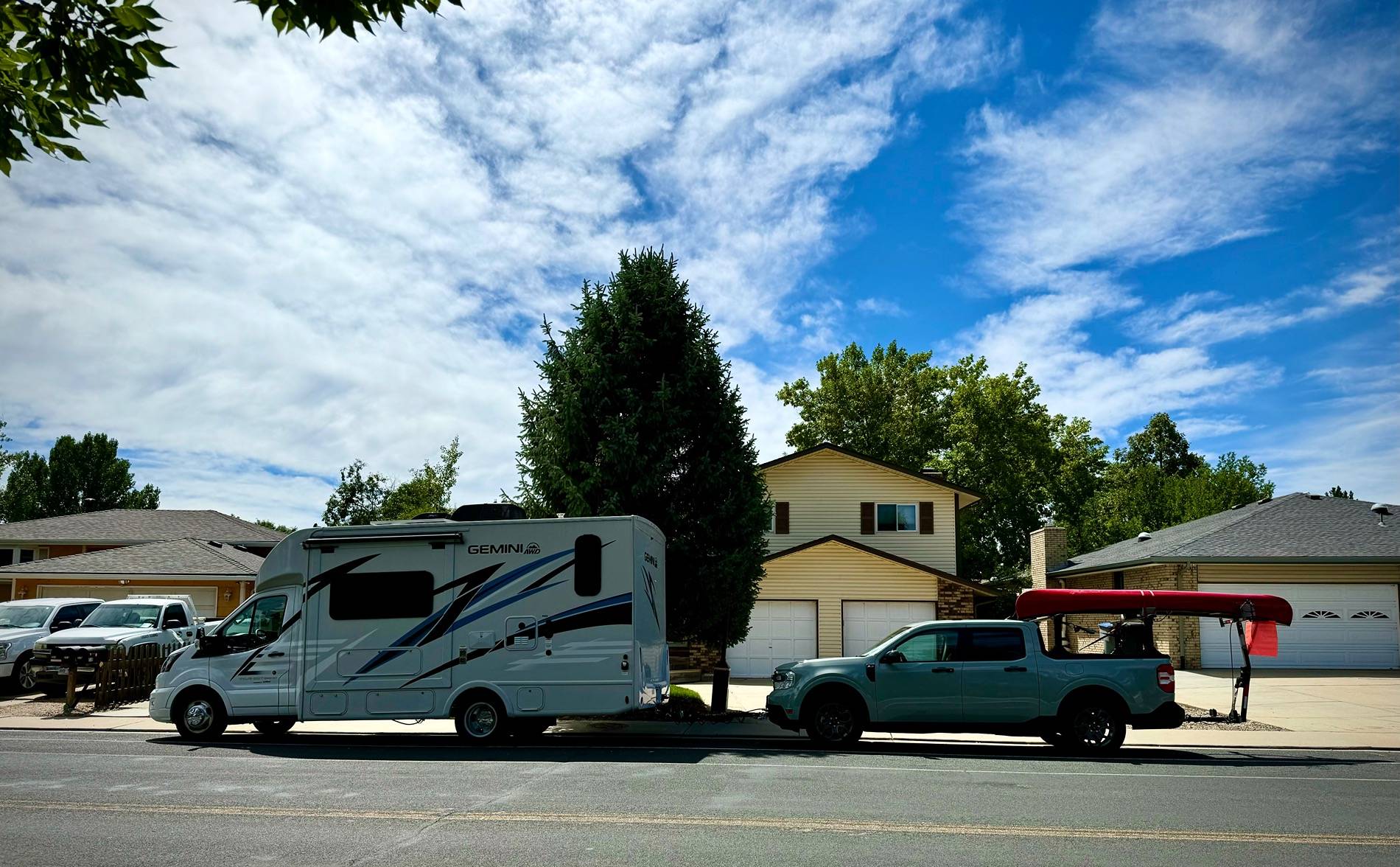

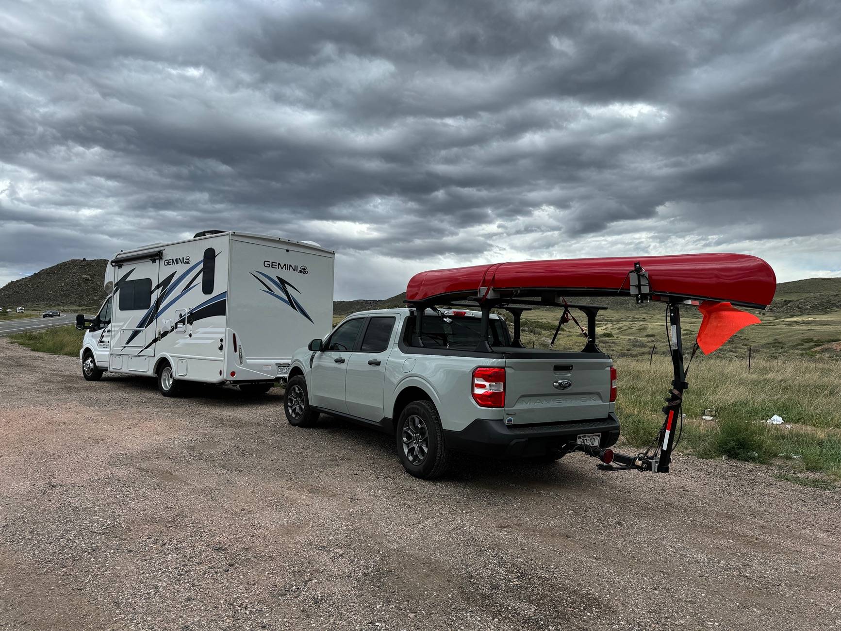

I personally don’t drive my RV more than 4-5 hours straight without taking an extended break or stopping for the night at anytime - I have a charge line so it’s not about charging the battery. I’ve never had any issues with the Maverick it a great toad
