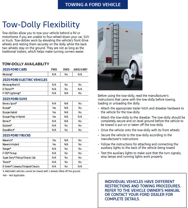

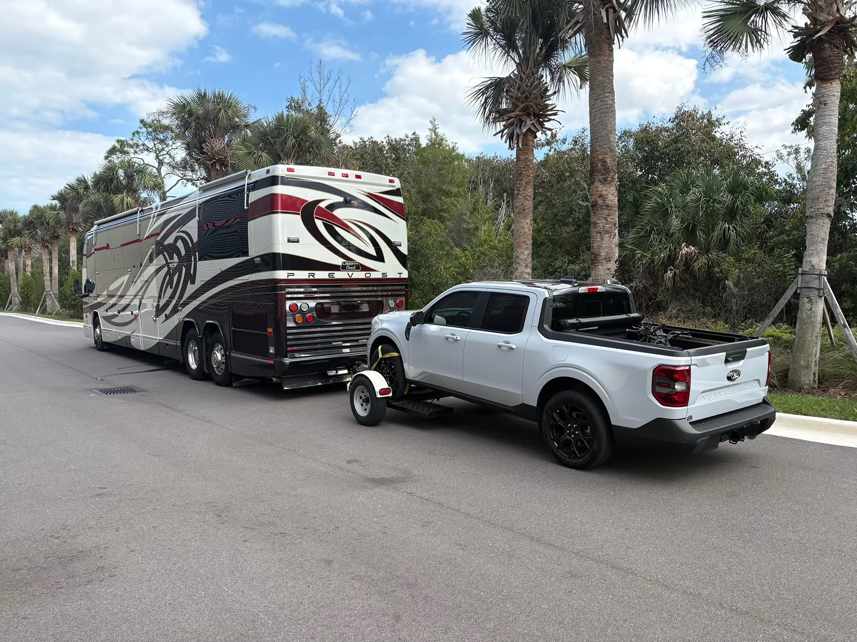

As an update. I took the rear driveshaft out when the truck had approximately 500 miles on it and it has just under 4000 miles on it with probably 200 miles of being towed behind my rv on a tow dolly. There hasn't been any lights or warnings or even a single issue at all.
Ford Maverick Dolly towing a AWD ecoboost IMG_0601
Howard
Howard
Jul 17, 2023
174
227
Indiana
24 Atlas Blue, 2015 Escape
That's interesting that they say "no" to dolly towing an AWD hybrid when it can be flat towed.
Without the front axles turning when on a dolly, the bearings for the rear output shaft may not receive the lubrication needed.
This is the case in a 4WD with a Dana 20 transfer case. The bearing for the rear output shaft is above the lube level and depends on oil thrown up by the front shaft which is down in the lube, but it would not be turning when using a dolly. Again, flat towing is safe.
