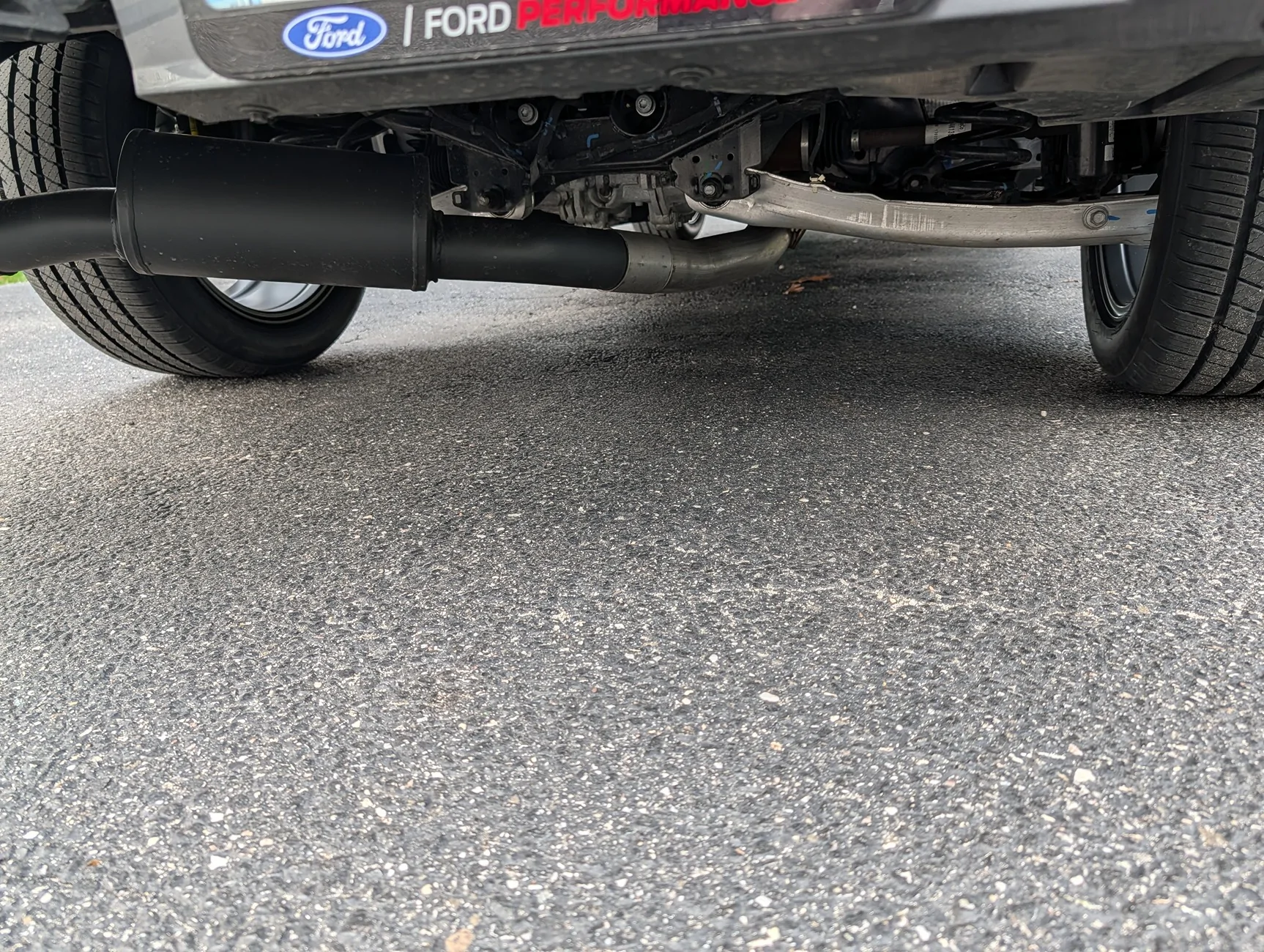

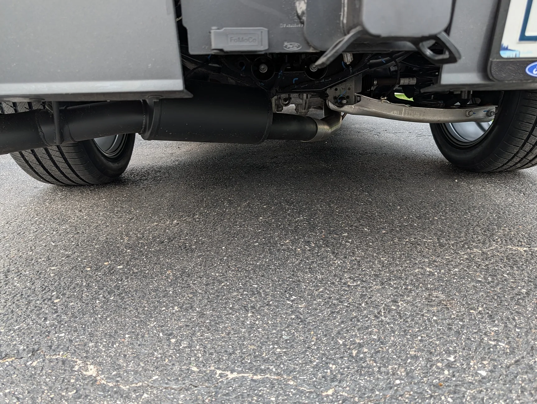

Does anyone else's thermal exhaust hang really low in the back?

I feel like mine could be a little closer to the differential in the back. I don't know if rotating the mid pipe section would help. I've been waiting for it to warm up by me to give it a try.

My lobo is lowered and the exhaust hits way too often. I'm thinking along the same line as you are.

How close is the section to the driveshaft (assuming its AWD). I positioned mine about 1/2" clearance. I also rotated everything slightly for more clearance.

It is AWD, it's about an inch. I'm about to crawl under for the 3rd day in a row lol. Ramps only get it so high tho

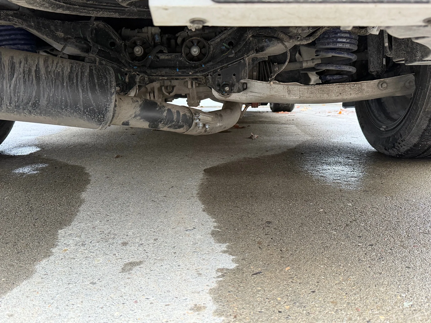

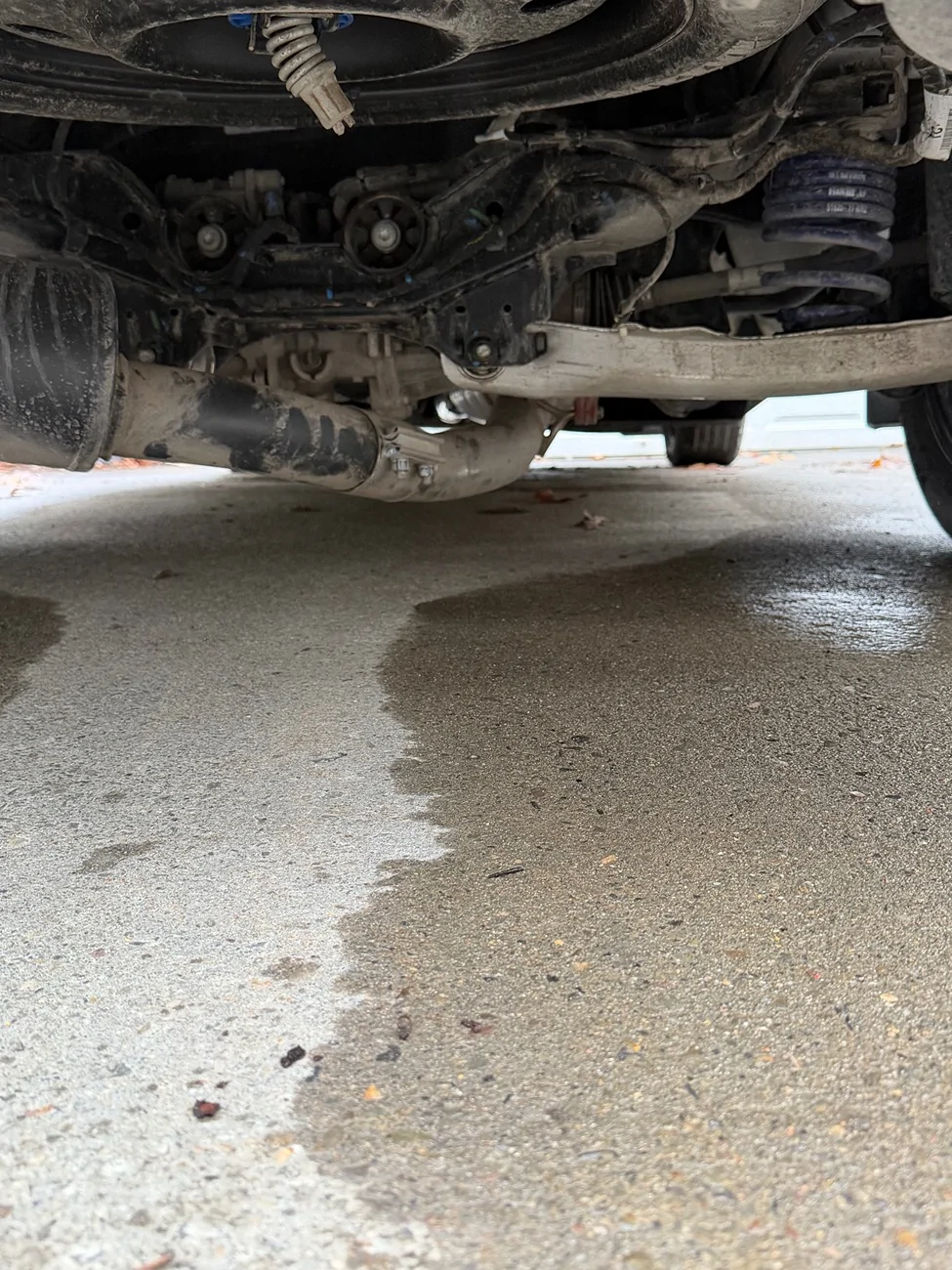

I finally got the weather today to swap out my AFE Rebel Side Exit for my new Thermal. Install went OK, just a lot of fiddling with adjustments. I've never installed a cat-back (and I've installed a bunch of them over the years) that just butted the pipes and used band clamps for assembly, all the other ones have used slip fittings. One word of advice to anyone doing this in the future: order a 2-1/2" ID to 2-1/2" OD band clamp for the front connection; I didn't get a perfectly square cut when I cut the pipe from the cat and I couldn't get that joint to seal properly. Luckily I had an Evil Energy one left over from another project that worked perfectly. I also ran it as close to the rear diff as possible, so I had to "dimple" the pipe in one spot where it was very close to one of the bolts on the RDU.
This setup sounds very good, a little loud at startup, but chills out once up to temp, and quieter than the Rebel all the time. We'll be taking it on a little trip tomorrow for Easter and we'll see how it is, then I'll roll it back up onto the ramps and hit all the connections again.
All in all, a very nice sytem with the sound I was looking for, in spite of the questionable butt joints.

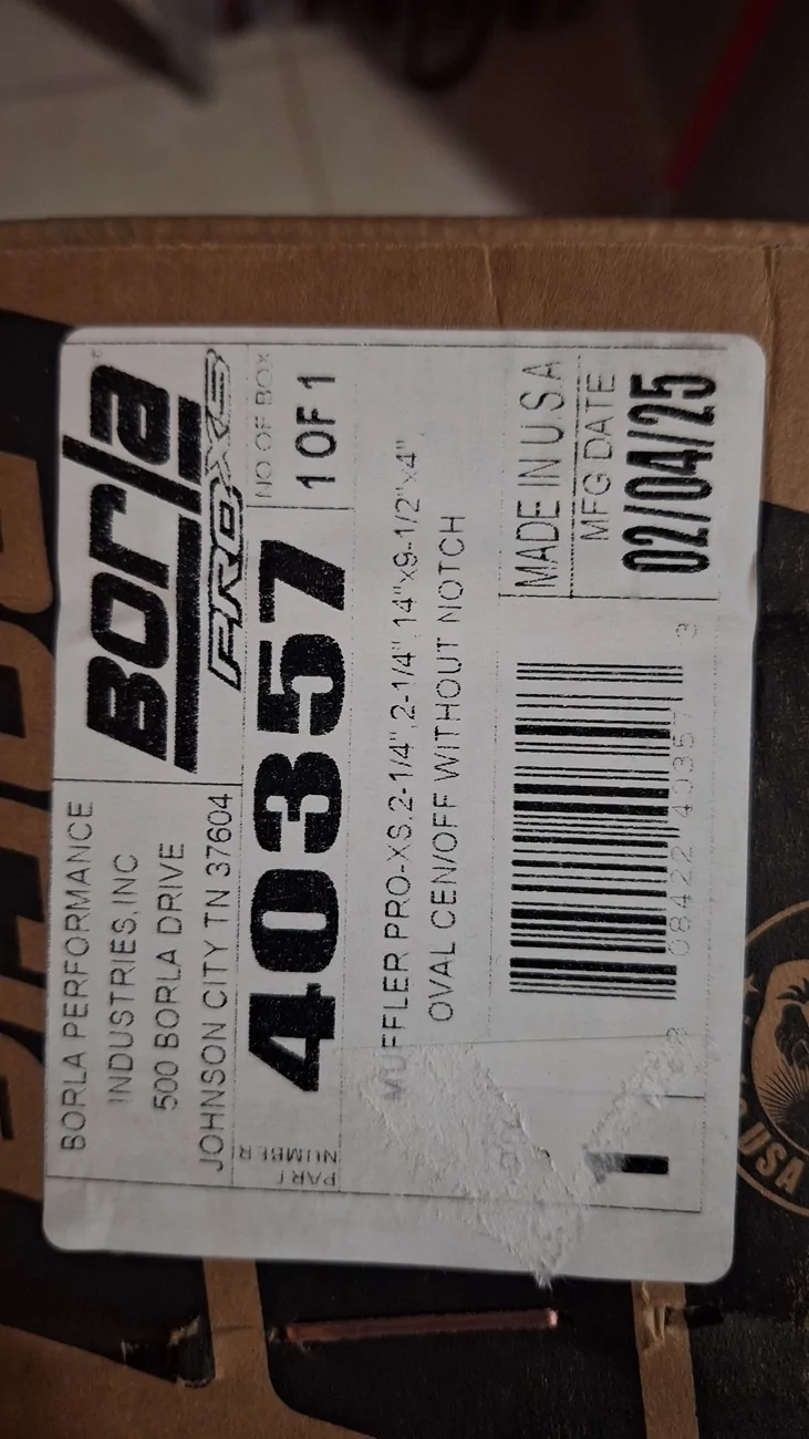

Borla Pro XS series! Sounds good enough
If I want a little different sound I would go with that Borla Muffler or the MagnaFlow although the Borla is cheaper at Summit Racing that's 30 minutes from My House.Although maybe it would be to loud compared to the stock Muffler. Is Your Maverick Tremor a 2024?
