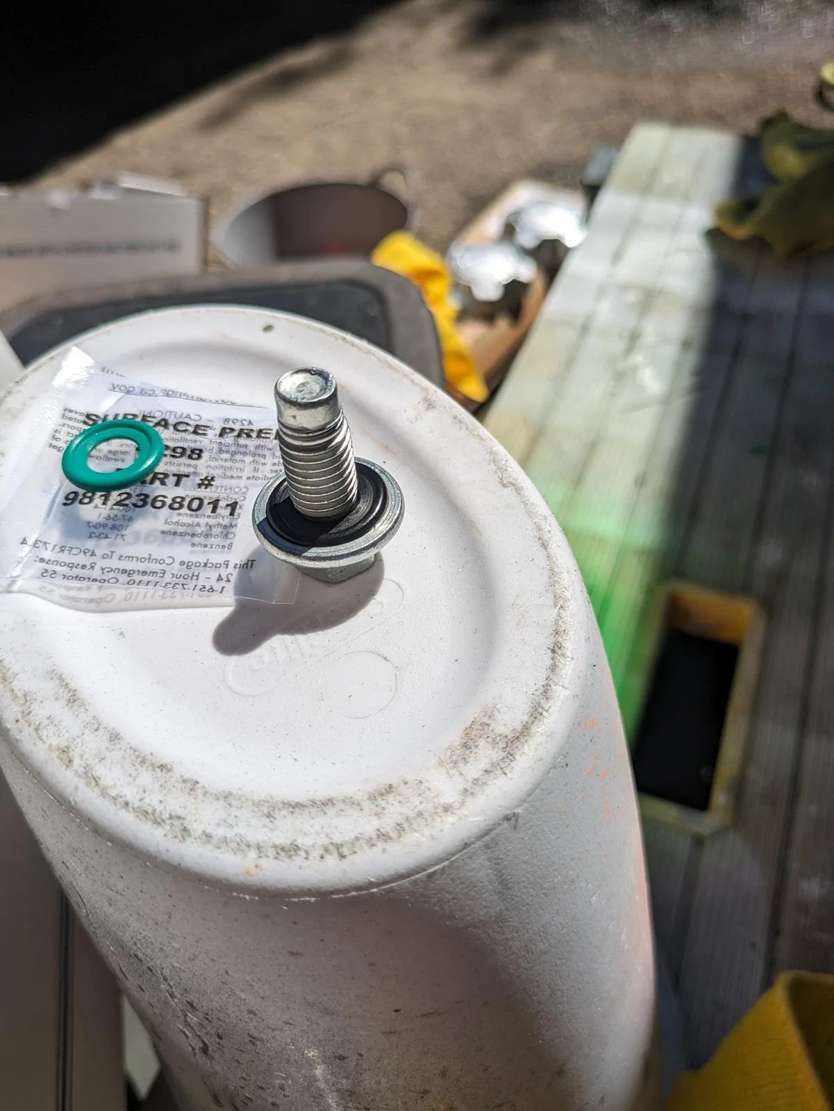

Tell me more about these gaskets you bought - the drain plug has a green oring built into it that is apparently reusable for quite a few oil changes and seals up nicely.
You see the black one, I got from amazon - seller is Keeraorin - m12 rubber 15 pcs.
Hi. I am about to do my 2nd oil change on my '23 Hybrid.
I have been pulling my hair out trying to find an actual match on the gaskets.
It's so stupid that Ford doesn't just provide a replacement gasket part number as eventually that rubber will wear out..
There was a small tear on mine that I noticed when I did my initial oil change.
I re-used it since I didn't have a replacement.
Can you please provide an amazon link to the exact item you purchased? I cannot find a match on Amazon with what you provided.
Thanks!

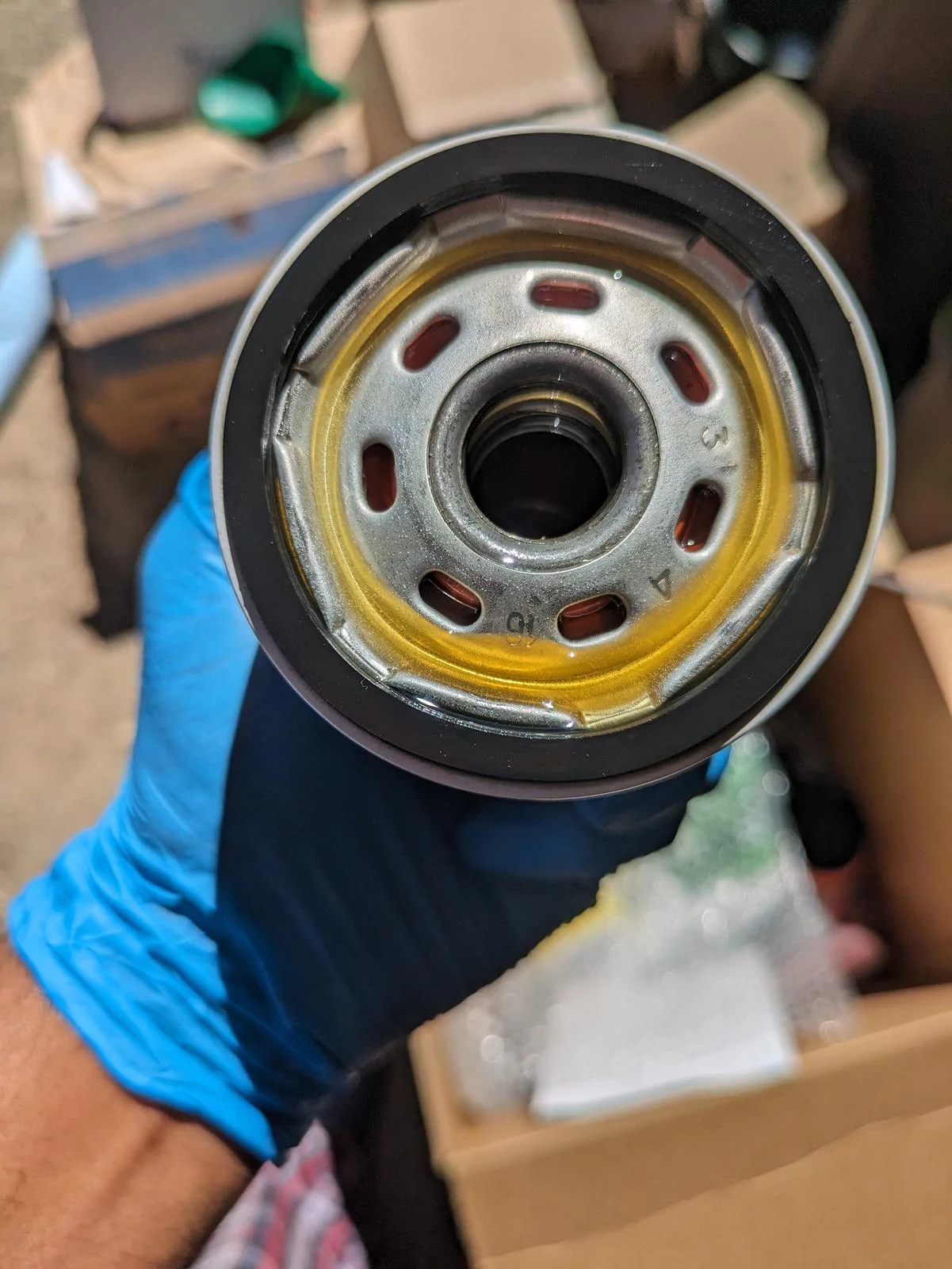

So, I did the oil change at 1050 miles. The filter was not dirty at all and seemed that it can take another 4 thousand miles.

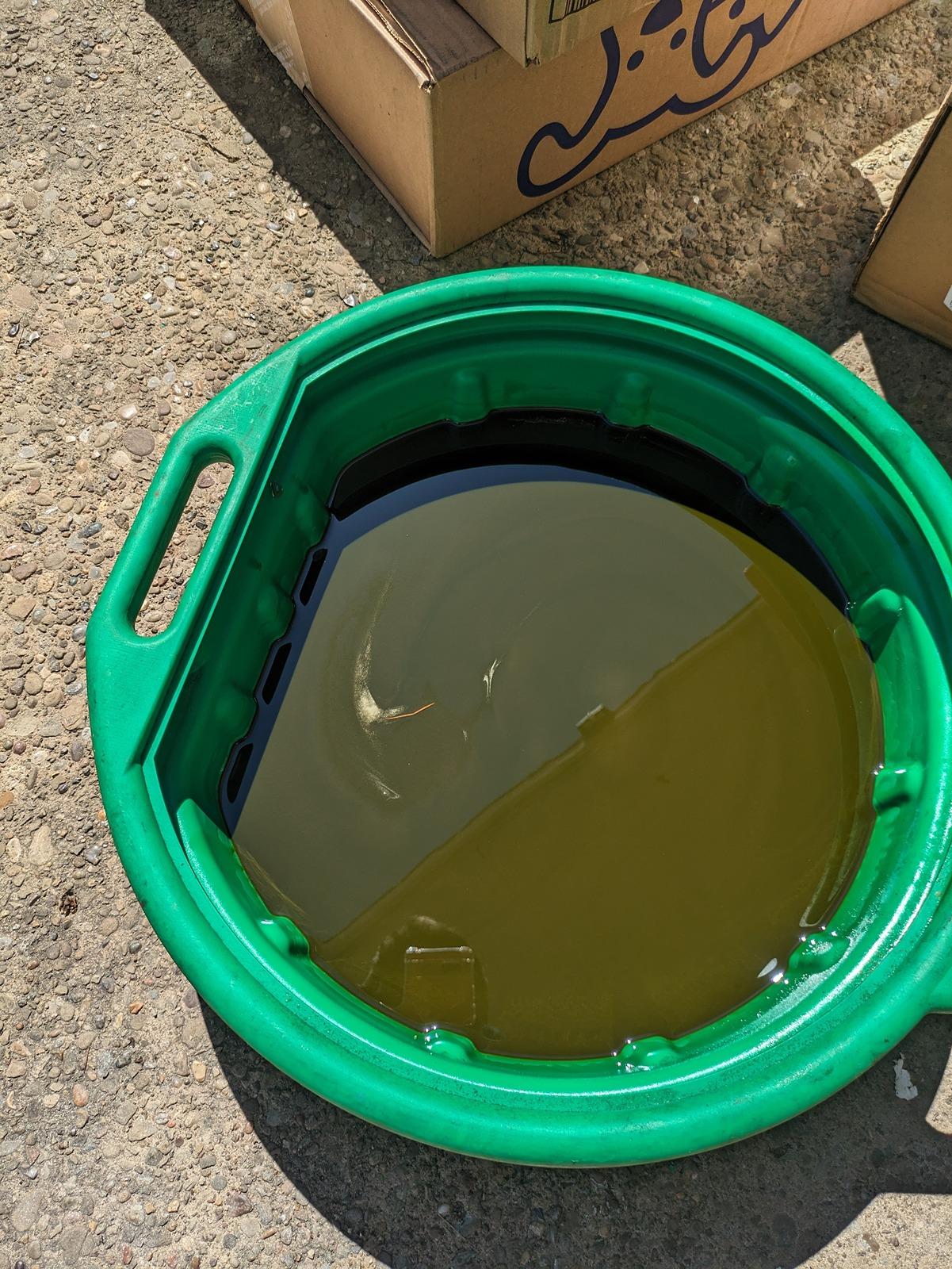

The oil looks green but not sure how dirty as I have never seen greenish oil before.

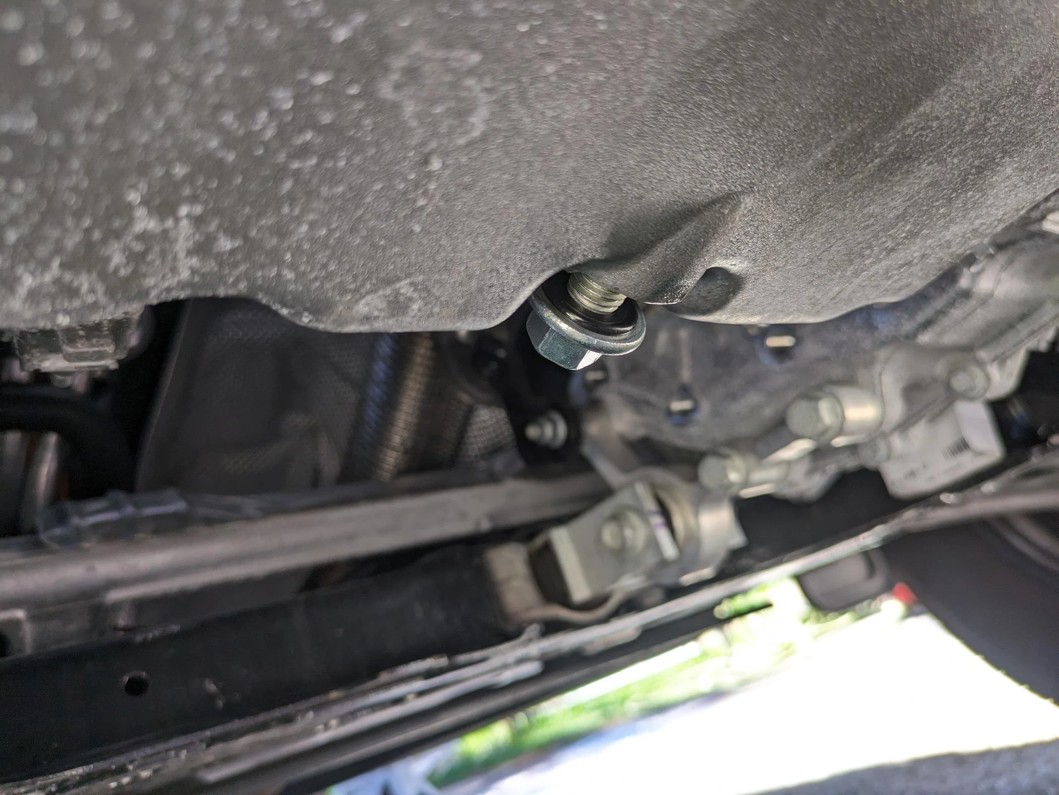

I used new gasket bought from amazon - 15 for $6. Had the gas engine on for several minutes and there was no oil leak.

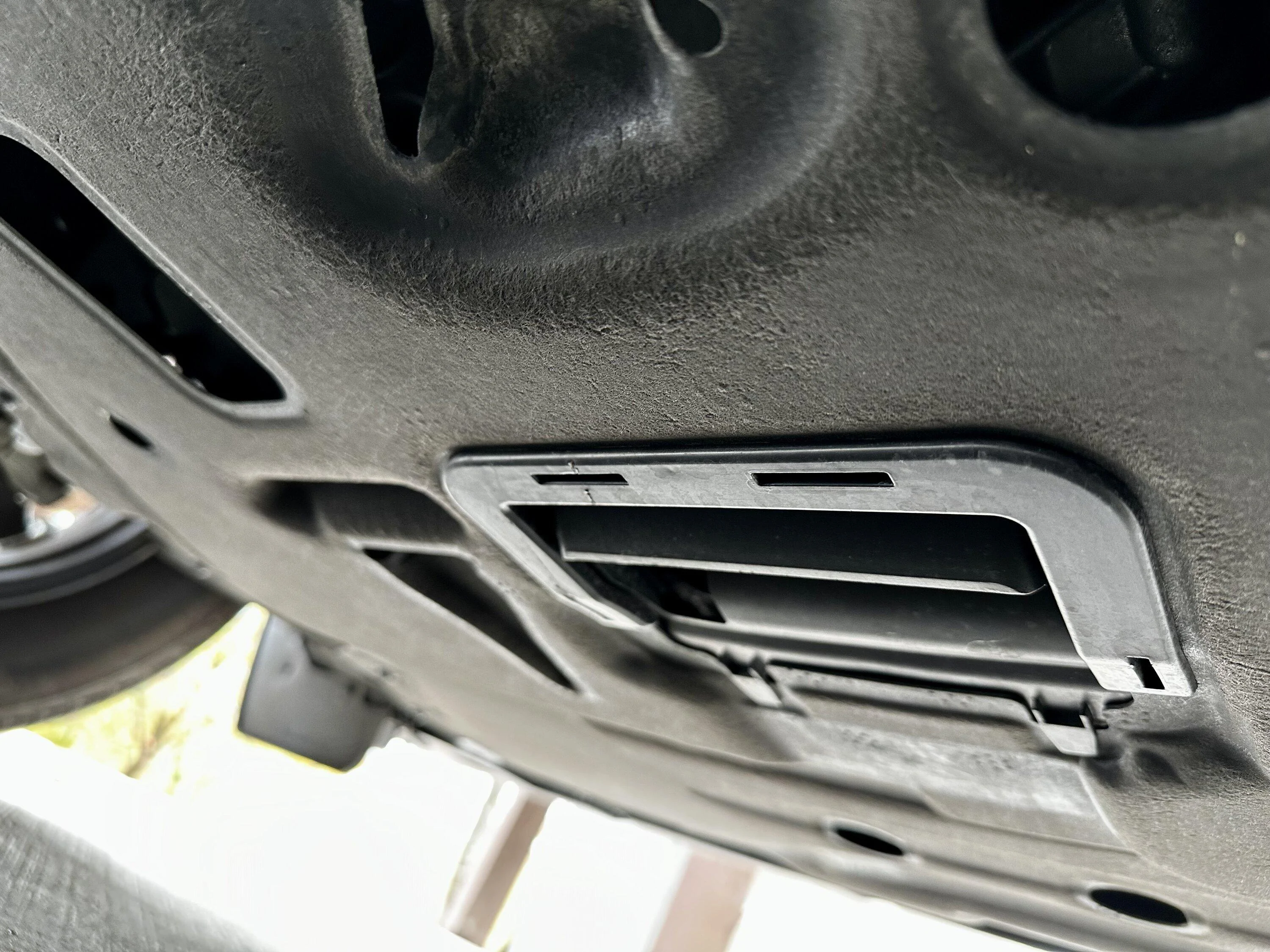

The process was fairly simple. One question - there is no enclosure in the middle of the under cover?
