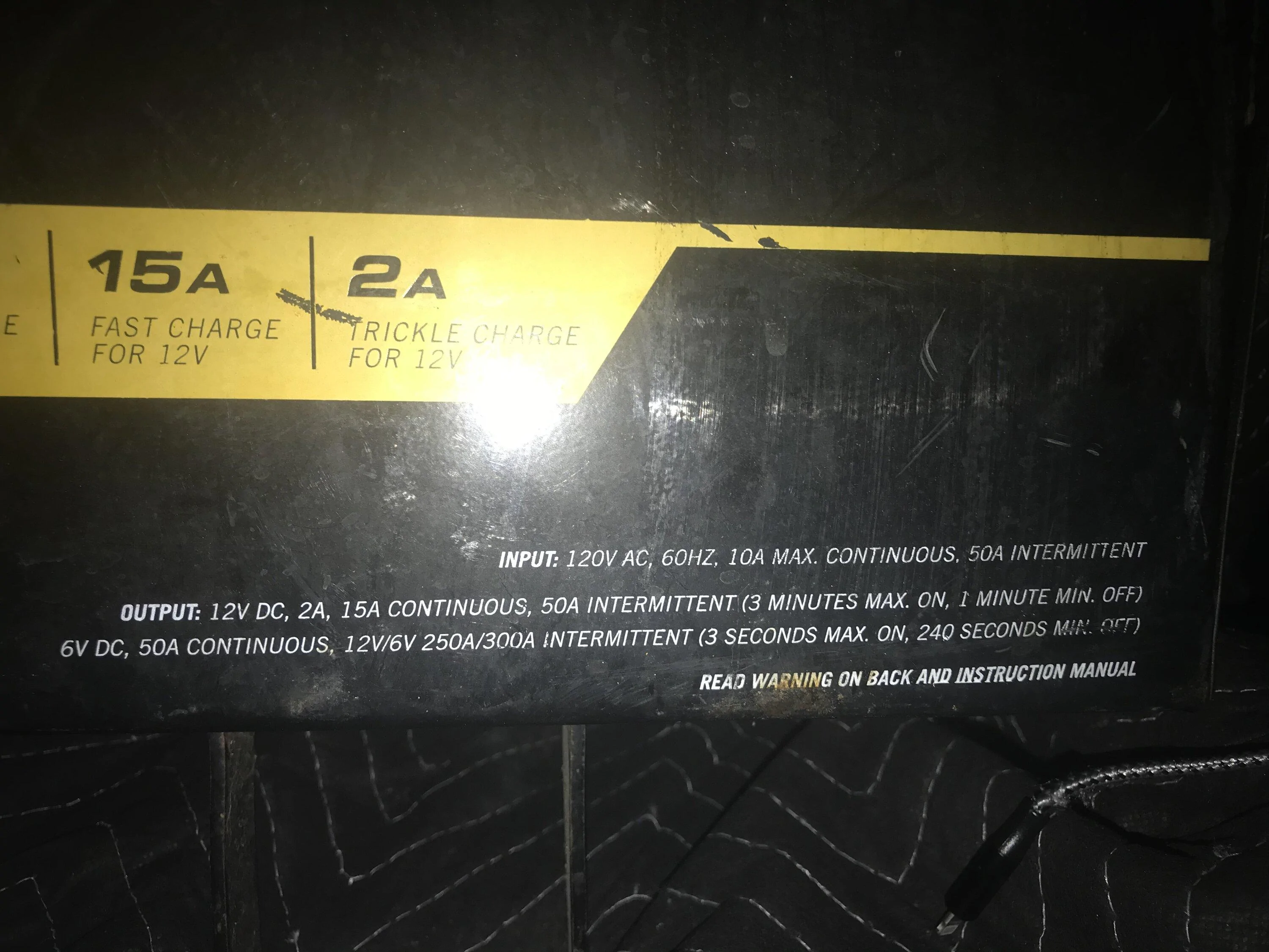

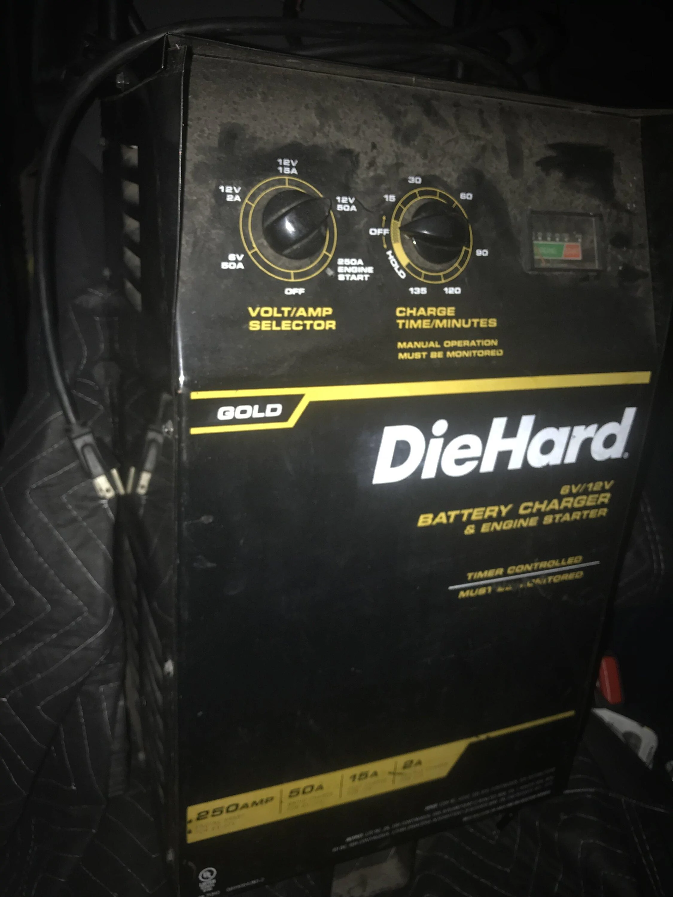

Can my factory 400W backseat plug be used to power this battery charger? I have a 2023 Hybrid XL.
If so, should my Mav be on or off during the charging?
Thanks so much in advance for the help!!
If you have a trickle charger, maybe.

...however, if you have all day and all night you could set the charger pictured to the trickle setting that shows it uses 2 amps...
About the best use I have found for the outlet is to power the charger for my Milwaukee 18v & 24v power tools. At 400 watts it won't power a blender for tailgate parties. It will power my LED work lights.
Sure would have been nice if they would have made it 2kW

One thing overlooked here...is that the jump start in the picture is the old style with the large wound transformer in it.
For it to put out 15 amps.....it probably uses at least twice that much input power. There is significant loss in these when converting 115 VAC to 13 VDC.
The new "invertor" style battery chargers have much less loss.

i believe that the maverick inverter is modified sine wave as well. There are a few things that don’t like modified sine, microwaves, some clocks, and some battery chargers. Looking at the age of the charger, you could damage it from the “dirty” power of the inverter.

Based upon the responses on this thread that overwhelmingly expressed skepticism about it…. I decided waiting to plug the charger into an warehouse outlet the following morning using a 100ft extension cord would be the more prudent move…… So that is what i did. Isuzu started right away and I got it safely stashed away into hibernation….. problem solved.
DEFINITELY was fearful of “popping fuses” and possibly damaging wiring/electrical on my immaculate Mav…..
FWIW….. that old Die-Hard battery charger is AWESOME and has always worked spectacularly!!

Those old chargers were workhorses. Just have to be careful because I don’t believe they are automatic chargers and can boil your battery.
