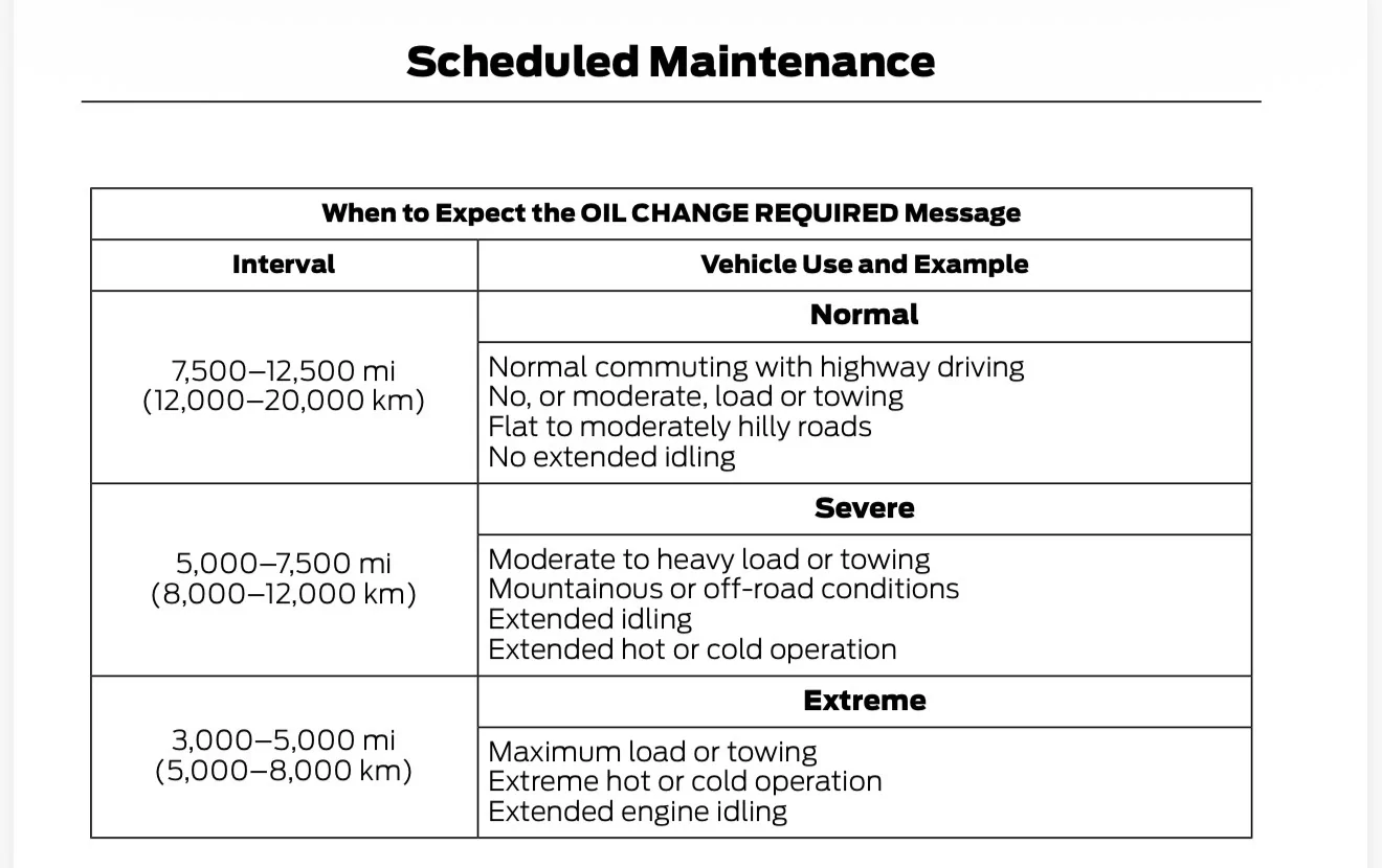

It has been about 800 miles since my break-in oil change @900 miles.
My OLM is showing 55% today…
I did my break-in oil change early 9/25 - just about 6 months ago.
A couple dozen 100+ degree days, many short trips, and only a few Italian Tune Ups make me an “extreme” user.
So it makes sense my OLM is 55% after only 800 miles. Will be down to 0% before I drive 1600! I’ll actually be changing it sooner than that because I suspect oil dilution. Will be sending oil samples off for evaluation soon. I always enjoy/learn from your post btw - thanks:)

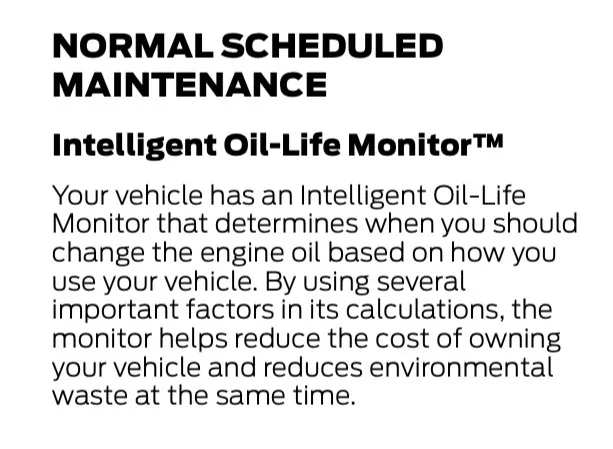

Yep, changed the reset to 100% via the Maverick’s on board menu - I’m not connected to Ford App. Also, logged in my oil change into my Maintenance Records on the Ford Website.
Have watched the OLM % decline as the miles have rolled by. It is a nifty system in my opinion!
I believe it is much more complex & useful than a calendar only based system - even though an accurate calendar based system would show the same OLM (55%) after almost 6 months as my current OLM states.
I imagine there are many folks 5.5 months into new oil that show higher % than my Maverick’s 55% - even with more miles than my 800:)

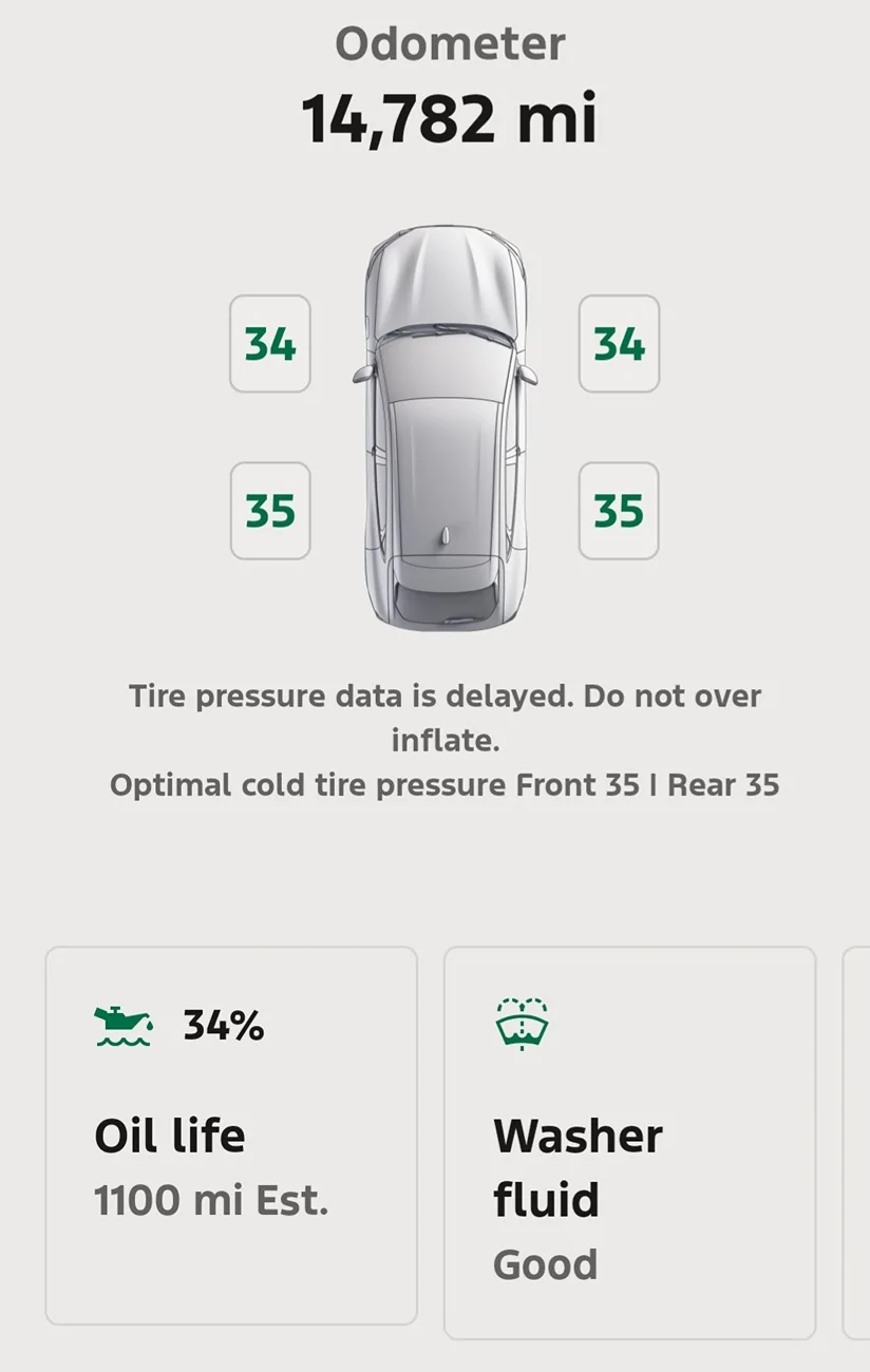

Interesting.
I just did oil/filter last Fri - OLM 1% in truck, 2% in app.
Made it 11112.
Fillup on Sun - so I always log the OLM% and miles remaining.
So those 2 days was very little city driving on Sat, all highway on Sun. 96 miles total after change.
Ford App/truck at 100% OLR - estimated 5500 miles remaining in app.
It appears to think if I keep this driving up, meaning almost total ICE (some EV in there) - I'll be allowed 5500 miles.
I know that will increase.
Hmmmm - mighty close to 5k miles there.
Even that 11K had almost 3K highway miles on trip to NY and back. But pretty gentle.

Curious - how many months before you hit 1%?
Estimated miles to next oil change is a neat feature. I don’t think I get that - being unconnected to the App…

1st change was time based - as I hit 1 year exactly since activated (by dealership after received), before I got near 10K - only 9221. (I did break-in change at 1600, didn't reset OLM)
This time 10 months (minus 5 days) for that 11K - totally because of the long highway speed trip.
The app on this 2nd OLM countdown totally changed how it estimated remaining distance, and gave no service date estimate like 1st OLM countdown did.
