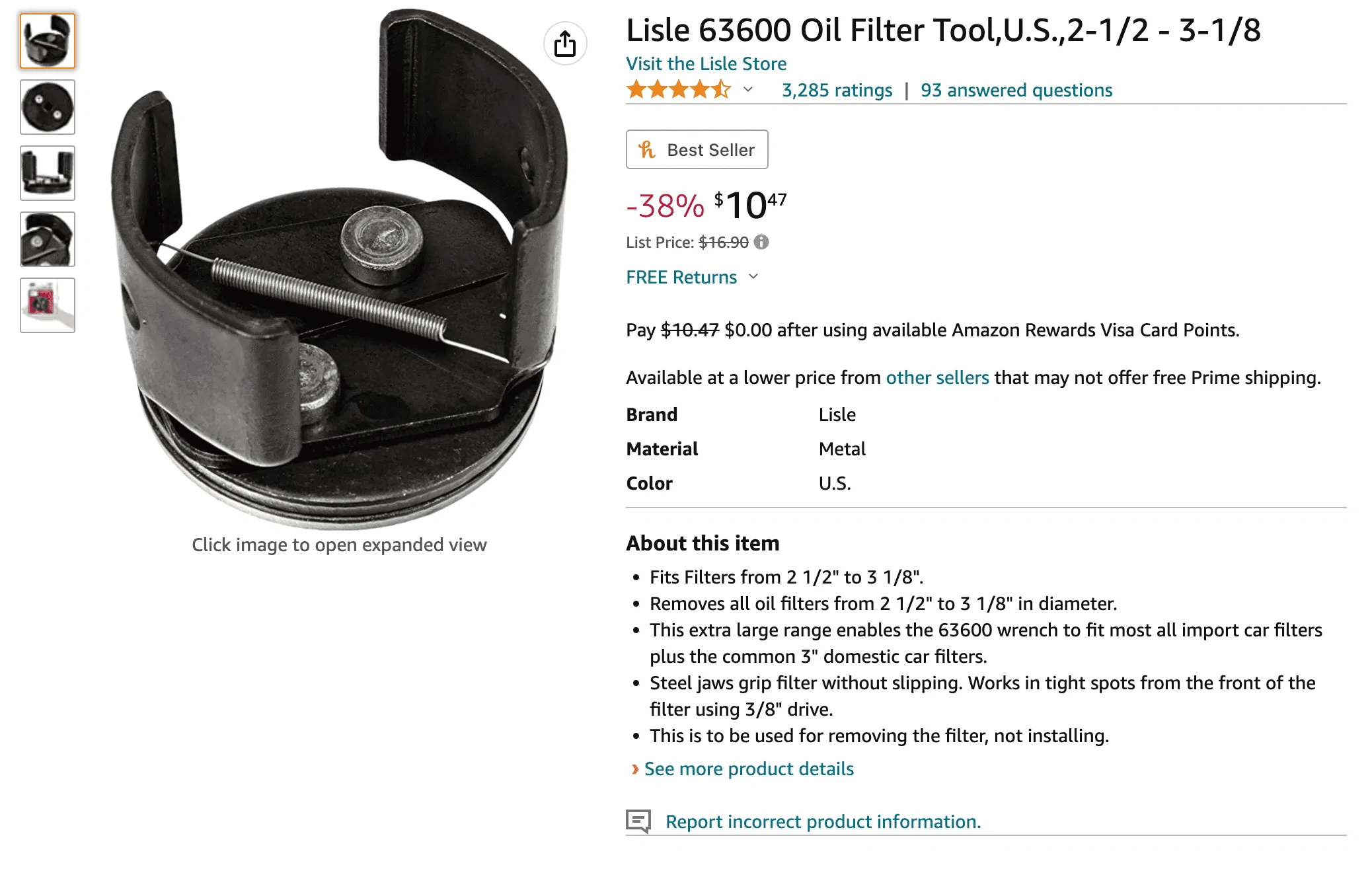

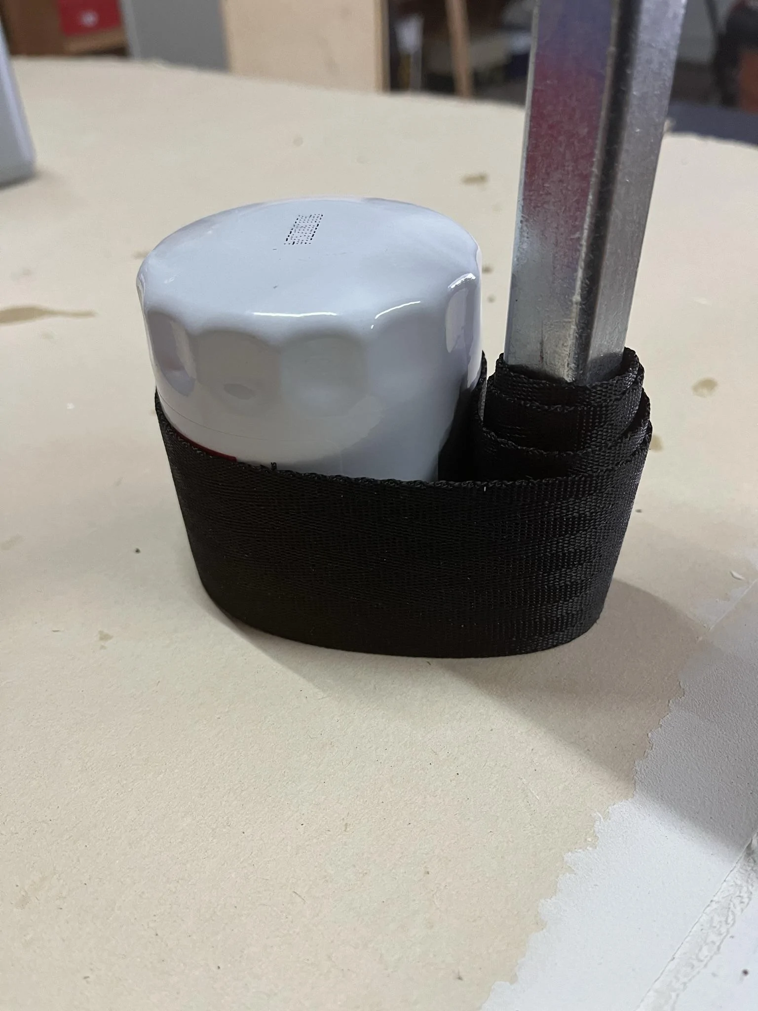

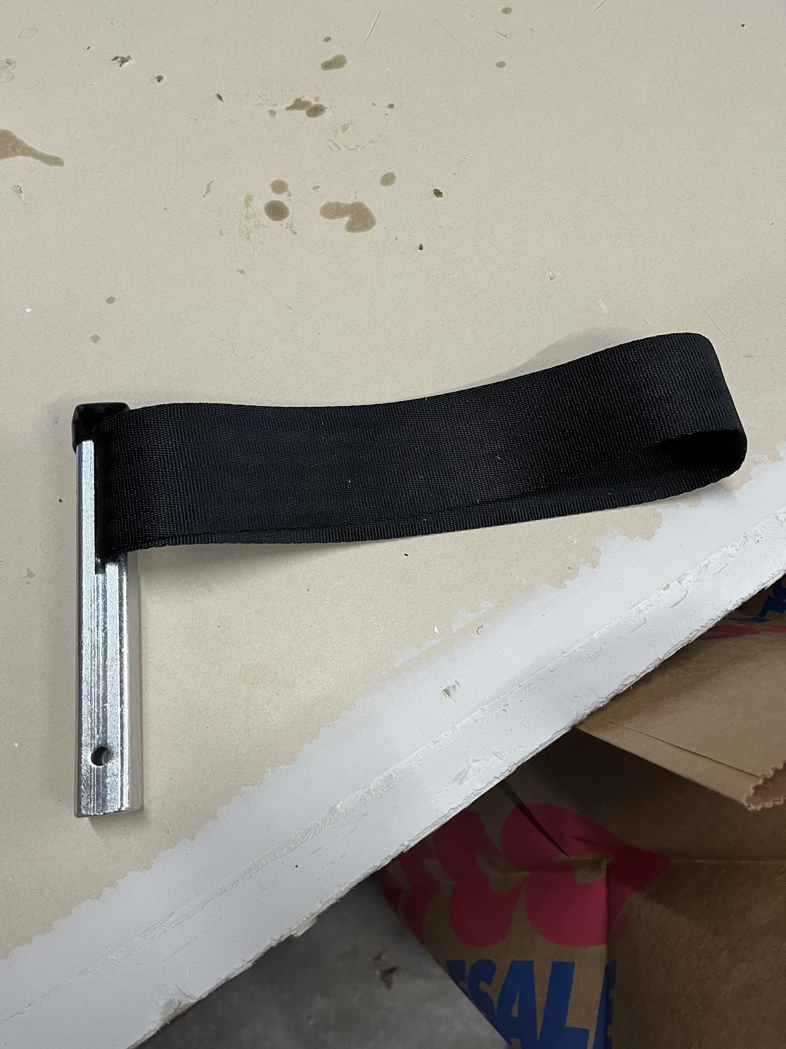

After reading reports here about the oil filter being torqued on pretty tight from the factory and no room for a standard filter wrench, I looked around and picked up one of these:
https://www.amazon.com/dp/B0002SR4MM
For 6 bucks this took the filter off with no issue what so ever. Having used standard filter wrenches and cups in the past this worked better than any. Since it operates straight up and down you can use it in very tight filter spaces. Note you will need a 1/2" drive to use.

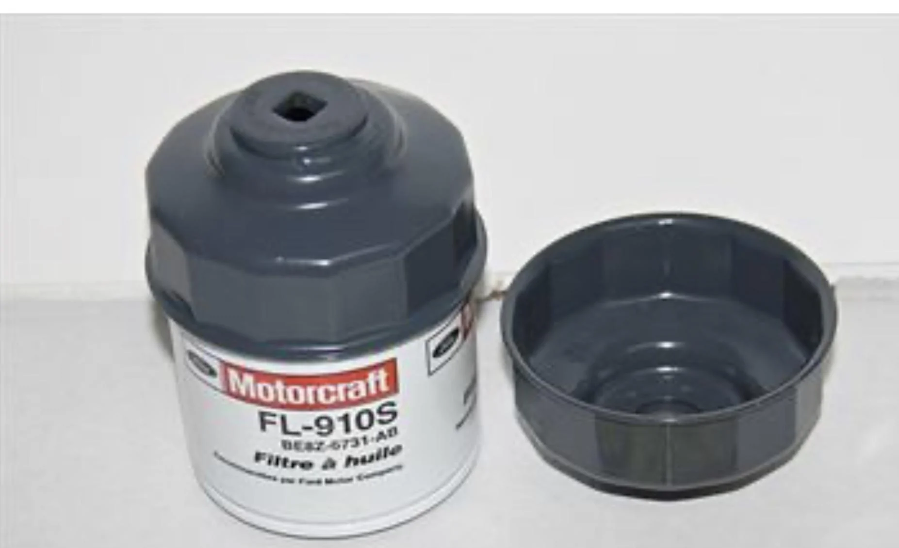

There was a video posted around here a while ago, where the guy tried the socket and it didn't fit on the smaller factory filler.
If the factory as-sold filter really is smaller than the recommended 910S replacement (though I'm skeptical), wrap a few layers of duct tape around the bottom edge, bang on the socket and remove it. Or insert a piece of old inner tube (cut open to thin it out) in the socket, bang it on and remove it. Lot's of ways to make a socket fit a filter especially if it is a one time proposition.
I'm not buying a throwaway contraption for a one time filter removal. I guarantee you the techs at Ford use a socket. Are we sure this guy had the right socket? There are lot's of sockets - you have to use the right one.

It's not throwaway, not sure where you got that info from. Pretty handy really, instead of buying different size sockets for all different size filters or involving duct tape and hammers in the oil change process this takes care of it.

Why do you think it is a one-time use tool? It looks like all you have to do is unwrap the strap, remove the filter, and re-use it for the next filter removal.

had one for years, never thought of throwing it away :ROFLMAO: not that dumb
cars, trucks, pretty much anything with a spin on filter. used it the other day to replace a water filter cartridge in an awkward place.
