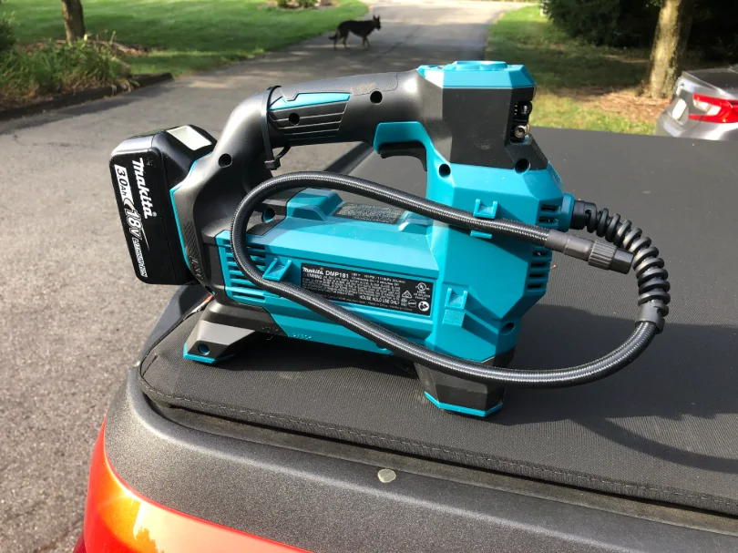

I have wondered though if higher end portable inflators have reached that level of accuracy (the first one I tried was off by 2-3 psi), so you can inflate and set the pressure in one step.
My Makita is off by 5 psi, but it is "accurate" as far as being consistent, so I can easily adjust for it. I set it to 30, and it's 35 every time on my jaco.
