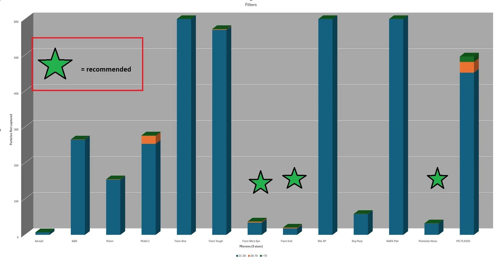

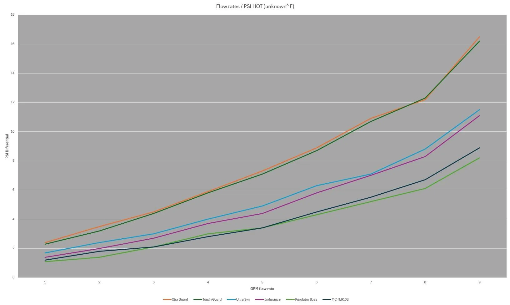

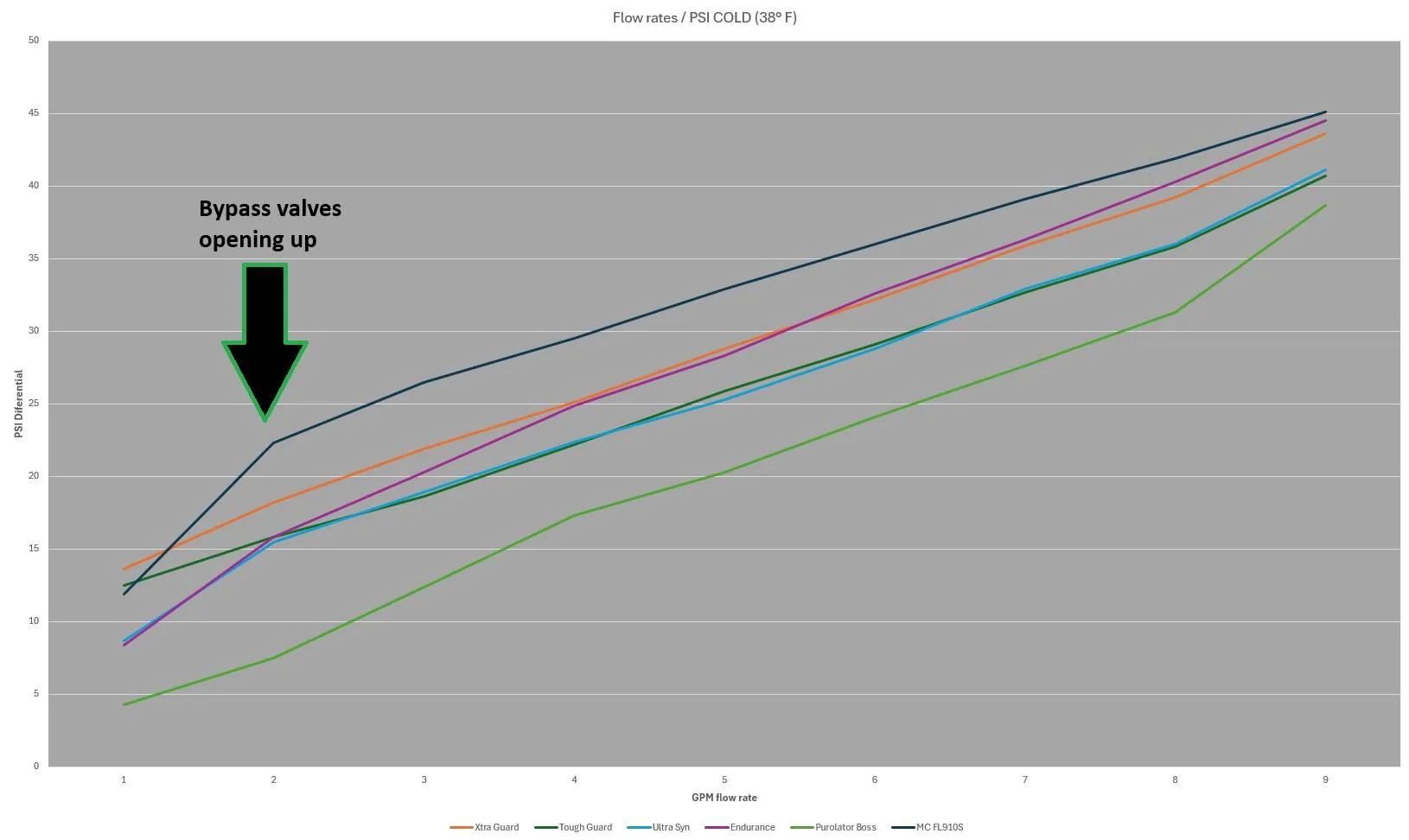

So I did some digging, turns out there is a fantastic fairly new Youtube channel testing oil filters using some pretty good criteria, Brand Ranks. This compared numerous higher and low end filters along with our beloved Motorcraft FL910S filter.
What I noticed, is that when oil is cold, the bypass valve is going to open at much lower flow rates. These are charts of flow rates vs PSI, keep in mind the top Frams and Purolator have synthetic media which apparently gives them a much better filtering efficiency flow rate vs the cheaper cellulose media of the lower end Frams (and I believe Motorcraft FL910S):
Ford Maverick Taller (Higher Capacity) Oil Filters, revisited cold
Ford Maverick Taller (Higher Capacity) Oil Filters, revisited hot
Now for filtration ability (this is striking, the lower end Frams are off the chart):
Ford Maverick Taller (Higher Capacity) Oil Filters, revisited particle count

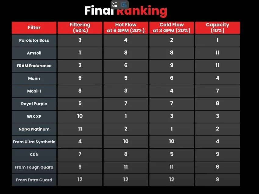

So, combining filtration ability and efficiency at higher PSI settings, it looks like some winners are:
Here is a good overall summary, and you can pick which qualities are important to you:
Ford Maverick Taller (Higher Capacity) Oil Filters, revisited summary
