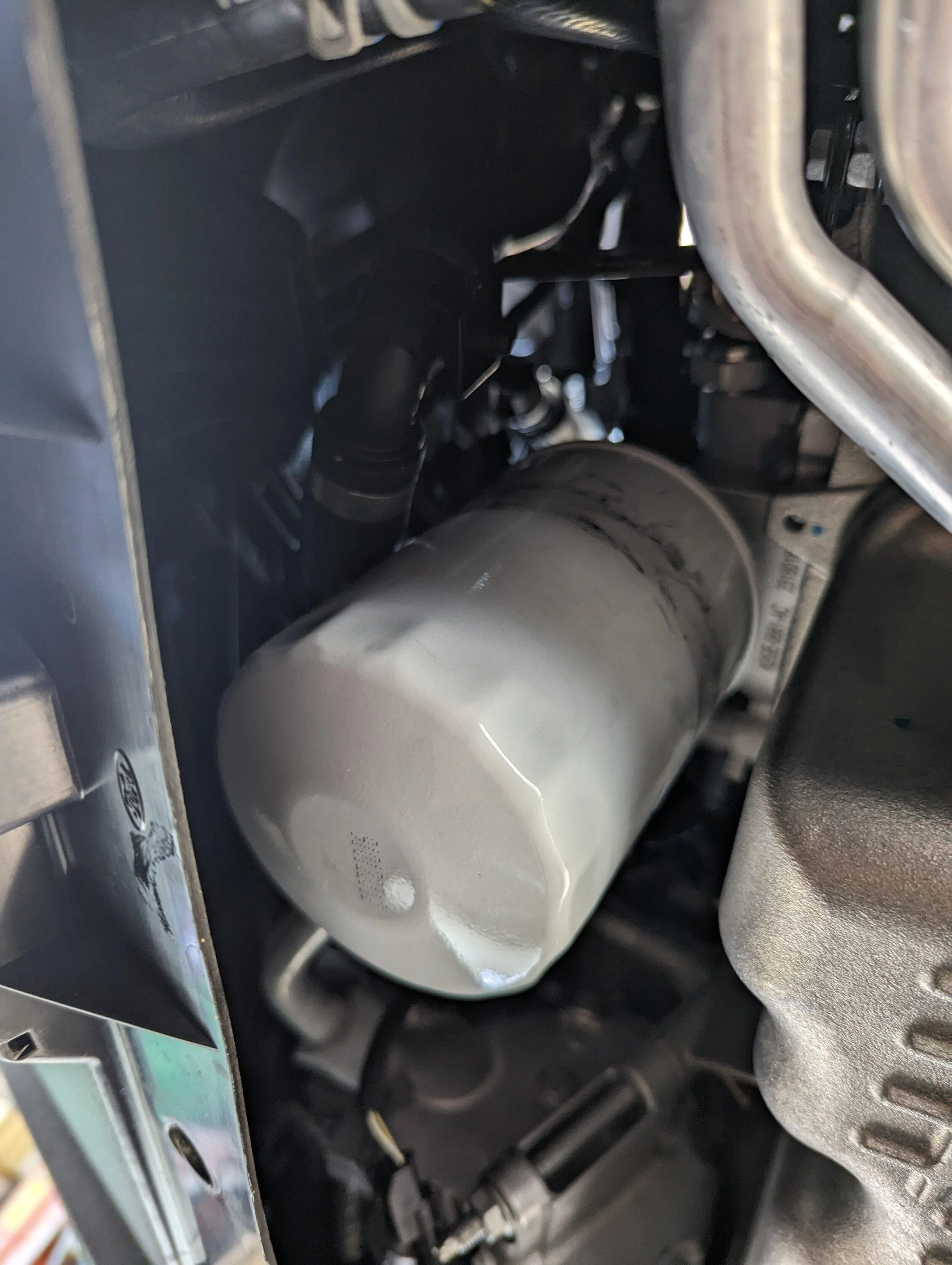

I can confirm that all of these filter will fit on my 2024 lariat tremor. The largest ones come into contact with a coolant hose but that should be fine. Gaskets all fit the mating surface the same.
PBL30001 and 6qt fill:

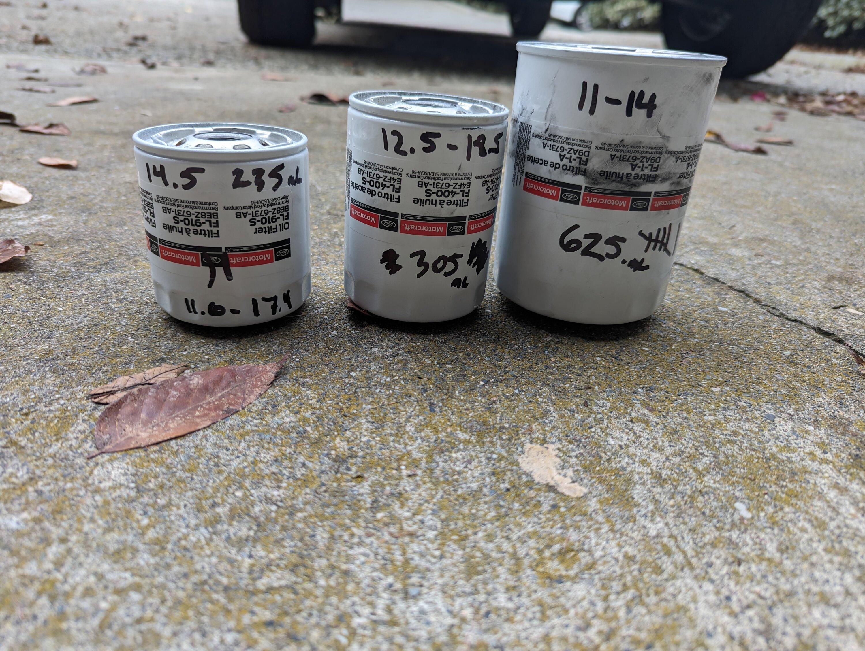

The OEM filter is the FL-910s
I considered FL-910s, FL-400s, FL-1A and their corresponding Purolator Boss parts: PBL10241, PBL20195, PBL30001
Purolator and motorcraft both publish bypass pressure range. I found the motorcraft info on bitog. https://bobistheoilguy.com/forums/threads/motorcraft-specs.26939/
Here is the info I found (lowest volume first)
FL910s:
RVOP Setting PSI 11.6-17.4
Free volume: 235ml
PBL10241:
RVOP Setting PSI 12-15
FL400s
RVOP Setting PSI 12.5-18.5
Free volume: 305ml
PBL20195:
FL1A:
RVOP Setting PSI 11-14
Free volume: 625ml
PBL30001:
RVOP Setting PSI 8-16

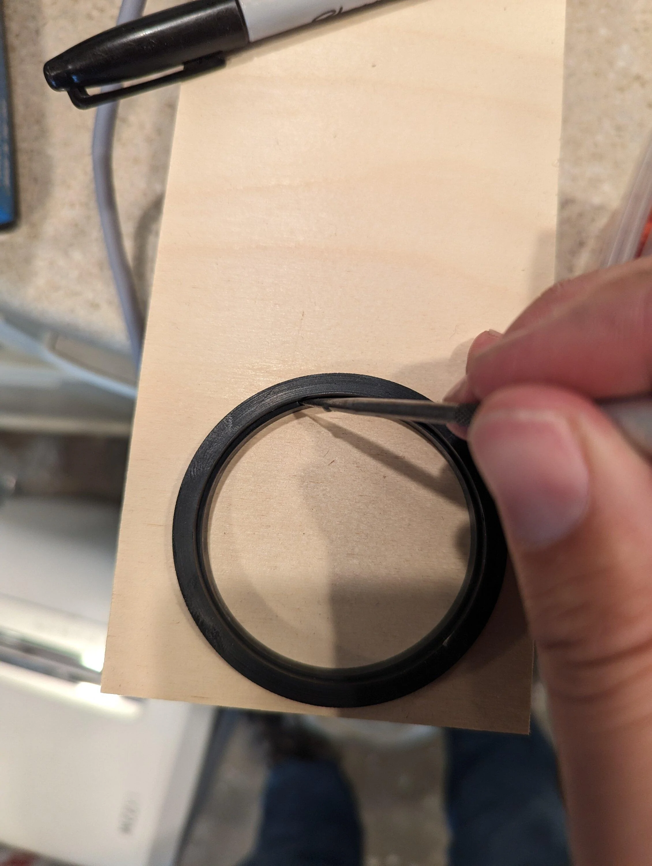

I measured the free volume of the motorcraft filters like so:
Measure 100ml water
Slowly pour water into the center tube until it reaches the top
Wait 5 minutes for filter media to soak
Using a pick, poke open the antidrainback valve to release any stuck air
Note whether the water level in the center tube has gone down.
If so, repeat.
Stop when more water can be added without overflowing into the gasket groove.
Why did I bother doing this?
Mostly to see if they would fit
Why do I care about 6qt vs 5.5qt?
Just for convenience. I'd rather not waste or hold on to a half-full bottle.
Why didn't I just measure the volume using displacement?
Canister exterior volume isn't the same as free volume due to the internal media and components.
Why didn't I measure the volume of the Purolators?
After I proved that the FL-1A would fit I knew I was going to use one of the two larger boss filters. So I tested the motorcraft ones, and kept the boss as a backup.
I'll measure them next time maybe.

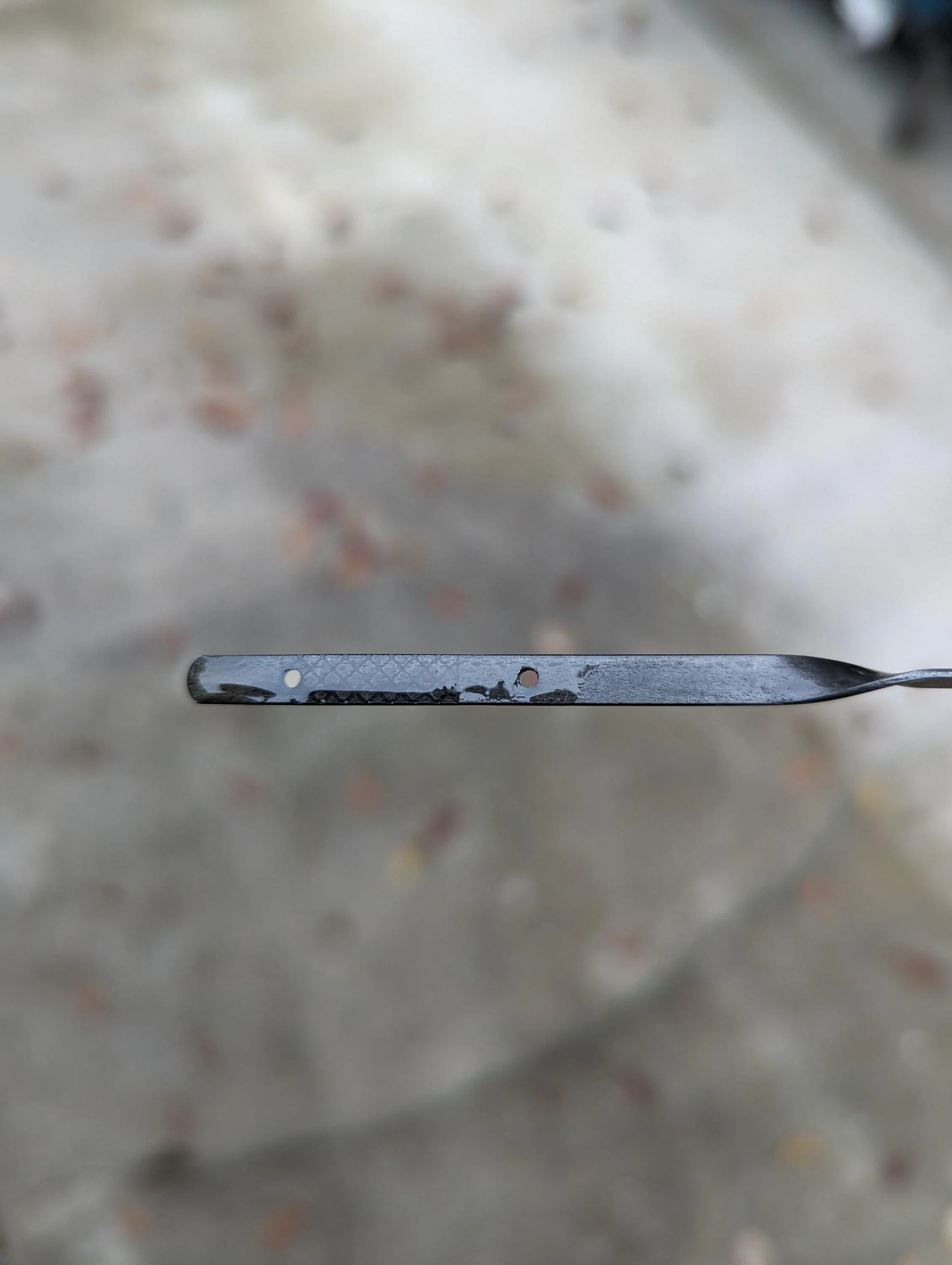

Have you change your oil yet? How you feel about FE8A so far? Did you fill exactly at 6 qts?
Your picture looks like overfilled if you fill at 6qt.
Ford Maverick Comparison of various larger oil filters 1754588043325-rh
I thought we want it at B level.
Ford Maverick Comparison of various larger oil filters 1754588075876-ni
When I change oil, I usually fill the up to 95% of the oil volume capacity, and run the car to operating temperature, then slowly fill to meet the Nominal line. I may consider to try FE8A, I like the fact that it's bigger filter and have the same bypass PSI settings with OEM filter.

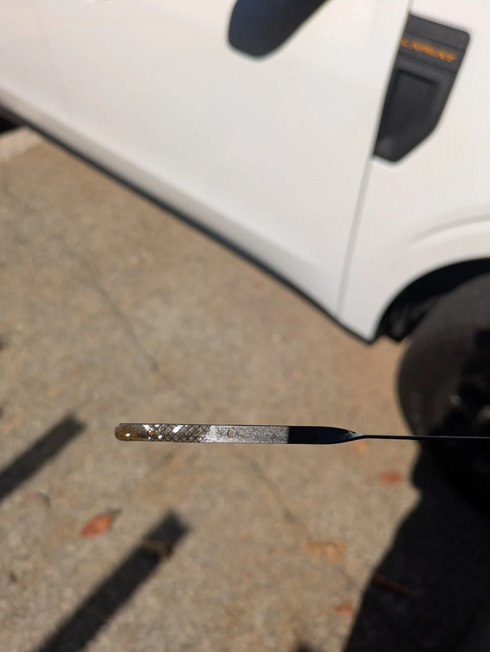

Just did an oil change yesterday, here's the stick:

That’s too low, needs another 3/4 litre! J/K, looks good to me.
FL910s:
Free volume: 235ml
PBL10241:
FL400s
Free volume: 305ml
PBL20195:
FL1A:
Free volume: 625ml
PBL30001:
