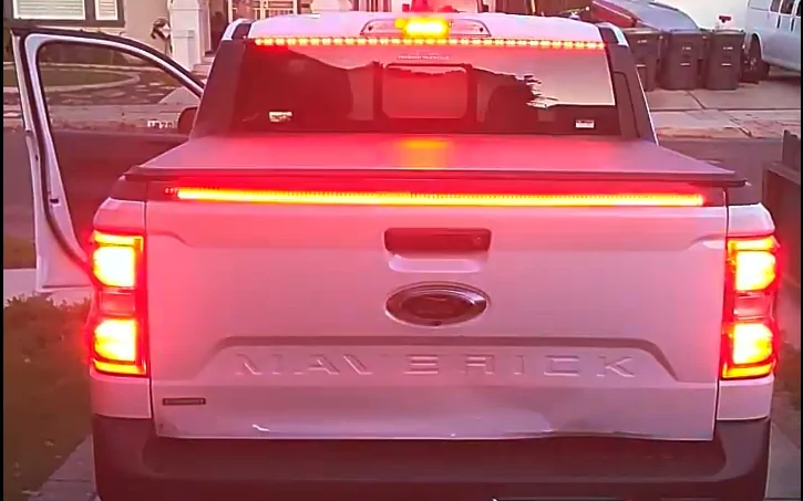

B.R.E. (Before Rear-Ended) I ran the extra strip along the bottom edge of my tailgate, others have run it under, along the back edge of the bed. Now mine is along the bottom edge of the tail gate cap, right up, in their face. I had almost 3,000 miles B.R.E., and now have 15,000 A.R.E. for a total of 18,000. Oh, and also along the top edge of the rear window.
Ford Maverick Tailgate lights recommendation? 1778650794727-38
https://amazon.com/dp/B07VSHB4Z8
https://amazon.com/dp/B003AT2W54
https://amazon.com/dp/B0BNCNP1D1
I don't do things the easy way, so mine are tapped into the front turn signals and the Center-High-Mount Stop light for redundancy (separate circuits).

So, this doesn't interfere with tailgate operation? I'd be curious as to how you ran your wires without pinching or obstruction.
I see that you incorporated a flashing module. Did you do this for the light strip or just the 3rd brake light on the cab? Many states have a problem with flashing brake lights for the main lights. If just for the cab light, they make a flashing bulb to replace the OEM . . . no module needed. Obviously, I'm guessing about your arrangement and would welcome any direction.
My add-on wiring follows the rest of the factory wiring, out of the hole in the bottom of the tailgate. The pulse module is currently wired after the C.H.M.S. bulb and only runs the LED strips. When I drop the headliner down to add t-slots to the roof I will wire it in before it. I had one of those pulse 921 bulbs. My OCD didn't like the different pulse rate, even though I don't follow myself to see it:)
