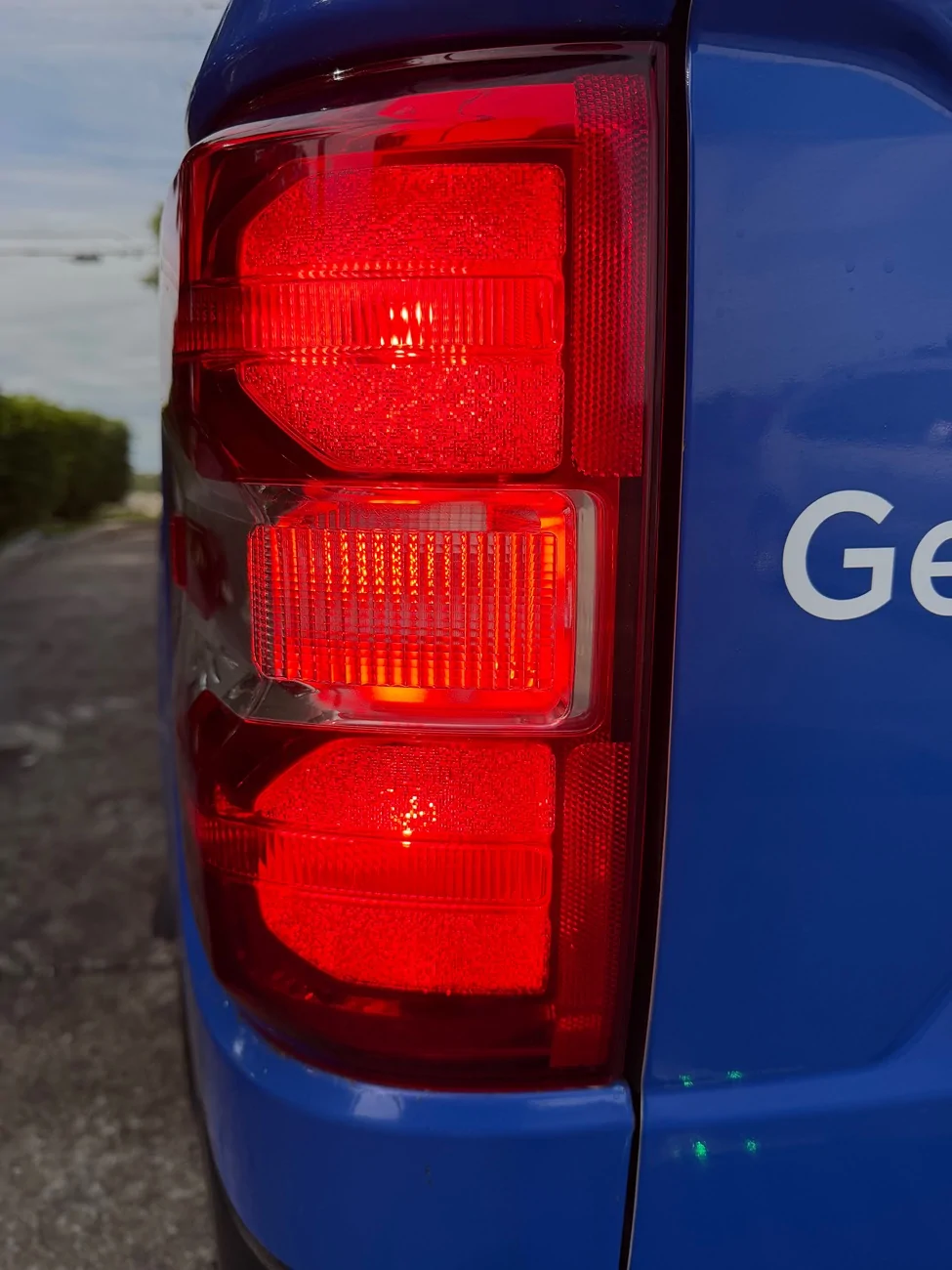

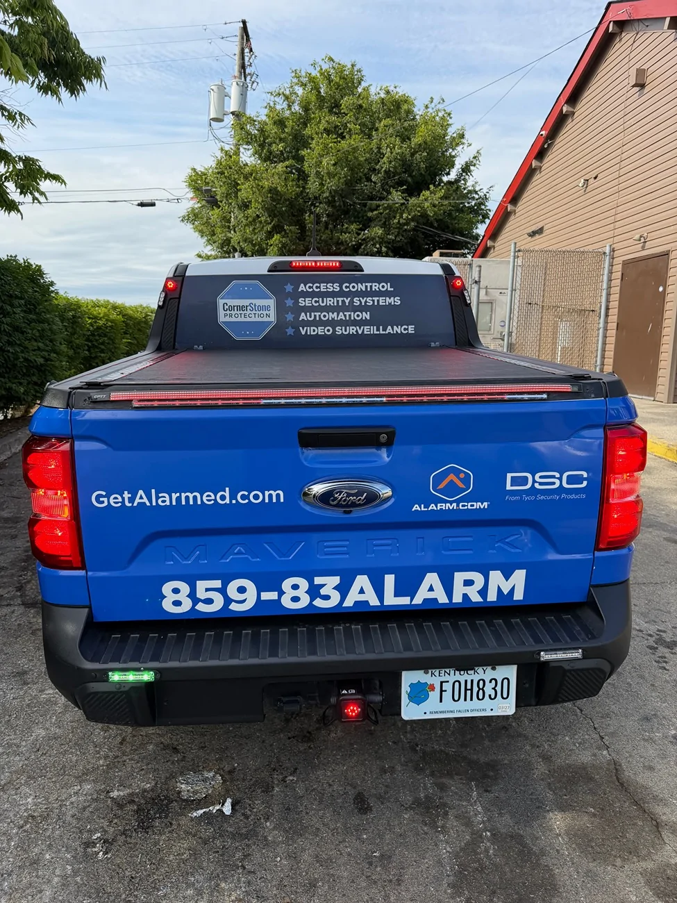

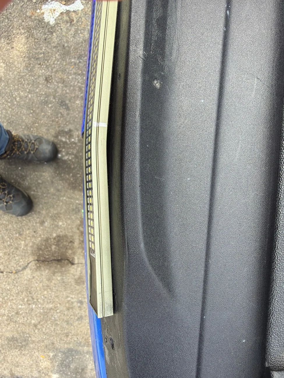

I put the 48” OPT 7 on the top of the tailgate. DONT HOOK IT TO THE 4 PIN as it will cause all kinds of issues. Opt 7 made a power adaptor to repower it, it has been discontinued. The curt one looks the same function. I ran some 6 wire cable from the tailgate to the area behind the back seat. You can tap all the wires you need there as the harness that feeds the brake lights is right there. Also the opt 7 is solid aluminum with a silicone filler. I bent mine to fit the curve of the tailgate. Mounted with 3M tape. Use an adhesive promoter when bonding to the plastic trim and it’s stuck . Changed my reverse lights to feniex cannons so there red on brake and flashing white strobe on reverse . Also does amber/white strobe. Changed my 3rd brake light out to feniex wide strobes for brake , strobe function . Added a couple of feniex cannons for the break and area light for night work
