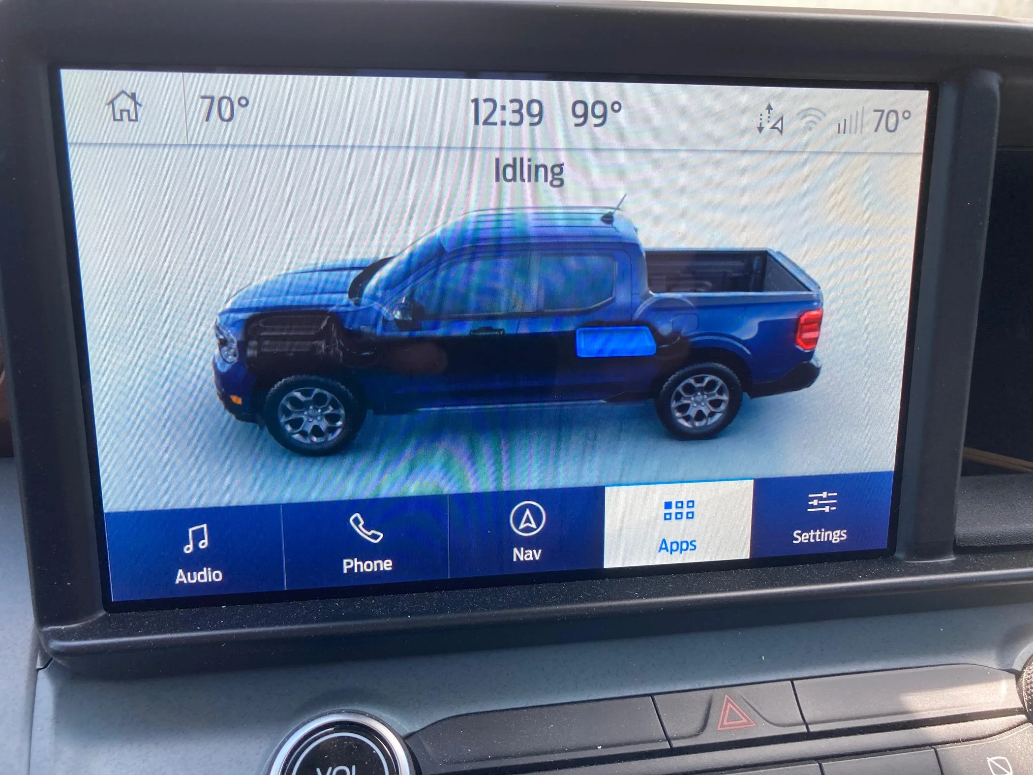

Can you confirm that your power flow screen works still or is it blank like the picture I posted?
I looked under settings and couldn’t find power flow listed. Is it up under something else?
This is interesting. I had the 2 recalls done last month without any issues. Last week, while I was driving my passenger was trying to navigate on the screen, we came upon this power-flow screen which I had never seen before. (We are both not very tech-strong) This power flow screen is a different representation of the information of the "EV Coach " screen. The latter being more helpful in actual driving anticipating using the throttle most effectively. The Power Flow does not help you here. I was really very pleased with Mav during my first encounter with HEAT in this vehicle. It has the best A/C I have had in any car. Additionally the ENGINE (ICE), only idles when necessary to keep the batteries charged. I was not anticipating this money and environment saving feature when I bought the truck :)

Hold the radio power and track skip forward at the same time to reboot the unit, see if that brings it back
YES no problems power flow is working great
